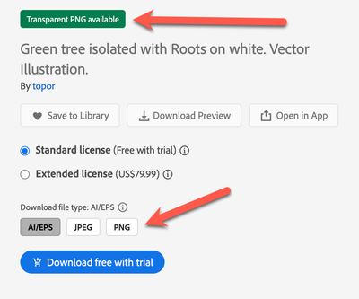

Please be aware that only some vector files have transparency, and there is a filter for searching these images. Most vector files must be edited after you download them, including removing a background.
Vectors that have transparency will have a green banner saying "Transparent PNG available" and there will be a PNG download option. If this banner is missing or if the only download options are AI and JPEG, then you must manually remove the background yourself.
You can save yourself time by using the Search filter for transparent images.
