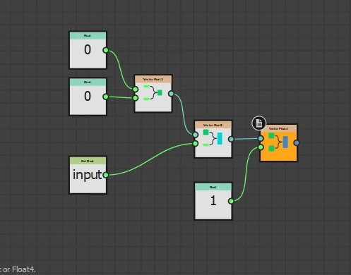

I'm trying to expose the value parameter (lightness) as a float1 from a color node that is represented as a float4. as you see, I attempted to break down the color node into vector float nodes , but it didn't work as I expected. Can you please help me with this issue?
Correct answer davescm
I hadn't spotted that, I should have tested better 😞
It would appear that the node works in RGBA when driven by a function, even when set to Float and HSV before adding the function.
So the function graph needs to be as below to give your required output.
Dave

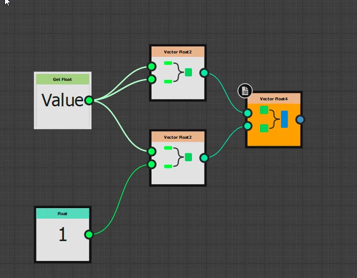

Like this ?
I added an input to the graph which I labelled Value then used a Get Float to get that value and then two Vector Float 2 nodes and a Vector Float 4 to combine it with the other fixed Float values
SBS also attached
Dave
