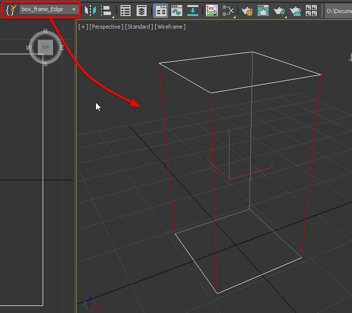

The selection set in 3ds Max, note one of the vertical edges is not included in the set.

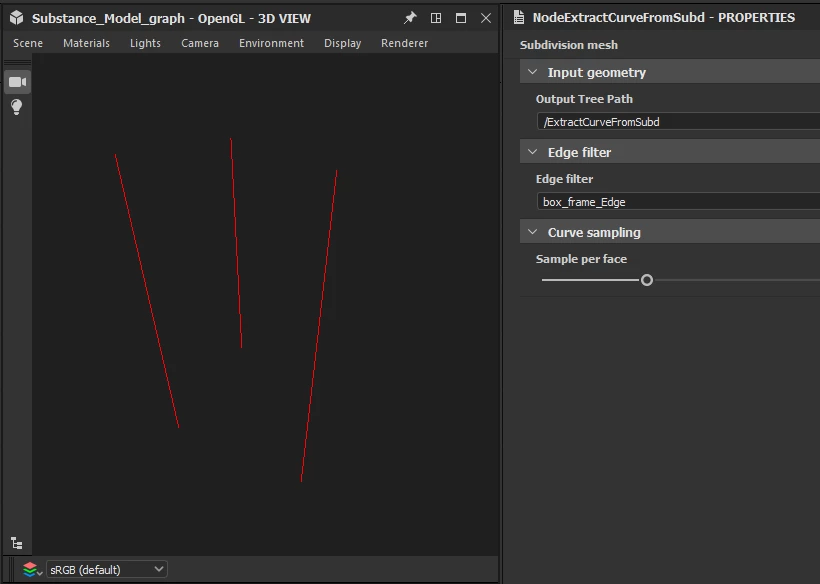

The same edges are correctly extracted using this selection set tag in Substance 3D Designer, with the Extract curves node.
