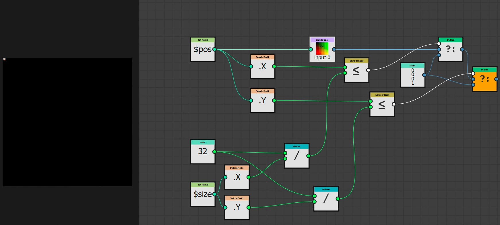

The pixel processor works by taking each pixel in turn and processing it using the function that you set. So to get the first 32 pixels X and 32 Y from an image and turn the remainder black you don't need a loop at all. Example below:

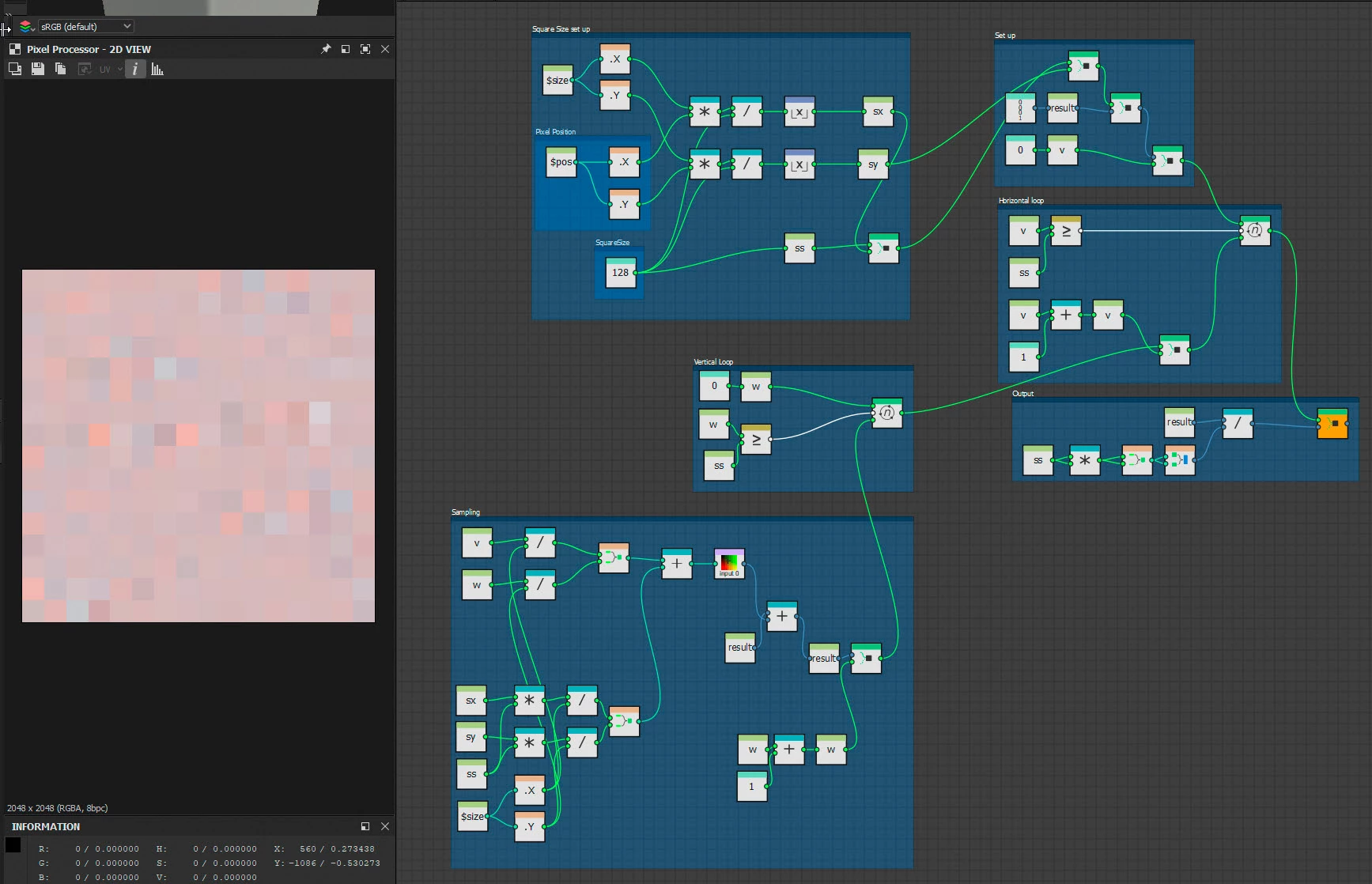

Where you might want to use a loop is to take an average of pixels at a certain point. So the example below divides the image into squares of 128x128 pixels, with each square having the average value of the pixels in that square. It does that by calculating which square the current pixel being processed falls under then samples all the pixels in that square (using two loops) and outputs the average value
The main principle when passing values into or out of a loop is to use Set nodes to set the variables to be passed, then Get nodes to read those variable that have been passed in/out of the loops. In addition use sequence nodes to make sure that the operations happen in the right order, e.g. loop a runs before loop b or the final result that is output from the function graph is the final value of that variable and not an earlier value.
