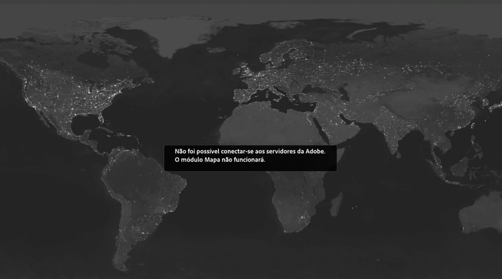

P: (Europe) Map Module not showing a Map
Hallo,
trotz aktueller Version 14.2 funktioniert bei mir in LightroomClassic seit mehreren Tagen das Kartenmodul nicht. Ich bitte um Hilfe bzw. Aufklärung!

​@hans_onepicture Whether the map display works or not could depend on the username (user) in the Windows account. My Windows username contains an umlaut ("ü").
Excellent discovery! I tested 8 diacritical marks and 1 ligature in Windows account usernames, and some worked and some didn’t. This explains why the bug reports mostly came from the same European countries, with a few from South America and other countries.
So the workaround is to create a username without any diacritical marks.
Looking at the Unicode representations, all of the problem-causing diacritical marks have code points starting with U+00, while the non-problematic marks and ligatures don’t:
It’s pretty clear that some software component invoked by the Map module has a bug in its handling of Unicode strings. Given that similar bugs haven’t cropped up in other parts of LR, this strongly suggests the problem is somewhere in the third-party components such as the Google Maps JSON library.  I think that library caches map data in hidden folders inside C:\Users\<username>\AppData, and the caching could be getting tripped up by the bug in the Unicode handling.
As of some months ago, Adobe hadn’t updated that component -- it was many years out-of-date.  And the engineer who originally wrote that part of LR is likely long gone from the team.
Tested on LR 16.0 / Windows 11 running in the US region with US English.
