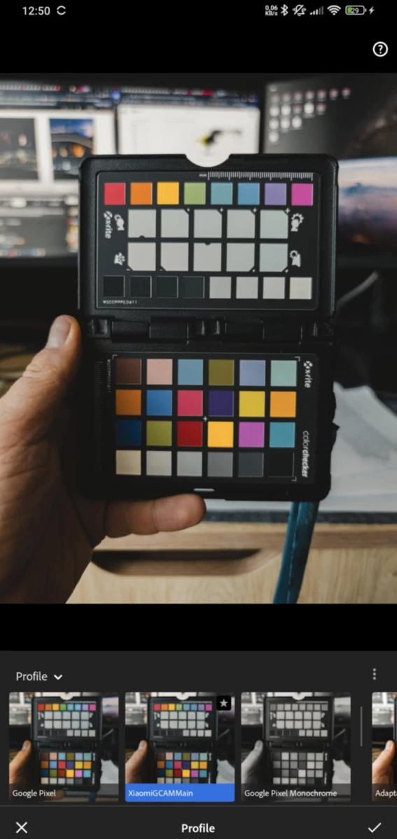

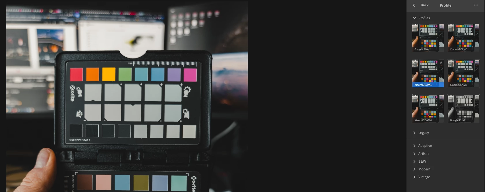

I have created custom camera profiles for my Xiaomi (and had many issues related to it described here: https://community.adobe.com/t5/lightroom-ecosystem-cloud-based-discussions/issue-with-managing-camera-profiles/td-p/15326673 ). One issue that I have is that these custom profiles are either not available on the second device, or they have so big lag in sync, that I cannot tell the difference. Profiles were created more than 2 days ago, and after that many pictures were sync between devices).
Profiles in the PC version:
and same picture on the mobile:
September 21, 2024
