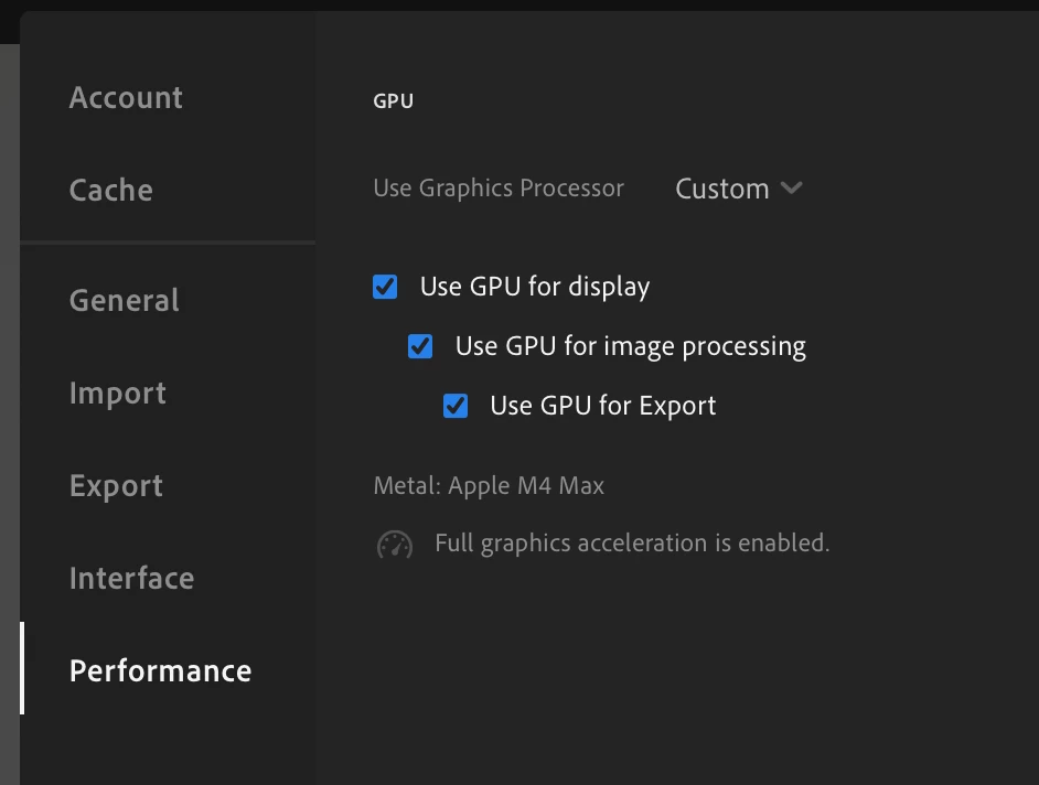

A quick update for those of you following this thread.
After some investigation, we’ve been able to reproduce this issue by manually deactivating “Use GPU for Export” in performance preferences when exporting from Local. This suggests an issue with how we are using the GPU or how the OS is managing GPU access in some scenarios. We appreciate your patience as we continue our investigation and develop a solution to this issue as soon as possible.
In the meantime, if you are experiencing this issue, we suggest trying following:
  • Verify that you graphic drivers are up to date
  • Verify that your power settings are not limiting your resources
  • Verify that your Lightroom performance preferences are set to maximize performance
  • Try changing your GPU from Auto to Custom with all checkboxes ON. This may force GPU export usage in situations where it might otherwise not be used.
If you find any of these steps resolve the issue, please share your experience here. If that does not improve things for you, you can DM me your system specs (available from the LrD Help menu) and an example of a file that failed to export.
We know there is nothing more enraging than losing work. Thanks again for your help and patience as we resolve this issue.
- Jason

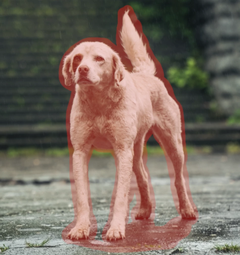

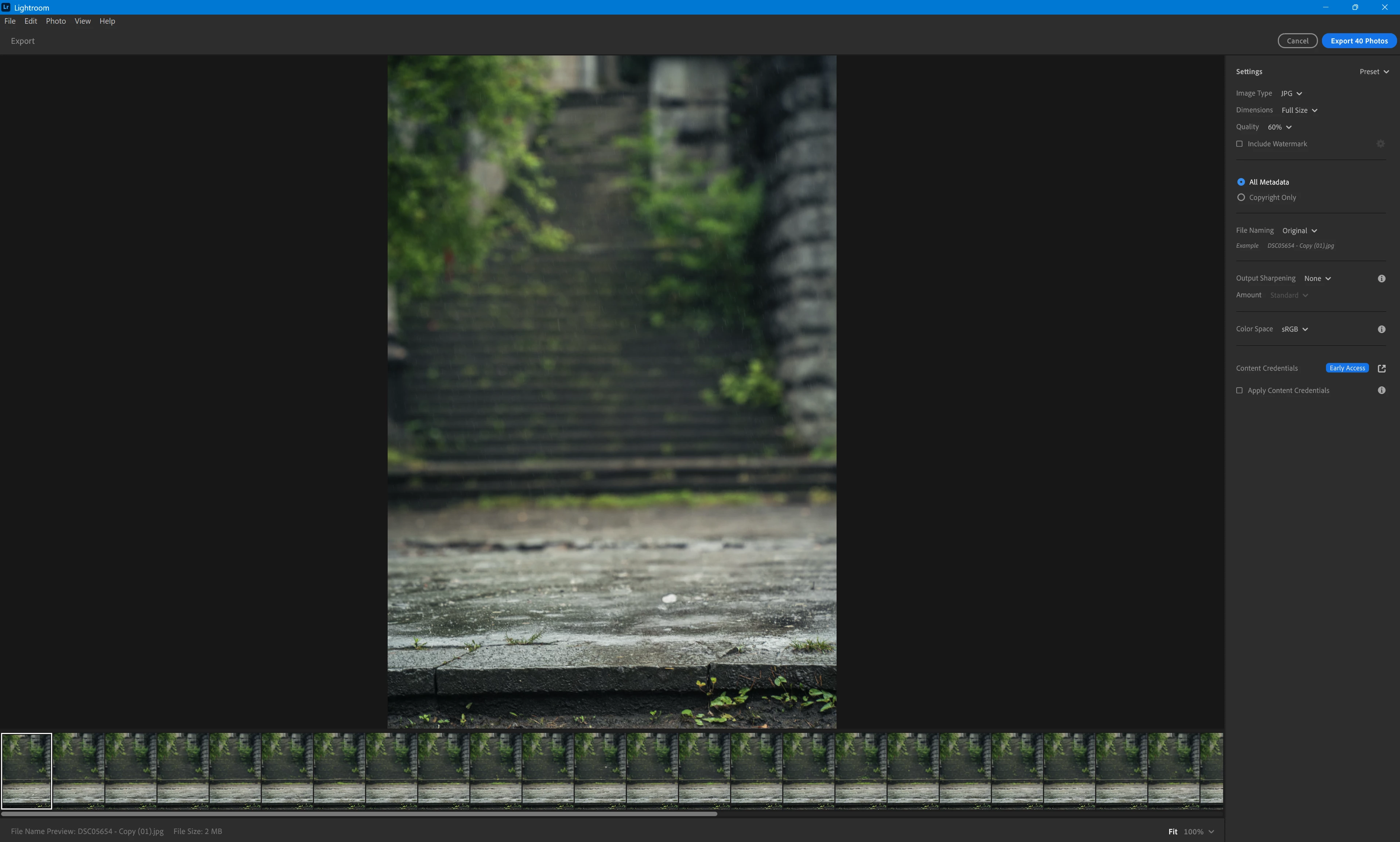

Lightroom version: 8.3.1 x64 [ 20250505-2344-4fb7147 ] (May 5 2025)
Operating system: Windows 11
When I export my photos, sometimes edits I've made with the generative remove tool aren't applied to the exported JPEGs.
Steps to reproduce:
1) Open local folder containing a couple dozen photos in Lightroom
(In the below example I have copied+pasted this photo of a dog 40 times for illustrative purposes)
2) Use the remove tool, with "Use generative AI" checked, to remove one or more subjects from each photo.
3) Select all the photos and export
Image Type: JPG
Dimensions: Full Size
Quality: 60%
All Metadata
File naming: Original
Output Sharpening: None
Color SPace: sRGB
Expected Result:
The subjects which were removed using the remove tool will not appear in any of the exported JPEGs
Actual Result:

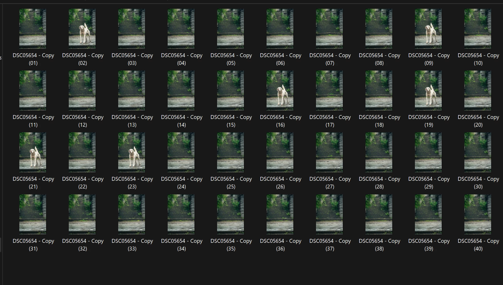

In many of the photos, the subjects which were removed using the remove tool still appear.
As shown below, in most of the 40 exported JPEGs Geoff the dog has successfully been removed, but in half a dozen of them he has reappeared.
NOTE: Other edits made to the photo, including colour corrections and non-AI removes, seem to export just fine. The issue appears to be limited to just the AI remove tool.
As one can imagine, when I come back from a trip and spend many hours meticulously removing inconvenient people from the background of photos I've taken or specs of dust that landed on my lens, only to find that in many of the photos I've exported those edits have come undone, it is very very frustrating.
