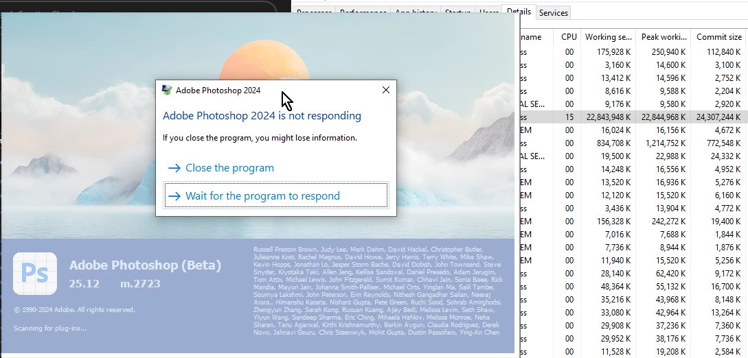

Aug 7, 2024 4:38 AM UTC
Thank you very much! Removing Betasdid the trick. Photoshop is working again!

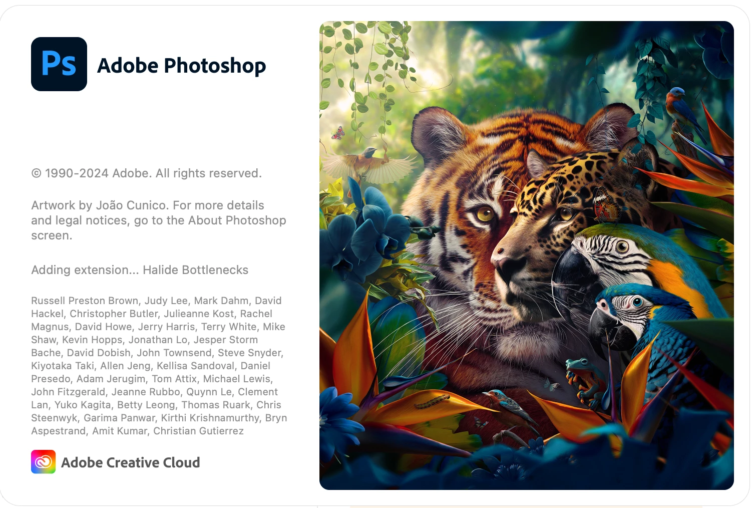

Aug 7, 2024 1:29 AM UTC
I'm on a Mac Studio M1 max,
The issue has happened on os 14.5, and has now happenened on os 14.6
I ran into an issue today that I cannot seem to fix where photoshop will not open for me. I'll try to lay out everything that is happening and what I've tried to do in order to remedy the issue below.
Scenario - While I was working, I went over to chrome and tried to drag an image from chrome directly into photoshop 24. I have done this countless times before and I have not once had an issue. Photoshop was not open at the time.
Issue - photoshop acted like it was opening by showing the splash screen, the text even changed as if it were loading and the photoshop icon was bouncing in my dock. But then nothing happens - its just stuck there. I can force quit the program and try to open it again, but the same thing happens. (I'll attach a screenshot of where the splash screen freezes)
Attempts to fix: (all have failed)
1. Power cycle computer
2. Uninstall & reinstall photoshop (keeping preferences)
3. Check for Photoshop update
4. Open photoshop while holding shift and selecting not to load 3rd party plugins
5. Uninstall & reinstall photoshop (deleting preferences)
6. Update mac OS from 10.5 to 10.6
7. Boot computer in safe mode.
I would really appreciate any help on this. My other programs still work and the issue is only isolated to Photoshop. I'm sure I'm missing some details but I'll happily answer any questions in this thread.
Thank you

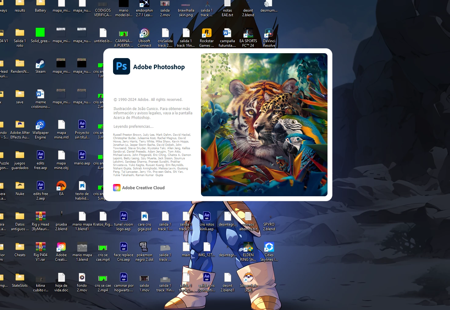

hola, yo también tengo el mismo problema que veo, varios comentan ahora. Photoshop no abre despues de haber actualizado a la 25.11. Simplemente se queda cargando en la pantalla de carga y utiliza casí toda la RAM disponible del ordenaro hasta que crashea y nunca termina de abrir. Todas las personas que he leido en el foro hoy han reportado el mismo problema y han utilizado los mismo metodos de solución que  son:
-abrir en modo administrador
-abrir desde la app de CC
-reinstalar en limpio
-reinstalar a una versión más antigua (las cuales parecen haber sido corruptas por el problema de la 25.11)
y muchas más..
encontre una solución medianamente viable que fue instalar la versión de 2021, la cual si funcionaba. Sin embargo, necesito las otras funciones por cuestiones de trabajo así como muchas personas en varios de los comentarios.
ADOBE HAGAN ALGO POR FAVOR!!!! HAY GENTE QUE NECESITA TRABAJAR CON ESTO Y NO SE PUEDE ABRIR EL APP

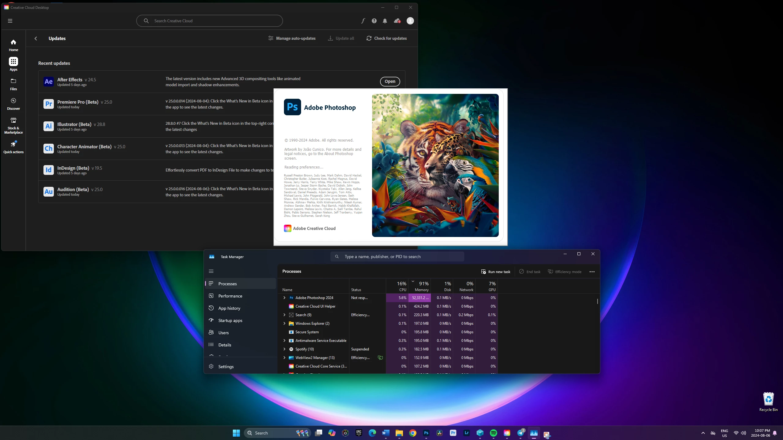

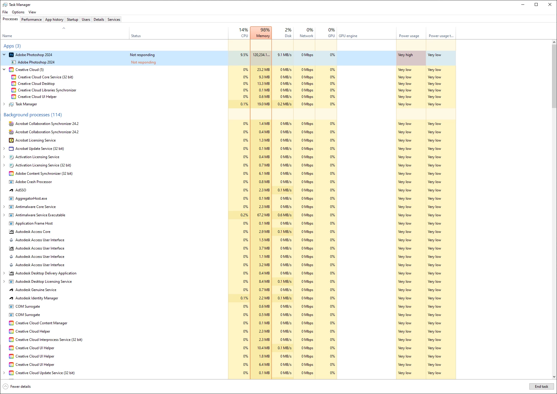

Aug 7, 2024 12:22 AM UTC
I am using the latest version of Photoshop. Photoshop stalls when opening and yet in task manager I see my system ram creep up to nearly 98 percent of usage by Photoshop.
I rencently update my BIOS because I have a i9-13900k CPU effected by Intels' cpu issues. Although I haven't had any BSOD, but it highly recommend to update the BIOS.
Now Photoshop will not start. The splash screen comes up and it hangs on "Reading Preferences".
What I have tried:
Uninstall Photosho
Cleared my CMOS
Why would Photoshop write nearly 118g to my system ram upon start up?
Any idea how to fix this?
