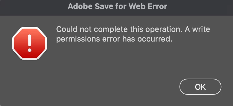

I have enabled photoshop 2021 in the systems security permissions for full disk access and the same for files and folders and accessibility, after having read some of the previous advice on here for older versions of photoshop and OS, but to no avail. An error message appears every time I try to save for web legacy - It's an animated GIF I'm trying to export. An incredibly frustrating fault that needs to be addressed soon!

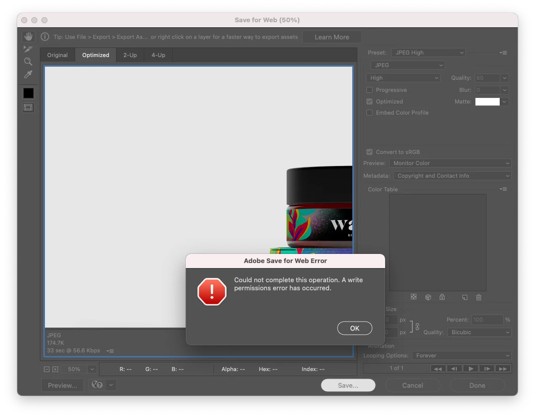

I can't use the Save for Web option for any images. I am using Mac Big Sur 11. 5.1. I have changed my privacy permissions so that Photoshop has full access but I can't get this to work. I read lots of similar issues and tried their fixes but the error persists.

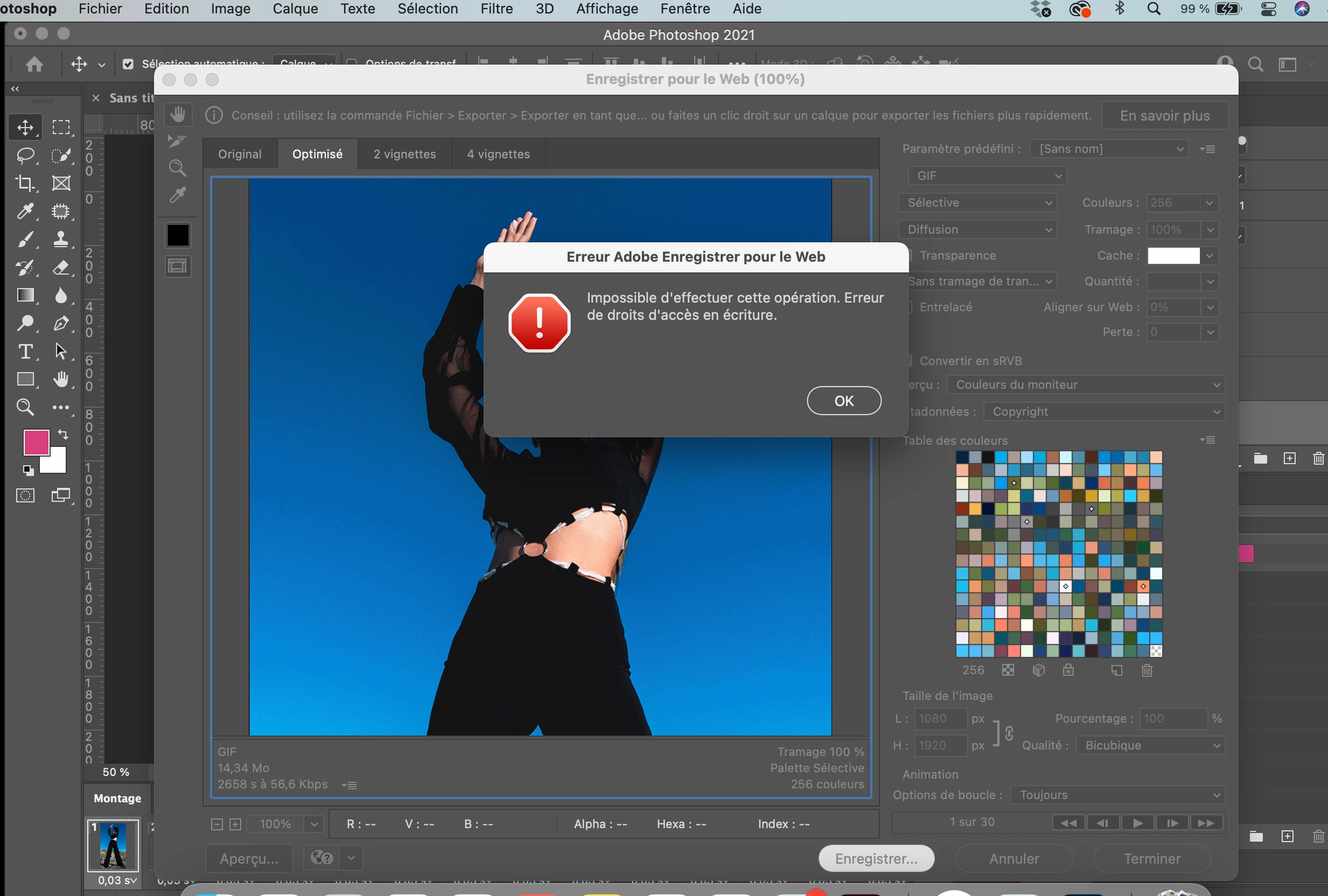

Bonsoir,
J'étais en train de me faire un petit GIF avec quelques photos et au moment d'enregistrer mon GIF...impossible !
On me parle de droit d'accès (???) que je n'aurai pas.
Est-ce-que quelqu'un aurait la solution pour débloquer cela ?
Merci beaucoup,

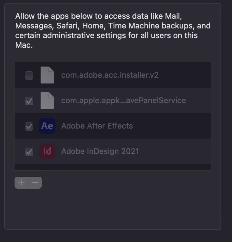

I have a fix!
You have to go to Security and Privacy in system preferences, go to Full Disk Access on the left.
Then, in the finder, go to the Go menu, (Go Menu > Go to Folder" and put:
/System/Library/Frameworks/AppKit.framework/Versions/C/XPCServices/com.apple.appkit.xpc.openAndSavePanelService.xpc/Contents/MacOS/com.apple.appkit.xpc.openAndSavePanelService
Then drag "com.apple.appkit.xpc.openAndSavePanelService" into the list of apps allowed to access data (see attached screenshot). You can't, as far as I can tell, add it using the + button, but dragging-and-dropping worked for me.

Thanks for this @guruscotty . I tried adding com.apple.appkit.xpc.openAndSavePanelService and also the "Save For Web" app by dragging them to the Full disk access items. Unfortunately none of this worked for me...
Now the issue has also surfaced on my iMac. I am starting to think this has something to do with my Dropbox. Anyone else have Dropbox installed?
Jul 1, 2021 12:57 PM UTC
Sorry it didn't work for you!
I do have Dropbox, as well.

Hello I am running on the katest version of photoshop 22.4.2 and on Mac Big Sur version 11.4 it won't let me save for web, i have deleted my preferences, restrated, uninstalled and reinstalled for web and the same error message keeps appearing see below

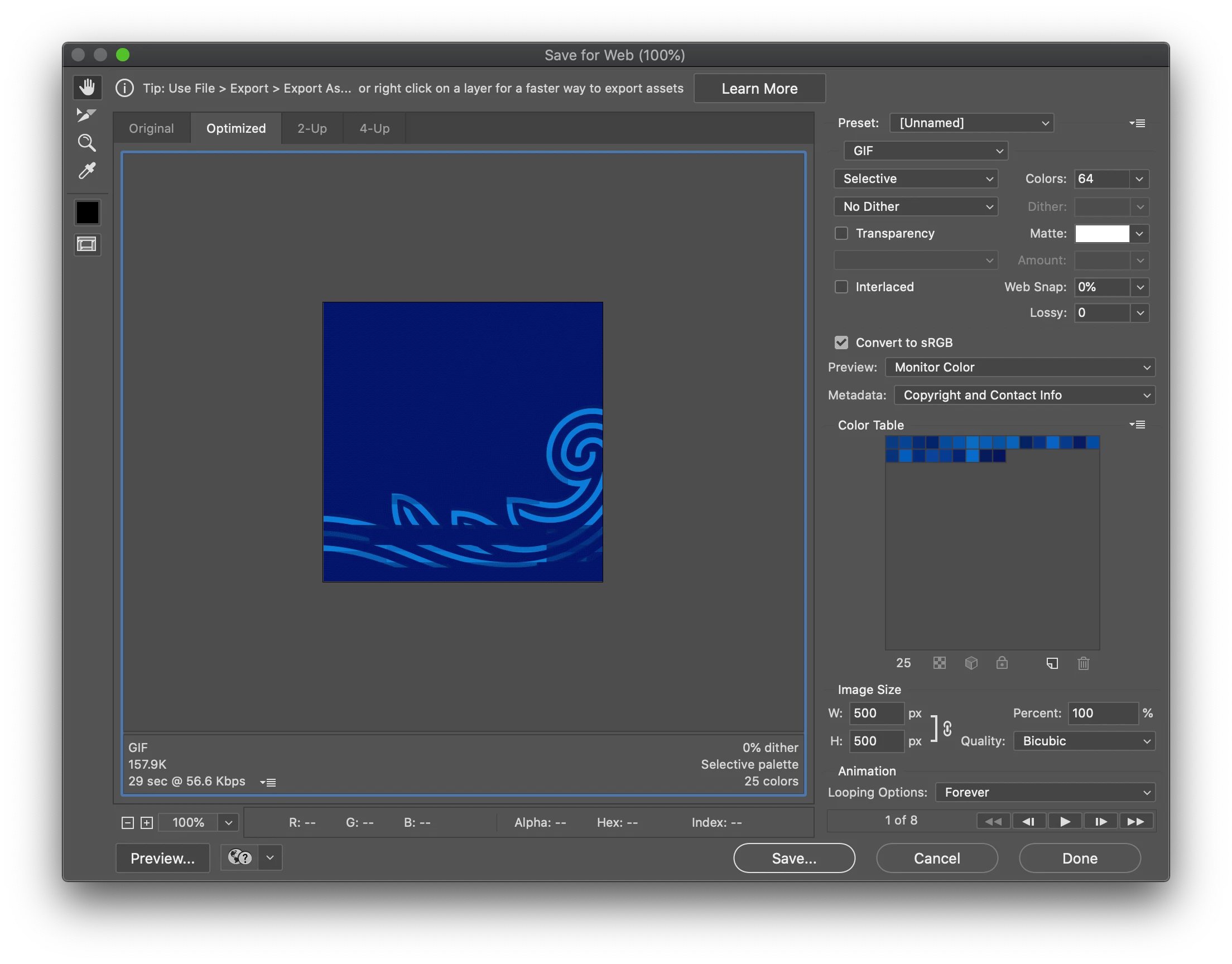

I have the same problem. My work around - Click the 'Preview Button' which is on the bottom left of the export panel. Then right-click the gif and save it to a local folder

Could not complete this operation. A write permission error has occurred.
Do we actually have a solution for this error, other than a work a round?
I have already changed permissions in security settings for Photoshop
Its really quite annoying. I just did the latest download hoping it was resolved still with no luck.

I am having the same issue. I've just updated to Big Sur on my Intel Macbook pro. Running latest versions of everything (PhotoShop 22.4 and Big Sur 11.3.1). I also just want to save out an animated GIF.
