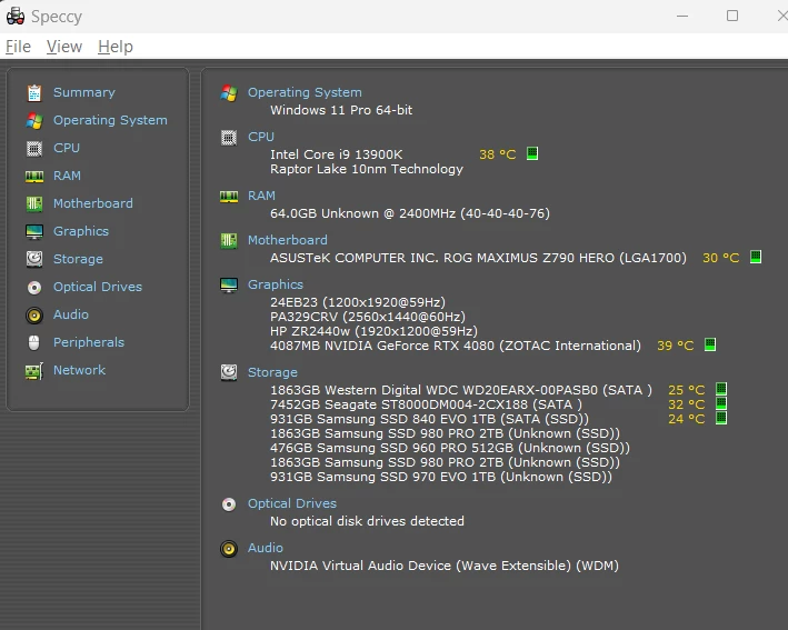

    I have a similar, but a wee bit older system:
    i9-13900K
    RTX4080
    64GB ram with Photoshop set to the default 70%
    Asus ROG Maximus Z790 Hero

    Did you build this system?
    What are your running temperatures like?  This is what I see with Speccy (running at idle)

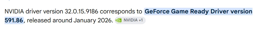

    Per Berntsen
    Aug 26, 2026 10:52 PM UTC
    ​@buficial
    Driver date:                  2026-01-20  000000.000000-000
    Driver age:                   7 months
    Driver version:              32.0.15.9186
    Your GPU driver is seven months old, which may be cause of your problems.
    Go to the Nvidia website and download and install the latest driver.
    Make sure to install the Studio driver, not the Game ready driver.
    Here’s a direct link: https://www.nvidia.com/en-eu/drivers/details/278087/
    If you have a laptop, use this link: https://www.nvidia.com/en-eu/drivers/details/278088/
    Aug 27, 2026 1:27 AM UTC
      Driver date:                  2026-08-20  000000.000000-000
          Driver age:                   0 months
          Driver version:               32.0.16.1656
    Another member was also talking about this, I actually had the game ready drivers instead of studio. It did not fix my problem, but at least one more thing towards progress. This is the updated readout. Thanks!
    Trevor.Dennis
    Aug 27, 2026 8:32 PM UTC
    I think people are getting confused, and I can understand that because of how convoluted the information is.
    ​@buficial  32.0.16.1656 is a Game Ready driver.  The Studio driver is the safer option with Photoshop.
