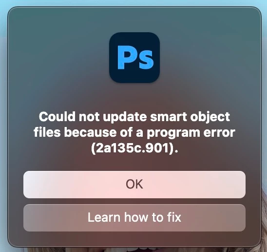

Sometimes,
 but quite often, when using a Curves adjustment as a smart adjustment on a Smart Object, after I create the first point and start dragging, the curve freezes and can’t be moved any further. The only workaround is to select the point and move it with the keyboard arrows.
Sometimes, any further action on the selected Smart Object layer produces the following error:
“Could not update smart object files because of a program error (2a135c.901).”
Sometimes the error persists after a restart, sometimes not.
Please fix!
This bug is in addition to the flickering of the image while adjusting (when the Curves do work).

    Charismatic_yogiB82A
    Oct 30, 2026 4:05 PM UTC
    HI ​@Srishti Bali
    Thanks!
    The mouse cursor doesn’t freeze — I can move my mouse (both the Wacom and the Logitech mouse), but the curve is stuck. I can’t move it any more. I can close the dialog and open it again, but still can’t move the curve. And at some point I get the error mentioned above. So I imagine Photoshop is in some kind of stall at that moment.
    The system info is attached here as a text file.
    Right now I can’t reproduce the bug — only the flickering is visible, but as you said, that’s a different issue and thread, which is why I can’t send a screen recording of it. I’ll send one when it appears again, and I’ll send an example file too.
