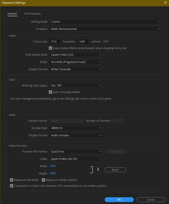

Mar 20, 2024 9:18 AM UTC
The sequence needs to exactly match the source video, otherwise it might cause problems. It can be pretty annoying but it works - at least for me.

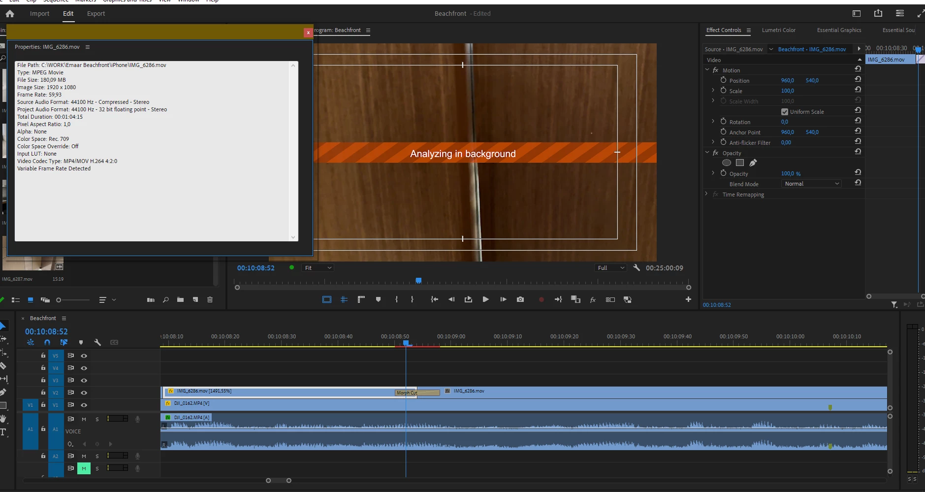

Jan 22, 2024 12:06 PM UTC
Premiere Pro 24.1 built-in transition Morph Cut seems to have stopped being usefull at all since it never finishes analysing in the background with my videos.
My workflow 1 - create a sequence with the settings below, import the footage, cut it, place the morph cut between the clips, colorgrade and use effects afterwards.
My workflow 2 - same except that I cut 2-3 seconds at the end of the first clip and 2-3 seconds at the beginning of the second and in between those secondary parts I place the morph cut transition.
In both cases morph cut keeps analysing the material for eternity. It does sometimes work (rarely and I didn't catch the pattern) but most of the time it goes into this analysing phase and never finishes.
- nesting does not help
- rendering and replacing to some other format does not help
- flushing cache does not help
- changing the sequence settings does not help
- didn't check other video formats since my current client gives me only footage from one and the same camera
- MERCURY RENDERER immediatelly helps BUT makes it next to impossible to work further. Switching back to CUDA brings back the endless analysis.
