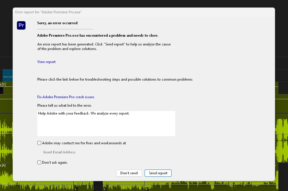

I am using Premier pro 25.1 on a windows PC, I opened up my project the other day to start work and I was unable to freely click on a clip and drag the clip about on the timeline with the same thing happening with audio. When I do click on a clip to move or drag it I am presented with the picture I have attached, in my program window.
I have tried everything on nearly every forum page I can find, reset all settings from splash, cleared cache, uninstalled and reinstalled softwear, new project, everything I can think of but I can't find anything anyway with someone with this same fault.

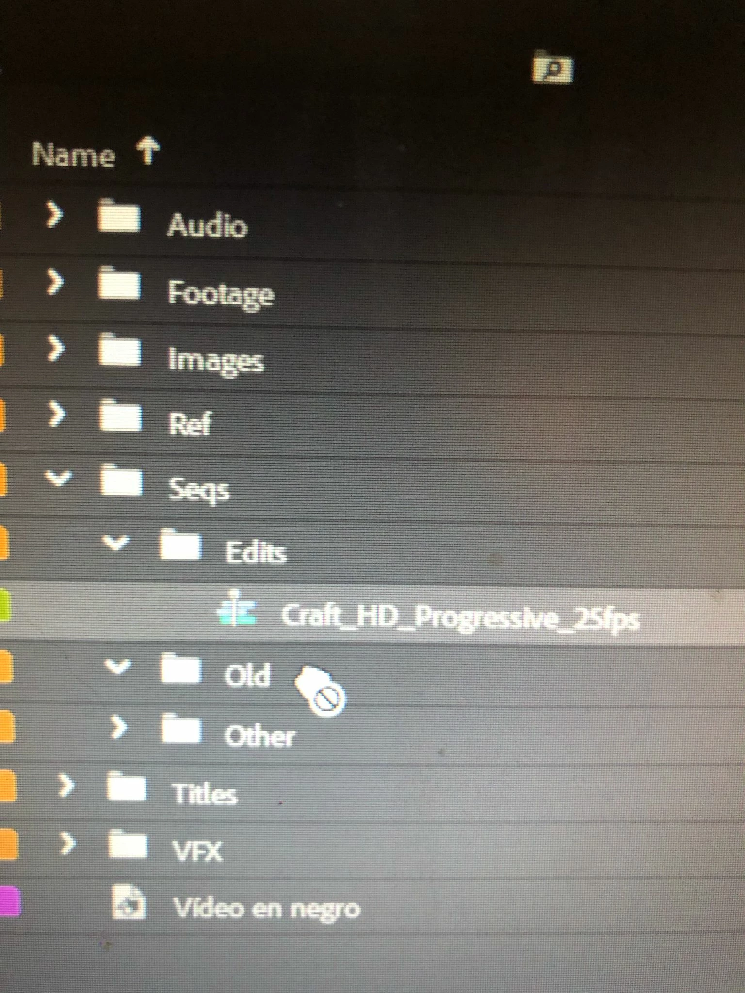

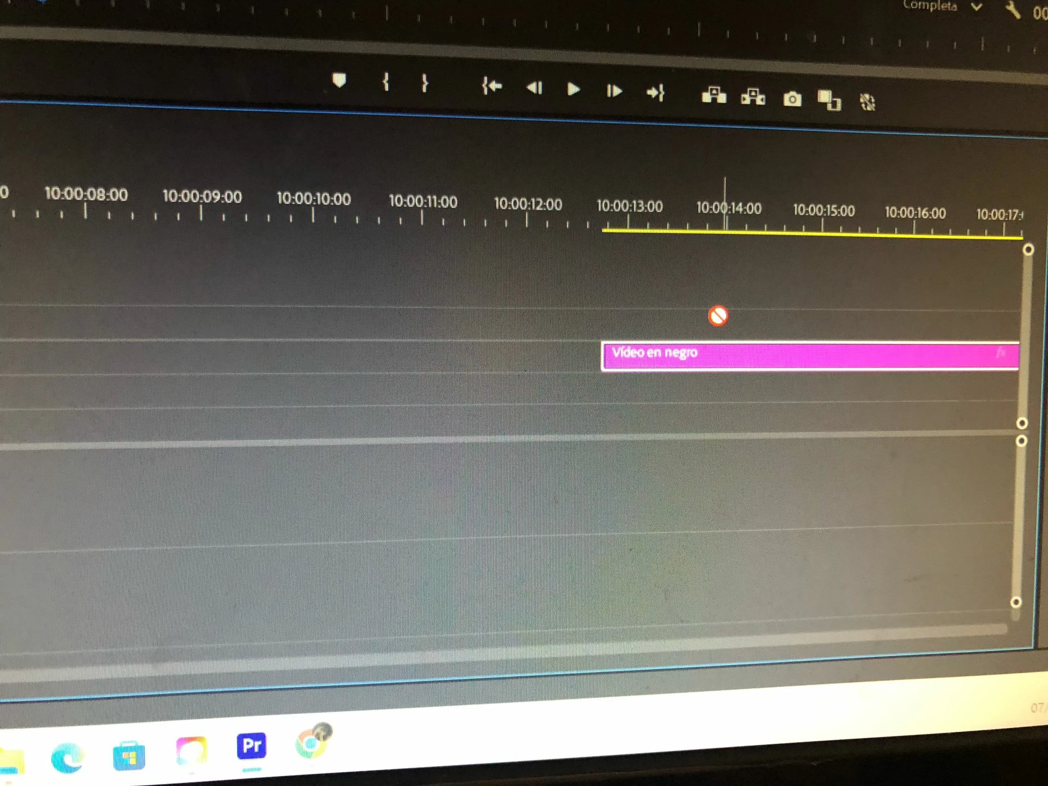

I have a serious problem that does not allow me to work on my project. I have Premiere 2025.
If I try to move any clip by folders inside my panels, Premieres doesn't allow me to do it.
Also, when I drag my clip on the timeline Premieres puts it 2 or 3 minutes from the beginning and if I try to move it, it is impossible, and a “not allowed” icon appears.
So I can't use Premiere. Please help!
