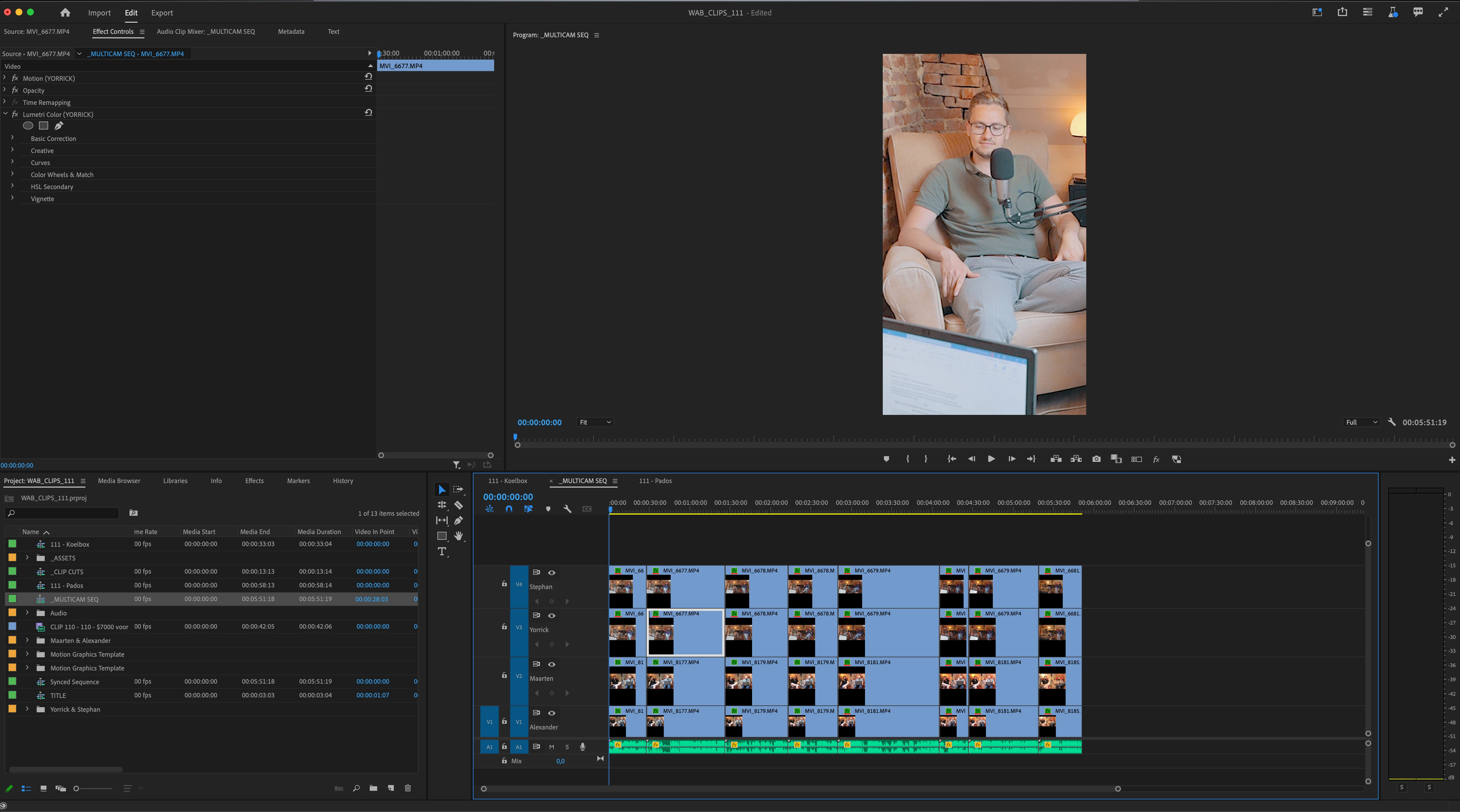

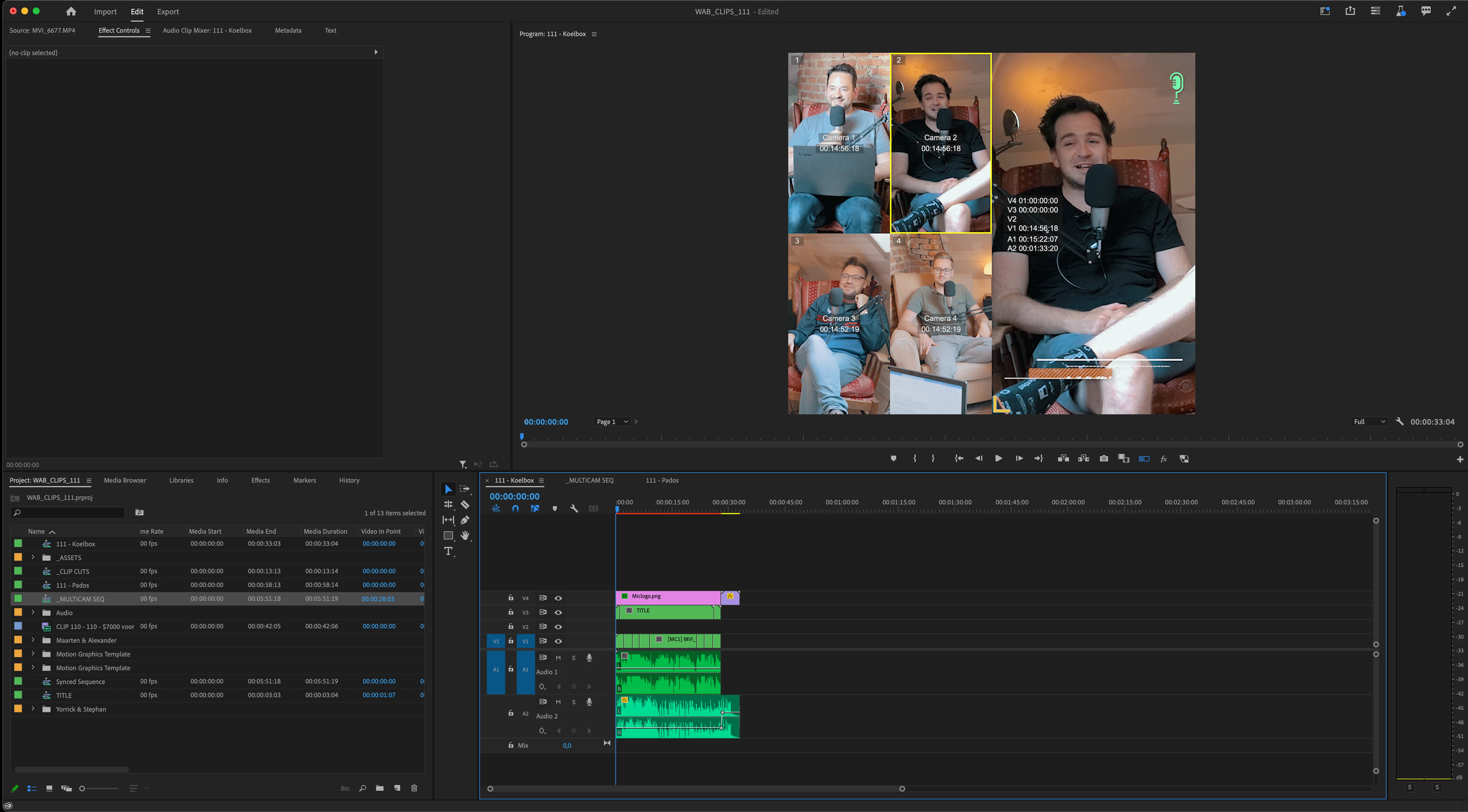

Jun 8, 2023 10:21 AM UTC
Hi there!
I'm attempting to edit short social media clips for my podcast.
For this, I've recorded my footage with two cameras in 1080p 16:9, from which I isolate two angles in each shot. Thus, I've got four 9:16 shots of each host.
As far as I'm aware, I've correctly created my multicam sequence clip.
However, a strange error occurs when I try to edit with the clip on a new timeline.
I drag the multicam clip onto my timeline and enable the multicam view in my Program Monitor window. Initially, I see the four shots on the left and my currently selected angle to the right, just as it should be. But as soon as I make a cut, the four preview angles disappear, and the selected camera centers in my Program Monitor window.
I can only bring them back by disabling and re-enabling the track on which the multicam clip is placed. It then plays without any issues, but whenever I make a cut—either by clicking on an angle or using the keyboard shortcut to cut to a camera—all the angles disappear again and I'm left with only the program preview of the selected camera. The strangest thing is that the info overlay of the camera angles remains on screen.
I believe this is a bug and I've tried almost every toggle I could think of, from changing the render engine to creating proxies.
I'm running Premiere Pro v23.4, but I've also tried it on the Premiere Pro Beta v23.6.
I've included screenshots of the various stages of my problem to make it a little clearer.

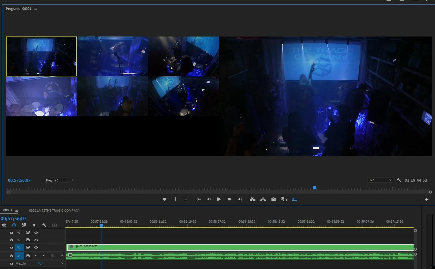

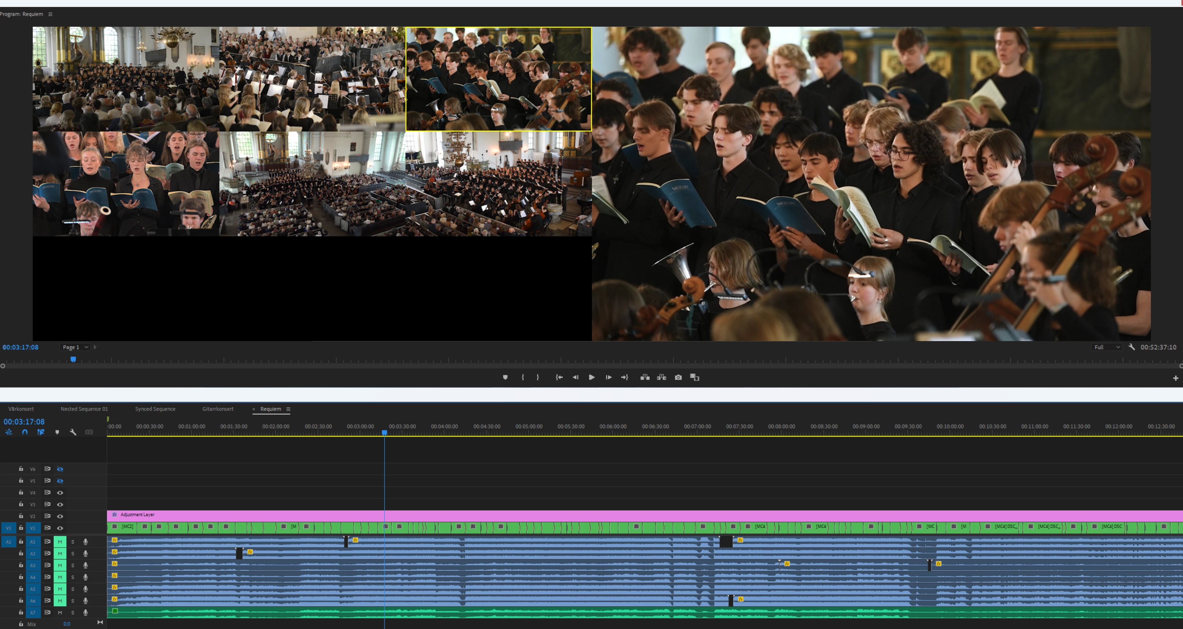

I am editing a multi camera project with six cameras. I have the six cameras on the left and the selected camera on the right. Since the last version of Premiere Pro, an ennoying bug has been introduced. After some editing, the six cameras disappear and I only see the selected camera. I can get the six cameras back by clicking "toggle track output" and hiding and unhiding the V1 line. After a little time the same thing happens again. Any ideas what to do about it? Pressing Shift-0 doesn't help.
I am using Premiere Pro 23.4.0 on Windows 11.

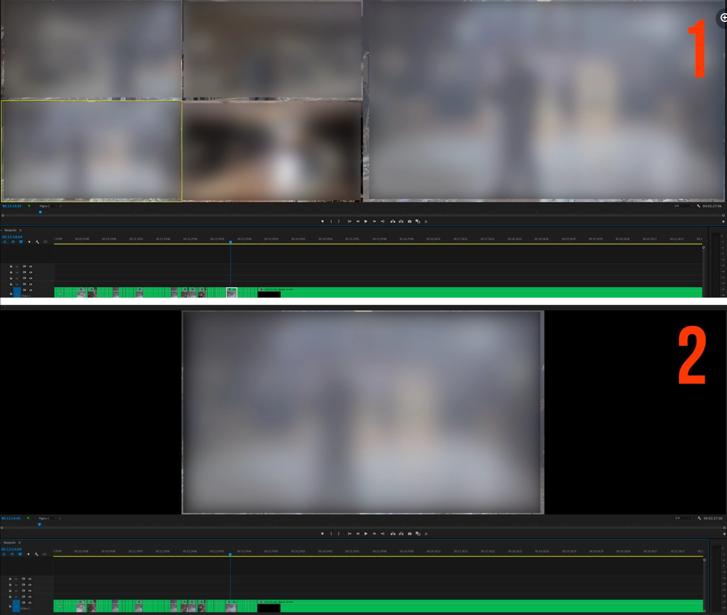

May 31, 2023 10:12 PM UTC
The monitor in multicam mode works fine until I make a cut (C), from that moment the monitor is not  working properly.
Sometimes it shows like it´s suppose to be (Image 1).
But then, after stop and make a cut or even just stop, the monitor shows only one angle (like it was regular monitor/preview) (image 2).
So now there is not multicam angle in the monitor, just one image.
I found a workaround wich is to press any key that change angle (1,2,3) then the monitor goes back to multicam, but it's extremly frustrating to work like that.
Yes I've restore preference, make new sequence, same.
The multicam is smooth, not dropped frames, everything works fine until that bug appears.
Premiere Pro 23.4 and Beta 23.6 (Both same problem)
Intel(R) Core(TM) i7-10875H CPU @ 2.30GHz
32 GB RAM, Nvidia GeForce RTX 2070 | 8GB, Windows 11.

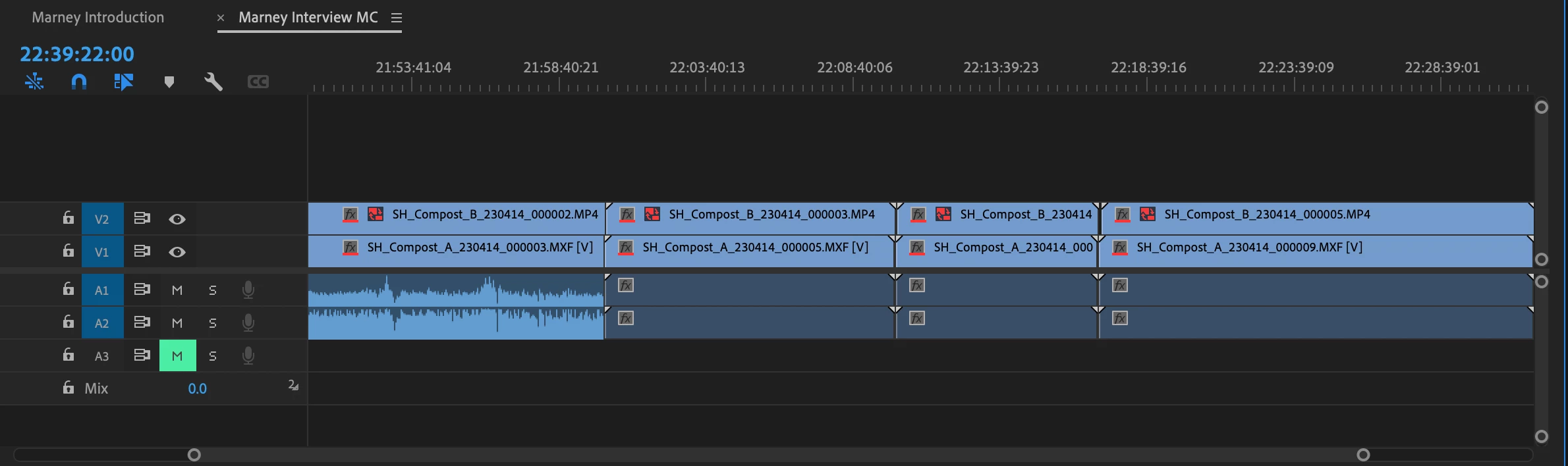

May 31, 2023 9:56 AM UTC
So the multicam view in version 23.4 stops showing the camera angles randomly at some point  or if playing around with the track targeting which as you know also controls the multicam angles.
To bring it back I have to select another sequence, maximize or minimize windows with the ~ key or just play around randomly with the interface by changing the windows and selecting stuff to make the image in the program monitor change.
23.3 works as it should.
Be aware of this if you want to update.
I'm on Windows 11, Intel gen 11 CPU.
