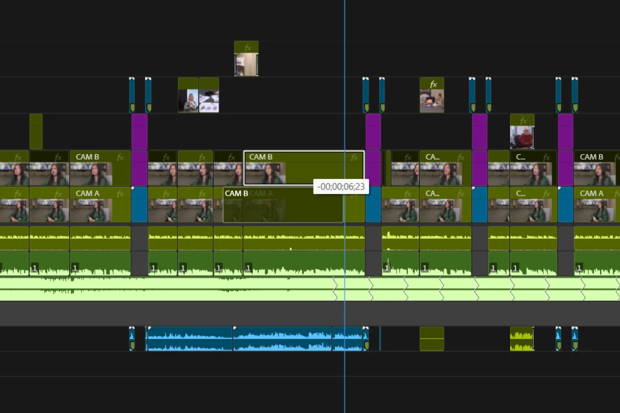

Having a bit of a bizzarre issue with Premiere Pro 2025.
When extending displays, when moving footage/ nests on the timeline, the mouse is totally out of sync - to the point where I have to drag my mouse to the bottom of the screen to get it into track 1 or 2. It only happens when extending displays, when I use just the monitor or just my laptop it works fine.
I've attatched an image to try and show it best I can. Doesn't show my mouse but in this screenshot it's underneath the audio track, and to the right.
We've tried almost everything to resolve this:
- Different monitor
- Different mouse
- Reverted to old version of Premiere Pro (also tried 2024, same issue)
- Updated drivers with custom installation
- Different HDMI lead
Any other suggestions? It's a nightmare! Just to note its only Premiere pro, none other adobe softwares. Thanks in advance.
