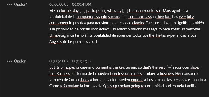

    Stan Jones
    5월 5, 2026 12:03 오후 UTC
    ​@TailsRolls,
    That is very weird!
    What version of PR are you using? What OS? Do you have Lanuage auto-detection selected in preferences by any chance?
    You say subtitles, but I think you are referring to the transcription. If you right-click a clip in the Project Panel, pick transcribe (re-transcribe), select the correct language for the clip (and correct audio channel if more than one), what do you see?
    Stan

    TailsRolls
    5월 5, 2026 6:36 오전 UTC
    Estaba trabajando en una secuencia y los subs que me generan están en espanglish irreconocible, he trabajado diversos proyectos similares y estas semanas me sigue pasando lo mismo.
