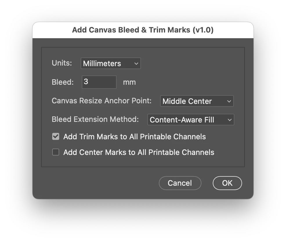

Introducing my "Add Canvas Bleed & Trim Marks" script:
Key features include:
* Define bleed in millimetres or inches
* Choose your canvas resize anchor point (upper left, middle centre, etc.)
* Leverage Content Aware Fill (v2020+) or Generative Fill (v2024+) to create bleed
* Add trim marks and/or centre marks in all colour channels, including spot colour channels!
Notes:
* Although the RGB/CMYK trim marks are vector, they may not be recognised as such in other applications
* The canvas size trim mark extension is centred on the enlarged canvas (based on sizing from InDesign)
* Photoshop can't write PDF page box information (e.g. trim box, bleed box, etc.) to the PDF file
* A new merged document is created with additional bleed and optional trim and centre mark layers
* Existing ruler guides are cleared with new guides added at the original canvas edges
* Trim and centre marks are added to all printable channels, including spot channels
* Artboards are not supported, the script will abort if artboards are detected
* Intended for adding simple rectangular bleed, not complex contours

var dlg = new Window("dialog", "Add Canvas Bleed & Trim Marks (v1.0)");
dlg.preferredSize.width = 350;
dlg.orientation = "column";
dlg.alignChildren = "fill";
// Create main panel for controls
var mainPanel = dlg.add("panel");
mainPanel.orientation = "column";
mainPanel.alignChildren = "left";
mainPanel.margins = 16;
// Unit selection group
var unitGroup = mainPanel.add("group");
unitGroup.orientation = "row";
unitGroup.alignChildren = "left";
unitGroup.add("statictext", undefined, "Units:");
var unitDropdown = unitGroup.add("dropdownlist", undefined, ["Millimeters", "Inches"]);
unitDropdown.selection = 0;
// Size increment group
var sizeGroup = mainPanel.add("group");
sizeGroup.orientation = "row";
sizeGroup.alignChildren = "left";
sizeGroup.add("statictext", undefined, "Bleed:");
var sizeInput = sizeGroup.add("edittext", undefined, "3");
sizeInput.characters = 6;
var unitLabel = sizeGroup.add("statictext", undefined, "mm");
// Anchor point selection
var anchorGroup = mainPanel.add("group");
anchorGroup.orientation = "row";
anchorGroup.alignChildren = "left";
anchorGroup.add("statictext", undefined, "Canvas Resize Anchor Point:");
var anchorDropdown = anchorGroup.add("dropdownlist", undefined, [
    "Top Left", "Top Center", "Top Right",
    "Middle Left", "Middle Center", "Middle Right",
    "Bottom Left", "Bottom Center", "Bottom Right"
anchorDropdown.selection = 4; // Default to Middle Center
anchorDropdown.helpTip = "Select the anchor point for the canvas resize. The bleed will be added to the opposite side(s).";
// Add selection for Fill Method
var fillMethodGroup = mainPanel.add("group");
fillMethodGroup.orientation = "row";
fillMethodGroup.alignChildren = "left";
fillMethodGroup.add("statictext", undefined, "Bleed Extension Method:");
// Check Photoshop version for Generative Fill, Photoshop 2024 is version 25.x
var psVersion = parseInt(app.version.split('.')[0]);
var fillMethods = ["Content-Aware Fill"];
if (psVersion >= 25) {
    fillMethods.push("Generative Fill");
var fillMethodDropdown = fillMethodGroup.add("dropdownlist", undefined, fillMethods);
// Default to Content-Aware Fill
fillMethodDropdown.selection = 0;
fillMethodDropdown.helpTip = "Generative Fill is only available in Photoshop 2024 and later.";
// Add trim marks checkbox
var trimMarksCheckbox = mainPanel.add("checkbox", undefined, "Add Trim Marks to All Printable Channels");
trimMarksCheckbox.value = true; // Default checked
// Add a checkbox for centre marks
var centerPathCheckbox = mainPanel.add("checkbox", undefined, "Add Center Marks to All Printable Channels");
centerPathCheckbox.value = false; // Default unchecked
// Event listener for anchor point selection
anchorDropdown.onChange = function () {
    // Check if the selected anchor point is "Middle Center"
    if (anchorDropdown.selection.text === "Middle Center") {
        trimMarksCheckbox.enabled = true; // Enable the checkbox
        trimMarksCheckbox.value = true;  // Set the checkbox to true
    } else {
        trimMarksCheckbox.enabled = false; // Disable the checkbox
        trimMarksCheckbox.value = false;  // Uncheck the checkbox

        var idverticalLocation = stringIDToTypeID("verticalLocation");
        var verticalValue;
        switch (anchorPosition) {
            case 6: case 7: case 8: // Bottom
                verticalValue = "bottom";
                break;
            case 0: case 1: case 2: // Top
                verticalValue = "top";
                break;
            default: // Middle
                verticalValue = "center";
        desc.putEnumerated(idvertical, idverticalLocation, stringIDToTypeID(verticalValue));
        executeAction(idcanvasSize, desc, DialogModes.NO);
        // Load the transparency selection from the base merged layer
        var idset = stringIDToTypeID("set");
        var desc627 = new ActionDescriptor();
        var idnull = stringIDToTypeID("null");
        var ref142 = new ActionReference();
        var idchannel = stringIDToTypeID("channel");
        var idselection = stringIDToTypeID("selection");
        ref142.putProperty(idchannel, idselection);
        desc627.putReference(idnull, ref142);
        var idto = stringIDToTypeID("to");
        var ref143 = new ActionReference();
        var idtransparencyEnum = stringIDToTypeID("transparencyEnum");
        ref143.putEnumerated(idchannel, idchannel, idtransparencyEnum);
        desc627.putReference(idto, ref143);
        executeAction(idset, desc627, DialogModes.NO);
        // Contract the selection by 1 pixel to remove any transparency anti-aliasing artifacts
        app.activeDocument.selection.contract(1);
        // Invert the selection
        executeAction(stringIDToTypeID("inverse"), undefined, DialogModes.NO);
        // Add the bleed using the selected fill method
        if (fillMethodDropdown.selection.index === 0) {
            contentAwareFill();
        } else {
            generativeFill();
        // Deselect the selection
        app.activeDocument.selection.deselect();
        // If trim marks checkbox is checked, add additional canvas space
        if (addTrimMarks) {
            // Create action manager code for trim marks canvas resize
            var idcanvasSize = stringIDToTypeID("canvasSize");
            var descTrim = new ActionDescriptor();
            // Set relative mode
            var idrelative = stringIDToTypeID("relative");
            descTrim.putBoolean(idrelative, true);
            // Conditionally set width and height for trim marks space based on 3 mm or 0.125 inch
            if (isMetric) {
                // Metric trim mark space by scaling the bleed size, approximating InDesign
                var trimWidthIncrement = widthIncrement * 1.78;
                var trimHeightIncrement = heightIncrement * 1.78;
            } else {
                // Inches trim mark space by scaling the bleed size, approximating InDesign
                var trimWidthIncrement = widthIncrement * 1.75;
                var trimHeightIncrement = heightIncrement * 1.75;
            // Set width and height for trim marks space
            var idwidth = stringIDToTypeID("width");
            var idheight = stringIDToTypeID("height");
            var idpixelsUnit = charIDToTypeID("#Pxl");
            descTrim.putUnitDouble(idwidth, idpixelsUnit, trimWidthIncrement);
            descTrim.putUnitDouble(idheight, idpixelsUnit, trimHeightIncrement);
            // Use the same anchor point as the bleed extension
            descTrim.putEnumerated(idhorizontal, idhorizontalLocation, stringIDToTypeID(horizontalValue));
            descTrim.putEnumerated(idvertical, idverticalLocation, stringIDToTypeID(verticalValue));
            // Resize the canvas for trim marks
            executeAction(idcanvasSize, descTrim, DialogModes.NO);
            // Call the function to add trim marks
            vectorTrimMarks();
        // End of script execution
        app.beep();
        dlg.close();
    } catch (e) {
        alert("Error: " + e.message + '\n' + "Line: " + e.line);
// Render the dialog
dlg.center();
dlg.show();
// Merge the trim marks layer down into the bleed layer
var idmergeLayersNew = stringIDToTypeID("mergeLayersNew");
var desc367 = new ActionDescriptor();
var idapply = stringIDToTypeID("apply");
desc367.putBoolean(idapply, true);
executeAction(idmergeLayersNew, desc367, DialogModes.NO);
// Set the name of the merged layer
app.activeDocument.activeLayer.name = "Trim Marks & Bleed";

  1. Copy the code text to the clipboard
  2. Open a new blank file in a plain-text editor (not in a word processor)
  3. Paste the code in
  4. Save as a plain text format file – .txt
  5. Rename the saved file extension from .txt to .jsx
  6. Install or browse to the .jsx file to run (see below)
https://prepression.blogspot.com/2017/11/downloading-and-installing-adobe-scripts.html
Stephen Marsh
April 28, 2024
Content Aware Fill has made this much simpler, but not always perfect. Filter > Other > Minimum can also be of use for tight bleed tolerances. Yes, more work could be done in this area (even if nobody cares about print production anymore), I have added my vote!
https://community.adobe.com/t5/photoshop-ecosystem-discussions/adding-bleeds-to-an-outlined-photo/m-p/10886580
https://community.adobe.com/t5/photoshop-ecosystem-discussions/how-to-bleed-photos-with-diecut-shape-in-photoshop/m-p/10625624
https://community.adobe.com/t5/photoshop-ecosystem-discussions/adding-bleed-to-complex-stickers/m-p/11150470
