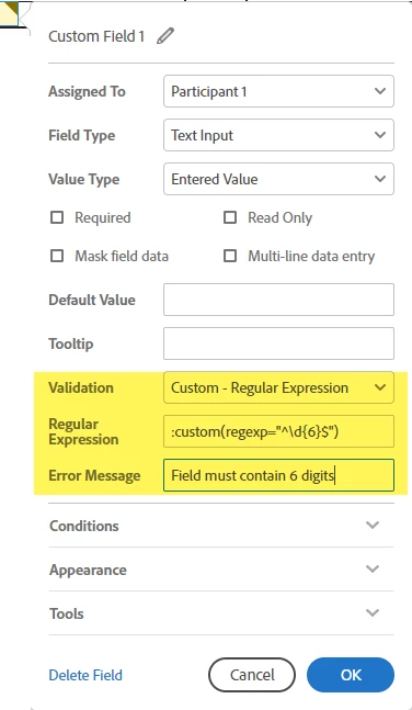

I am putting together a Direct Deposit form for a new hire. I have figured out how to require the signer to enter digits and I put a maximum # of digits allowed. How can I require a minimum amount of digits?

For Enterprise users, the best alternative is to use a regular expression.  Below is an example showing where the validation is, and how to expose/configure it.
The actual regular expression will depend on how many characters you want to allow.
If you want to allow 4 digits, the expression would be:
^\d{4}$
The text tag directive would be:
:custom(regexp="^\d{4}$")
