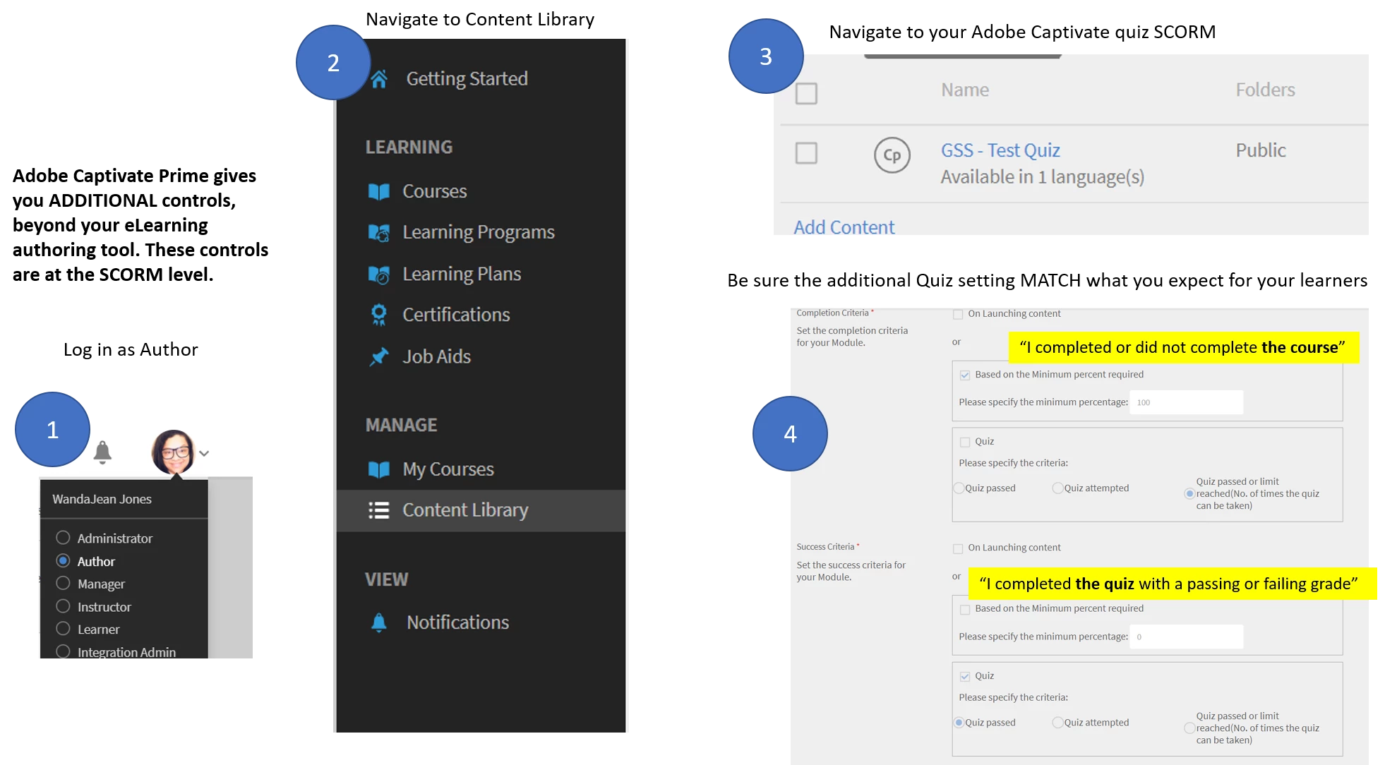

    Sep 17, 2021 12:05 PM UTC
    Hi @MARZIA5F91 ,
    Check this out.
    Adobe Captivate Prime is helping your report on 2 different levels...
    • Did the learner complete the module?
    • Did the learner complete the module with a passing or failing grade?
    My assumption is that the person who "passed" with a 50% took a course where you have "launched the course" as the criteria for success.
    1. Open as Author
    2. Go to content library
    3.  Go to your quiz SCORM
    4.  Be sure to set the "completion" and "success" criteria as deisred
    Let me know how it goes for you!
