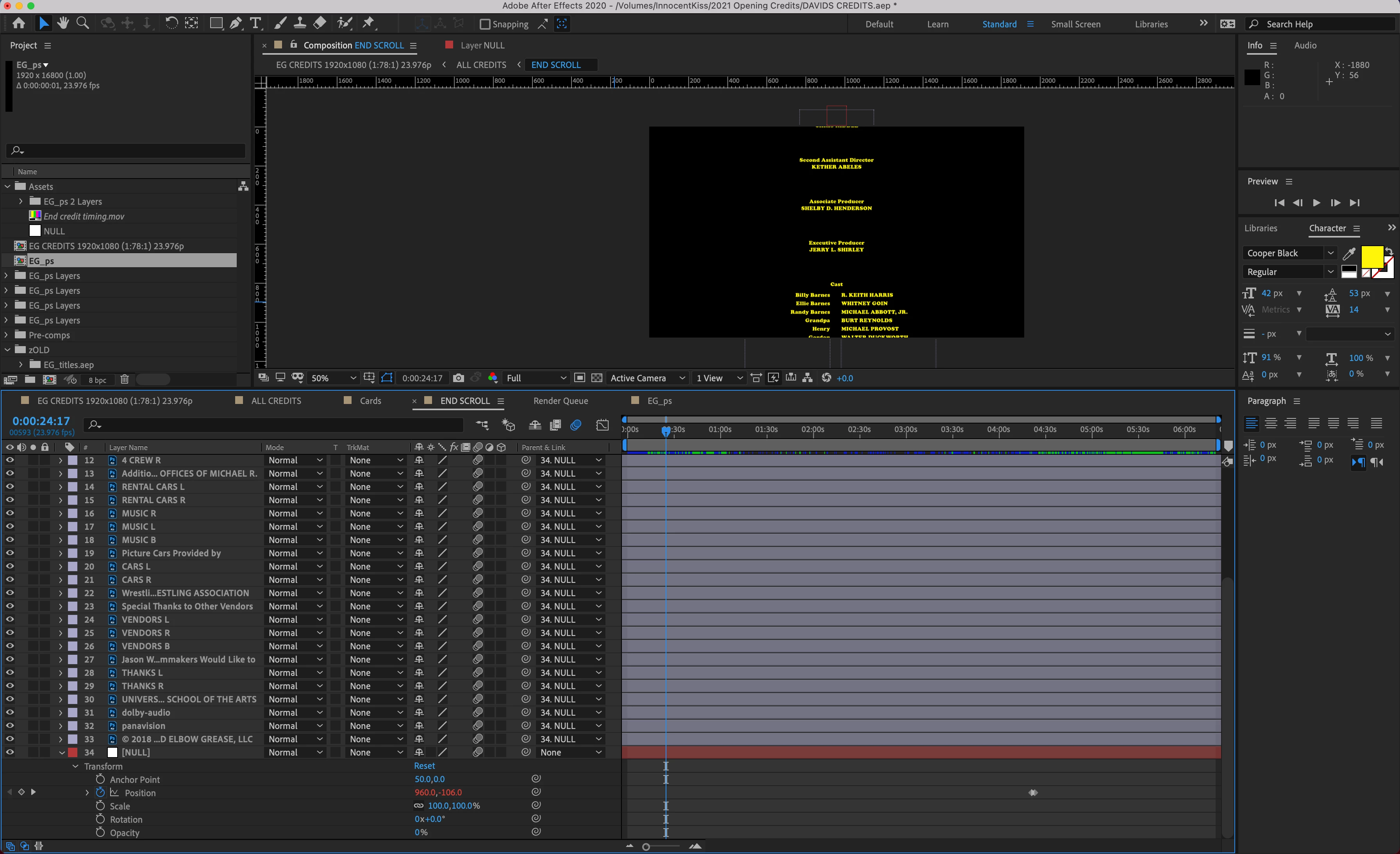

I think did this right. This file came from a photoshop file in to AE.
February 10, 2021
It looks like the credit roll is controlled by a parent null. What is the expression that is driving the null?
The null also has position keyframes. They may or may not do anything. It depends on the expression.
February 10, 2021
You should give more info, at least a screenshot of your workspace including the timeline panel with visible keyframes of your animated layers, but generally: narrow your keyframes to each other
