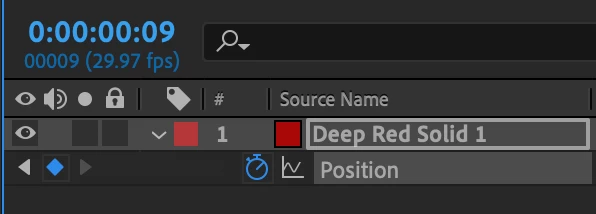

I've recently purchased After Effects CC 2019 for my Mac and I'm completely new to the program, and I'm having a few issues with it. I've been watching some tutorials and I see that everyone's able to drag clips/keyframes easily along the timeline, but whenever I try that on my project, it's like they're frozen. I can move them using brackets—[]—but that's all, and it's getting really annoying to do. Even trying to use the little arrows beside the clips to shrink them/make them longer and all of that doesn't work. I'm not sure what's going on.

    Check your fps (frames per second) on your compositon layers!
    If the key frame issue is on a pre comp layer, the pre comp may be set to a different fps than your main compostion's fps. Change the main composition frame rate to your pre comp frame rate and it should work. This glitch may effect position and anchor point key frames. Good luck!

    My video has 25 FPS, the composition had 29.97 FPS. I have experience the following behaviour:
    Moving the key-frame knob was possible once, maybe twice. Then, after the key-frame knob had beend dropped to its new location it was not possible to move it again. Doing undo to return it to its original position it was moveable again. Once saved in an non-moveable state, it was non-moveable.
    Deleting cache does not fix it.
    After setting the FPS of the composion to that of the video (25 fps) the issue disappeard!

    There's moving the Layer Timespan (which is what you're doing when you press the left bracket or right bracket) and then there's nudging (or moving) the keyframes.  If the keyboard shortcut is working, then you should be able to click and drag the Layer Timespan with the Selection tool.  Furthermore, you should be able to click and drag a marquee selection (a rectangle) around the keyframe or keyframes that you want to nudge (you may have noticed that they turn blue when selected).  You can then click and drag them left or right with the Selection tool.
    Another thing to double-check is the current frame rate and duration in After Effects.  To a new user, a Comp that's 5 frames long can look the same as a Comp that's 5 seconds long or one that's 5 minutes long.  Also, if you somehow set a very low frame rate (like 1 frame per second), it may appear that your frames don't have too many places to go.
