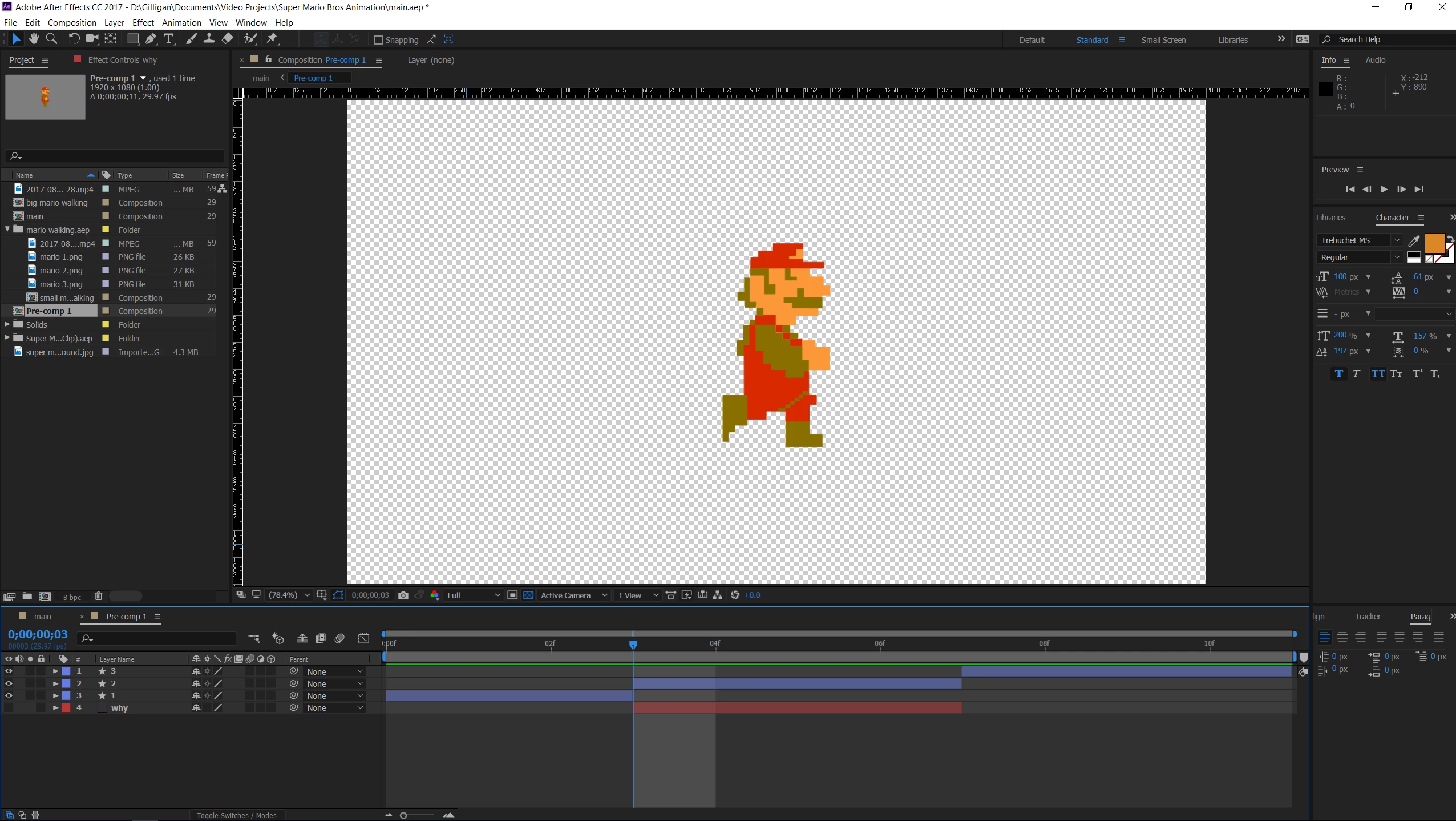

I a working on a recreation of Super Mario Bros in after effects and I need the 3 images of Mario's walking animation to loop endlessly for whenever I need to use it, I decided to use the "loopOut()" function because it would be faster (ironic -_-). Here's a screenshot of the comp and it's settings:

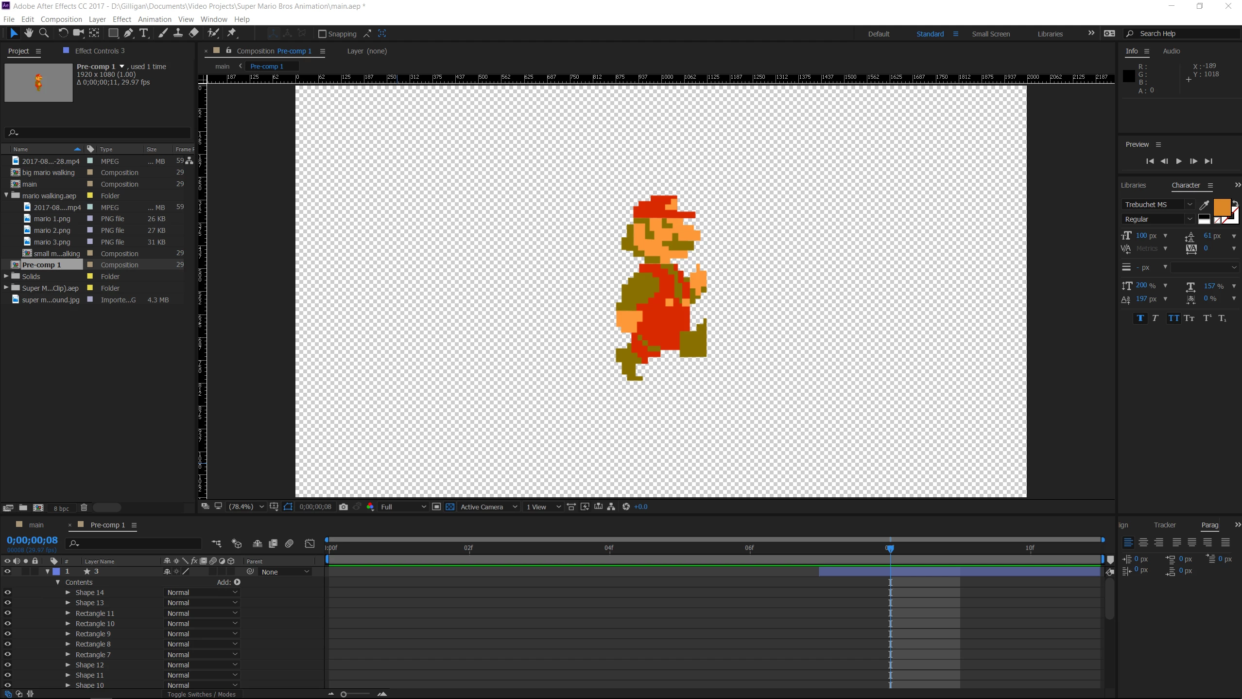

I suppose i should say that I didn't make these picture's, I got the files from a friend. Each one is a shape layer. I tried to do the old loopOut() function and move the last key frame back one etc etc, but it didn't work, the last frame was invisible. This isn't the weird part.
I searched up solutions to this and found some, I tried them in a new project and they all worked perfectly, but for some reason, whenever I do the EXACT same process with these 3 shape layers it NEVER works right. The weirdest part is that I found a way to improvise. I wondered if the problem was the fact that it was a shape layer, so I made a new solid and moved it to the back of that composition, IT WORKED, I didn't get the invisible frame, but why...?
After experimenting some more I found that I could put the solid layer in the middle of the composition and scale it down so I couldn't see it behind the Mario images, and it still worked!!! However, making the solid invisible gave me the problem again, that stupid invisible layer. Is there a logical explanation to this?
