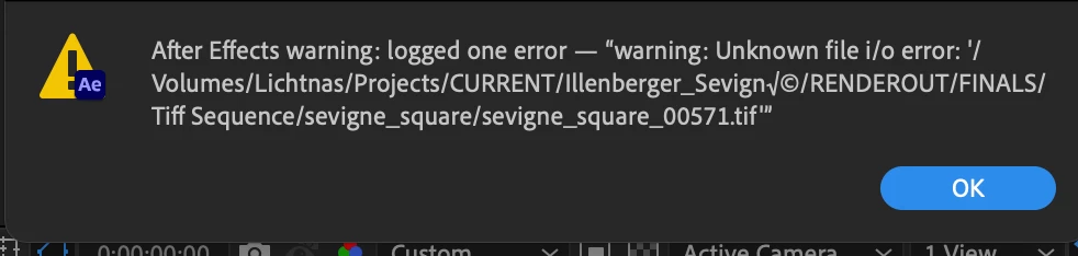

When rendering the 1.2 min Full HD movie the allocated AE cache in my library 1TB SSD is overflowing so drastcally und fast that I get the message that the program stoarage is used up followed by a crash, often a serious kernel panic. I tested increasing the cache to up to 180 gb. No help. I tested ousourcing the cache folder to my Server (10gb eathernet). Eventually it would run through a rendering once and then crash. I emtied all the cache partitions within the AE preferences tab before each render. The program created 140 GB of cache files for the relatively short sequence.
I have also attached error messsages that I get after rendering has completed.

As a start, get rid of the special characters in the file names. Even using a copyright symbol and a square root in a folder name is such a weird idea and may already solve half your issues just like it may help to go a little lighter on the overly long URIs. Creating a virtual mount point/ alias might not be a bad idea. And finally you can of course full turn off cache usage at any point in the prefs and the render settings unless you really use a feature like the AI-based fill that requiresd it. Other than that - yes, there are issues on Big Sur, but I'm pretty sure eleminating a bunch of these unnecessary complications may already go a long way towards improving matters.
