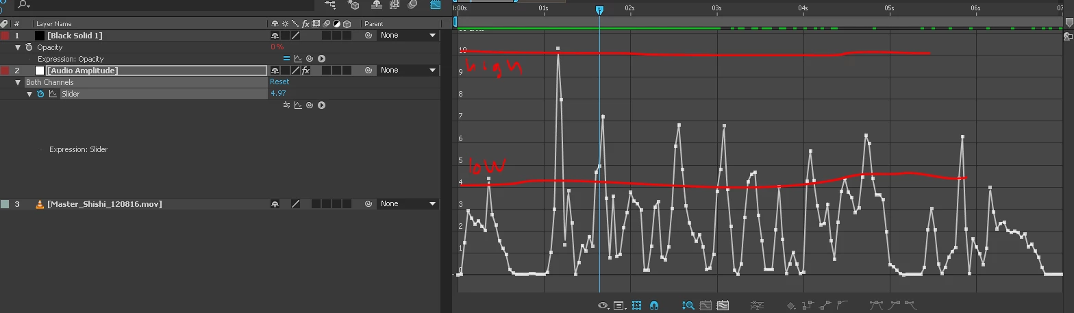

o.k but a warning: I am far from an expressions expert. here goes (hope this will translate nice for you!)
if you want to control the audio waveform amplitude you need to decide what is the low value for you and what is the high. you can do that with the graph editor. on the both channel parameter look at the value graph and decide what is for you the minimum and maximum.
for example my graph looks like this and I decide for myself for a threshold for the opacity
for example I want that if the value is higher than 4, my opacity will be 100%. and if it's lower - 0%
I need to select my opacity layer and create an if function expression on the opacity value that looks like this:
if(thisComp.layer("Audio Amplitude").effect("Both Channels")("Slider")>4) 100 else 0
see if that works for you!

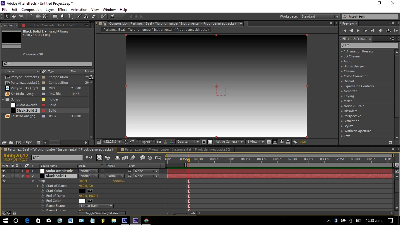

August 6, 2017
Hello, your post was extremely helpful for me too, but I want to do something similar but with the tool degraded, for when there is a high level the gradient comes up complete and when it does not come down, it will be that you can help me, sorry for the English I had translate it
