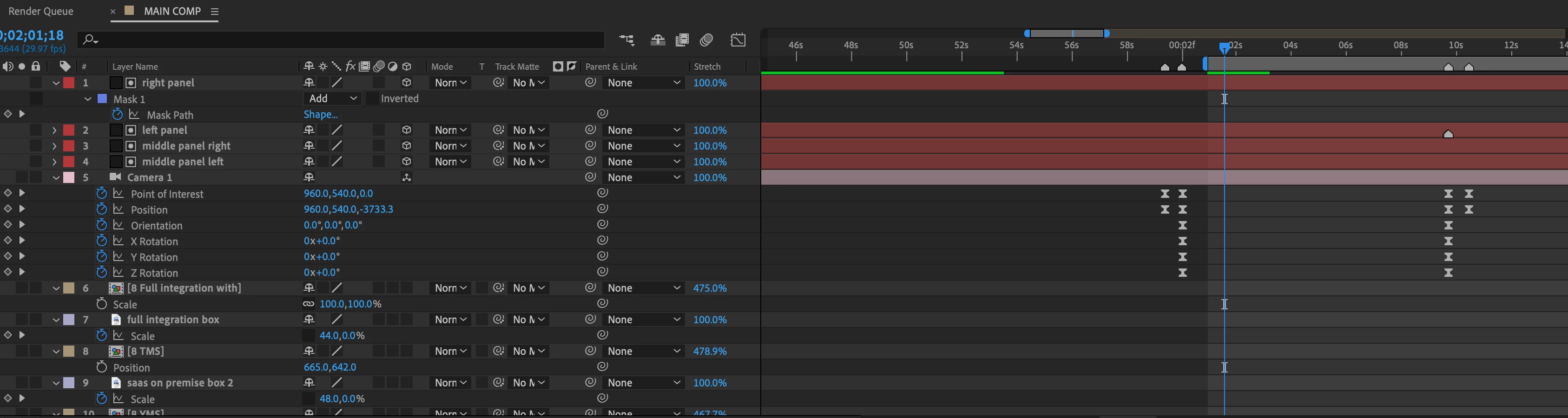

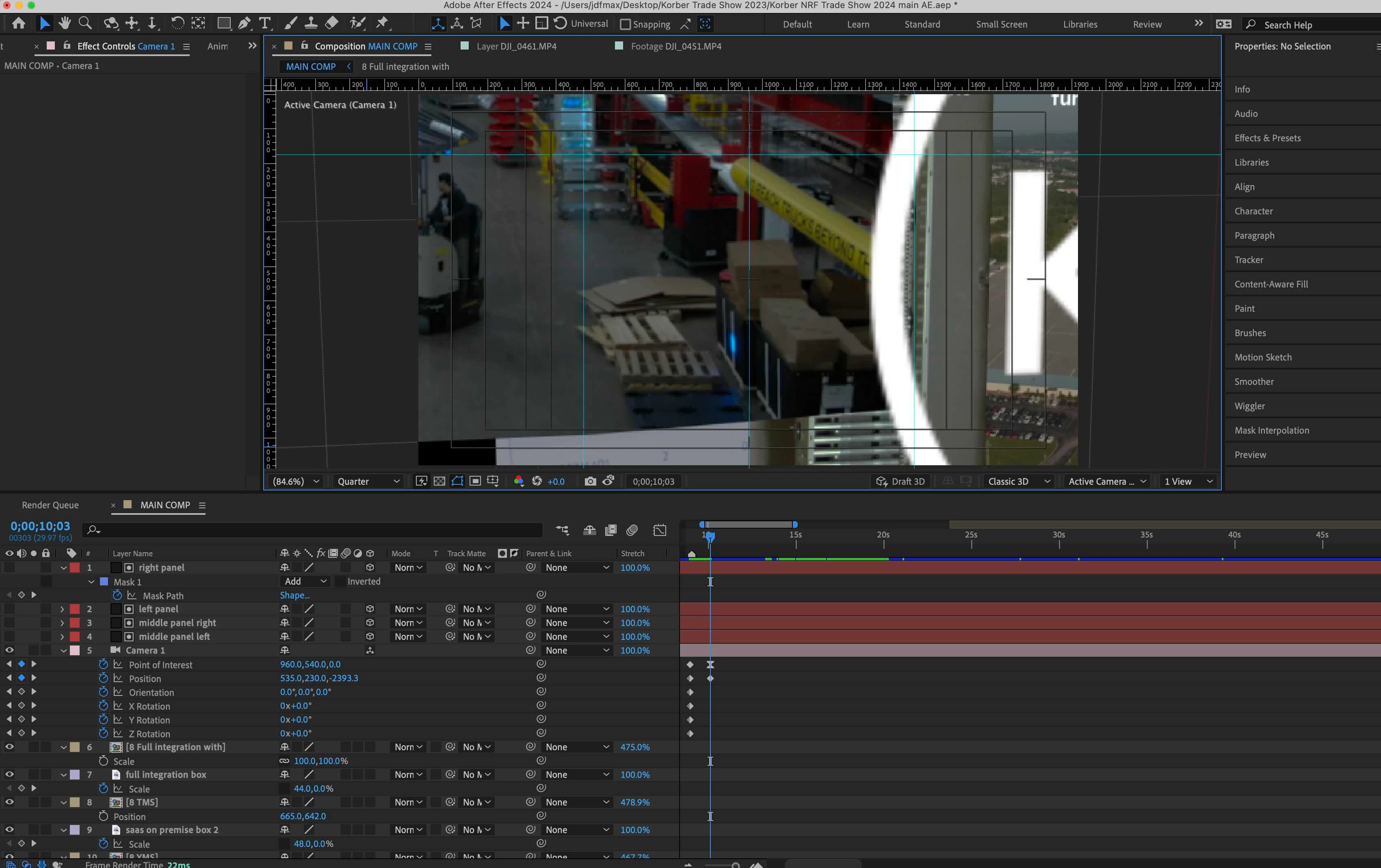

Ok i'm not sure how this is happening, I'm working on a (very tedious) after effects project and just about to be done... I am using 3d and the camera to move in and out of these frames that zoom in and out. The video is around 4 minutes long, and as I am finishing the section at 4 minutes with keyframes for the camera all along the way, suddenly the beginning looks way off... so I adjusted that but then later the positions were off, all with keyframes throughout for the camera...
Is there a reason the camera is changing perspecitve at the beginning of the video while i'm working on the end of the video? I thought keyframes were supposed to hold it in place right where it is? None of the other settings changed (field of view, orientation etc).
Would love some help, getting frustrated.
Some screenshots of how I have the camera keyframed and how it looks incorrect in the frame as well as what it's supposed to look like

The limitation is caused by the number of factors that start compounding in an effects timeline. It's not that you can't do a four-minute animation in AE in a single comp (or any other effects software). The problem comes when you need to change the middle 3 seconds of a four-minute timeline that could have two or three hundred layers that overlap in many ways.  The screenshots you uploaded (embedding makes them easier to see) don't show a very complex project, so we don't know what's happening in the rest of the project.
I'm not sure where your camera move got fouled up without seeing the project, but all it takes is a change somewhere in one parent's position, an expression, or a nested comp that was supposed to have Collapsed Transformations turned on.
I only see three nested comps. None of them are 3D layers, and CT is not turned on. I see a two-node camera in the timeline and four 3D layers used as Track Mattes.  It looks like there is a little camera movement in Z, and a camera moves from a little up and to the right of the comp center to the comp center. There's not much showing in the timeline that gives me any clues.
The camera orientation could have flipped somewhere. It might be more helpful to see multiple views with the Camera Path showing in the views. You are using a 2-Node camera, so weird things can happen if you point the camera straight down, but I don't see any weird camera moves in the screenshots.
