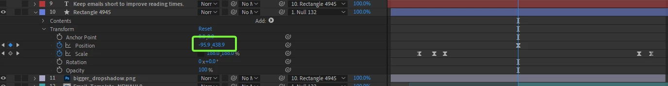

Here is the layer with playhead at first frame. Note position is -95.9, 514.9 and there's no keyframe there.

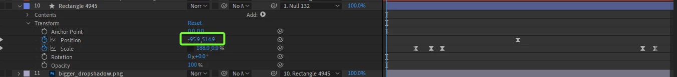

Here is the layer with playhead at 0:00:02:19, where there's a keyframe. Notice that now the position is now -95.9, 438.9
At the end of the animation, as in the first frame, there is no keyframe either, yet the Y position at this point changed and is now 515.1.

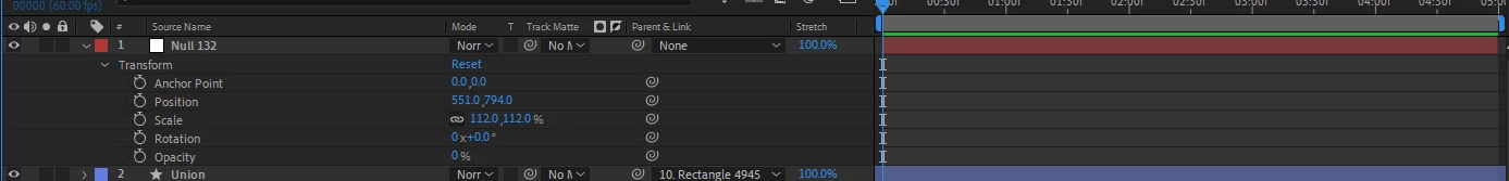

It did not escape me that Rectangle 4945 is linked to a parent layer - "Null 132". But I checked and Null 132 has no animations at all. I seleted Null 132 and hit the key U and nothing showed up. I expanded the Transform properties and I see no keyframes. So the vertical animation is not being brought in from a linked layer
I can't figure out how Rectangle 4945 is moving up and then down again with just one keyframe.
The epxression for Position is just the standard "transform.position"
