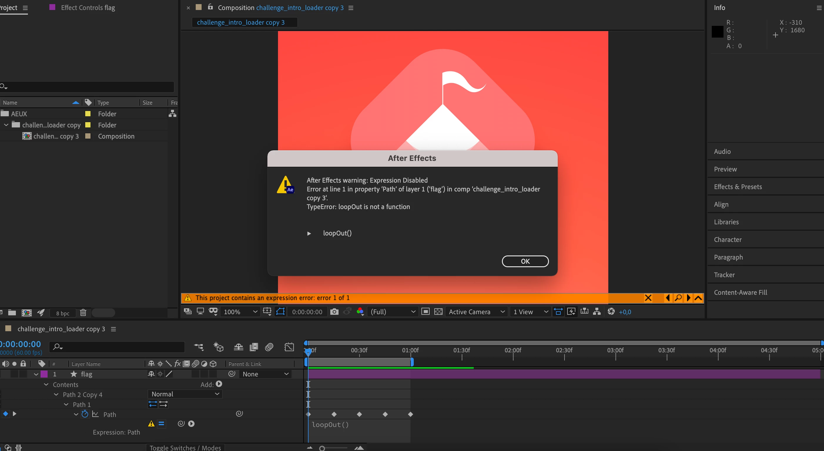

loopOut is not a function
When I use expression loopOut() I always see error "loopOut() is not a function". I tried to use different variants of syntaxes but it didn't help.
I saw some advices here but they didn't work too.
I use Mac OS Big Sur 11 and 17.6.0 After Effects

The loopOut() function works on properties that have a numeric value. The values can be in an array. Vector paths require a different approach.
The approach is to look at the number of keyframes and then use valueAtTime().
For a simple seamless loop, the first and last keyframes must be identical so copy the first keyframe and paste it at the end. This is the simplest approach to that problem:
valueAtTime(time % key(numKeys).time)

loopOut() doesn't work for paths. Try this workaround:
if (numKeys > 1 && time > key(numKeys).time){
  t1 = key(1).time;
  t2 = key(numKeys).time;
  span = t2 - t1;
  delta = time - t2;
  t = delta%span;
  valueAtTime(t1 + t);
}else
  value
