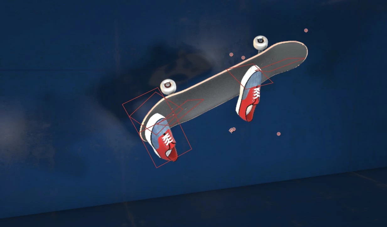

Yes screen shot here below
As you can see on first screen shot, the skateboard goes up and shoes too, which is fine, all null objects are linked.

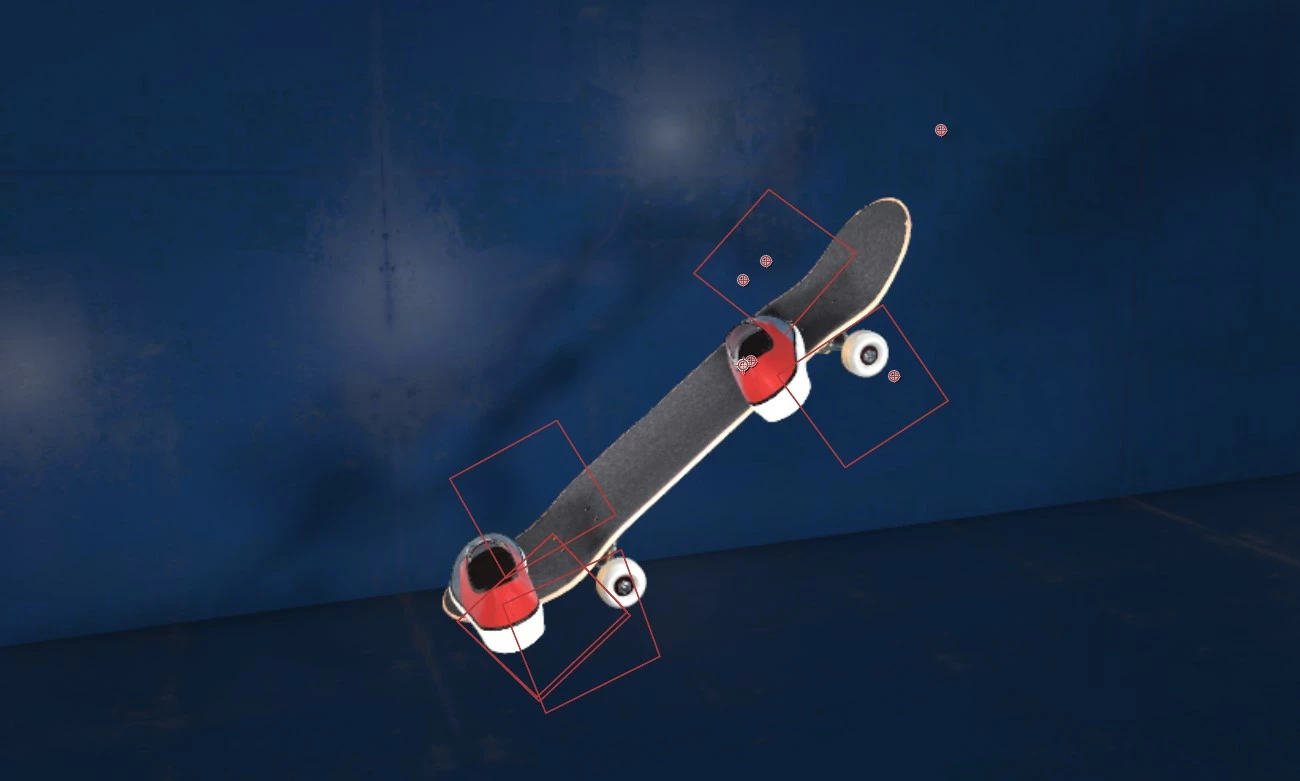

Second screen shot, the board rotates so everything else, I would like for the shoes ( and nulls ) not to rotate but only move up and down
March 3, 2020
I still don't see the timeline with the modified properties of the layers. Don't know which nulls control the shoes, how the shoes are created, but I assume that they are 3D objects in a 3rd party effect like element or that you are using C4D.
I also don't know how the skateboard is animated. It makes a difference.
If this were my project I would have done all the animation of the skateboard and the shoes in the 3D app. If you want to tie the movement of the shoes to the movement of the skateboard I would just use position and not parenting. Any suggestions I would make are going to be guesses unless I know exactly how you created this comp and animation. The easiest solution based on what I see is to split the layers with the shoes where you want them to leave the skateboard while it flips and just animates their position. If they need to go back to the skateboard then you'll need to also split the skateboard layer and link them back to the motion of the board.
