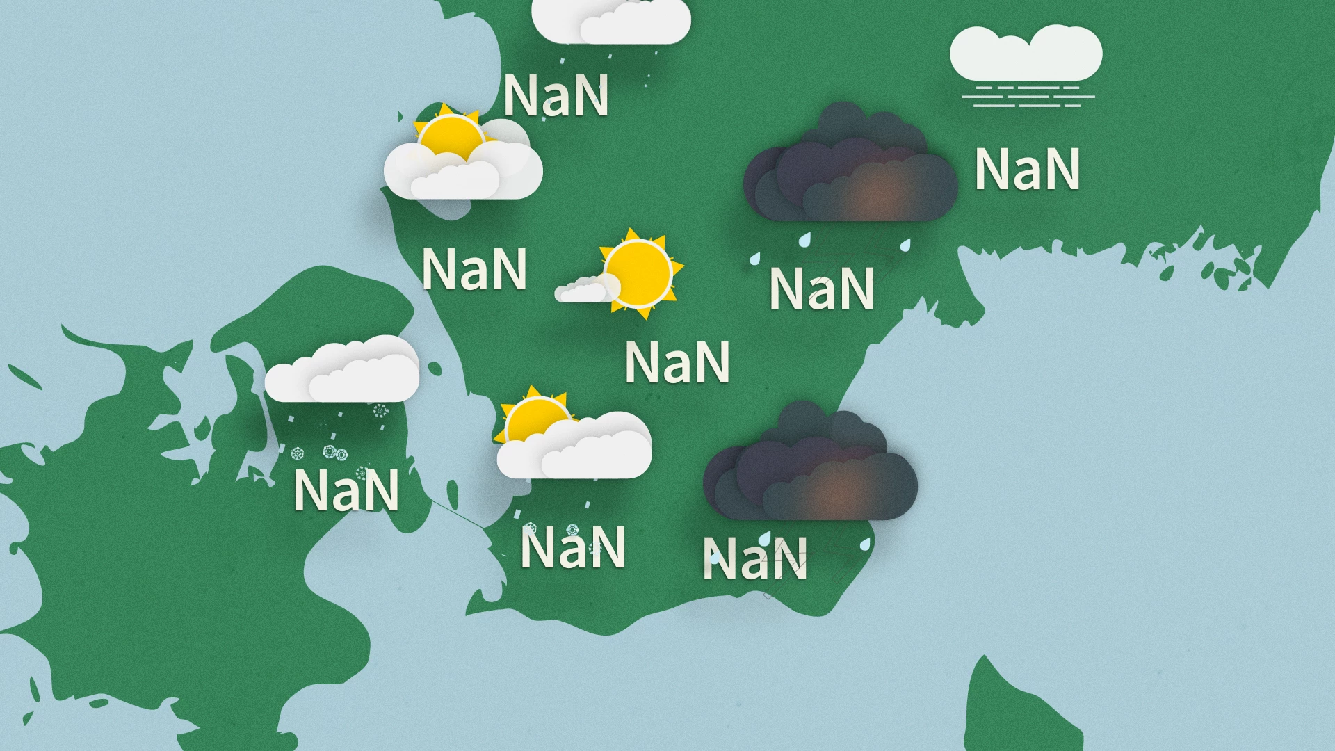

Hi.
I am making a weather-forecast-thingy. Was very happy with the new data-driven update. Until I tried rendering in media encoder. Where there is supposed to be temperatures, all I get is "NaN". When I render directly in AE it works like a charm.
I get my data from a .json-file. Linked the source text directly with expressions e.g. "Math.round(footage("weather.json").dataValue([2,5,0]))". Any ideas where and why things get wierd?
Correct answer konto4c31193966
I got it working. Seems like media encoder won't recognize the json-file if its only in the project-window. Although, if I use it as a layer anywhere in the project everything suddenly works. No need to re-adress any expressions or anything. Weird, but working.

konto4c31193966AuthorCorrect answer
April 23, 2018
ps. Thank you Mylenium for your answer. I got a whole automation-script going and the client needs their files as h264 so excluding media encoder ins't really an option. Unfortunately. Unless you have a great, not too mind bending, render mending, top notch, ultimate combo solution.

Without seeing the data and the expression it generates nobody can tell you much. that said, expressions always have been sensitive with AME, so if rendering directly from AE e.g. to an image sequence and then encoding later is an option, simply use this workflow. There's usually little point in trying to debug these issues and the rubbish JSON implementation clearly hasn't made anything in that regard easier.
