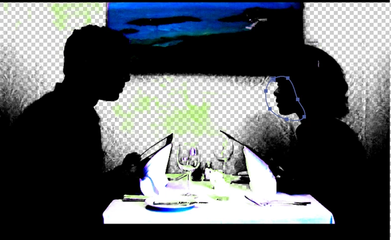

Letty2019Author
Oct 7, 2020 2:15 PM UTC
I copied your 'curves' and got pretty close to what you did.
I've got the black matte, and I made a mask that follows her face front only.
Now, I'm stuck.  I can't figure out  how to get this track mask to work?
Here I am:
