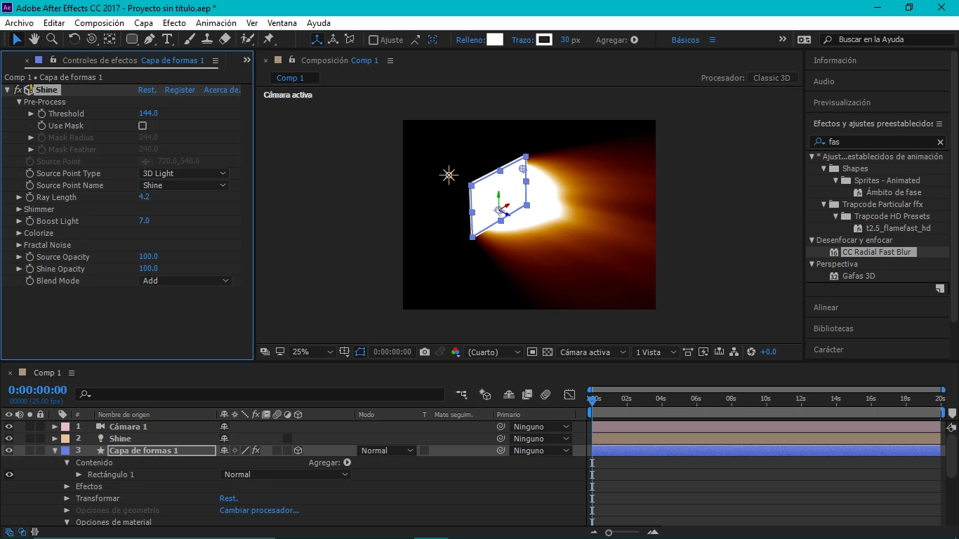

"Capa de formas 1" is the layer with the Shine effect. But now I have a question. (Hhahah, sorry, I have a long way to go in this world )
Is it possible to make this light to interact with objects on this 3D space without using an Adjustment layer?
On the video I shared, the guy made it work in a 3D object and with a normal video source. I'm testing the stuff now, but I can't get this to work without an adjustment layer. haha
Thank you so much again!
