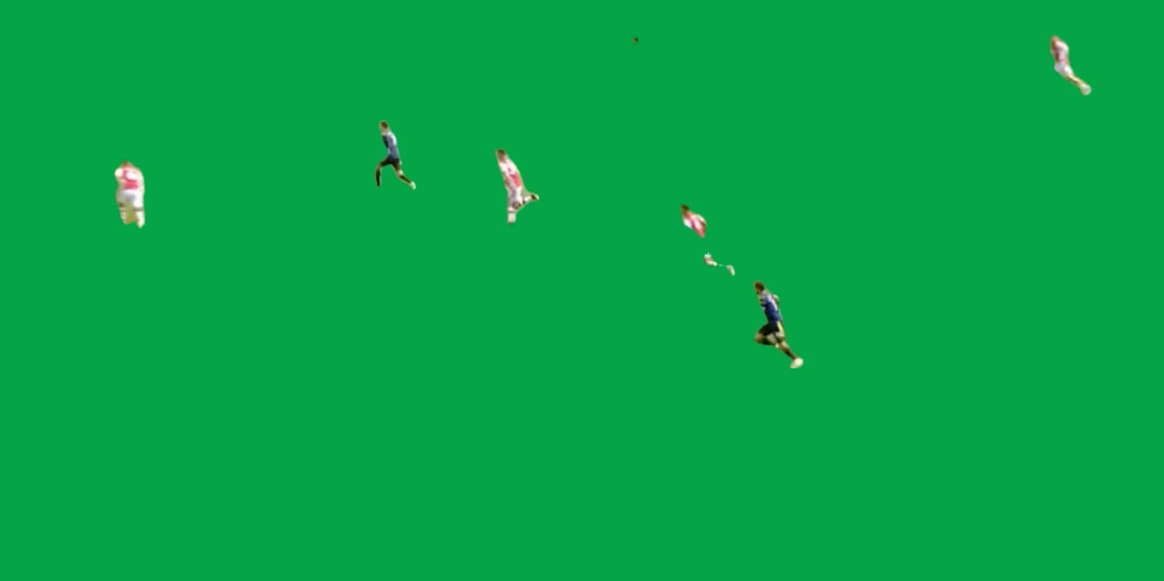

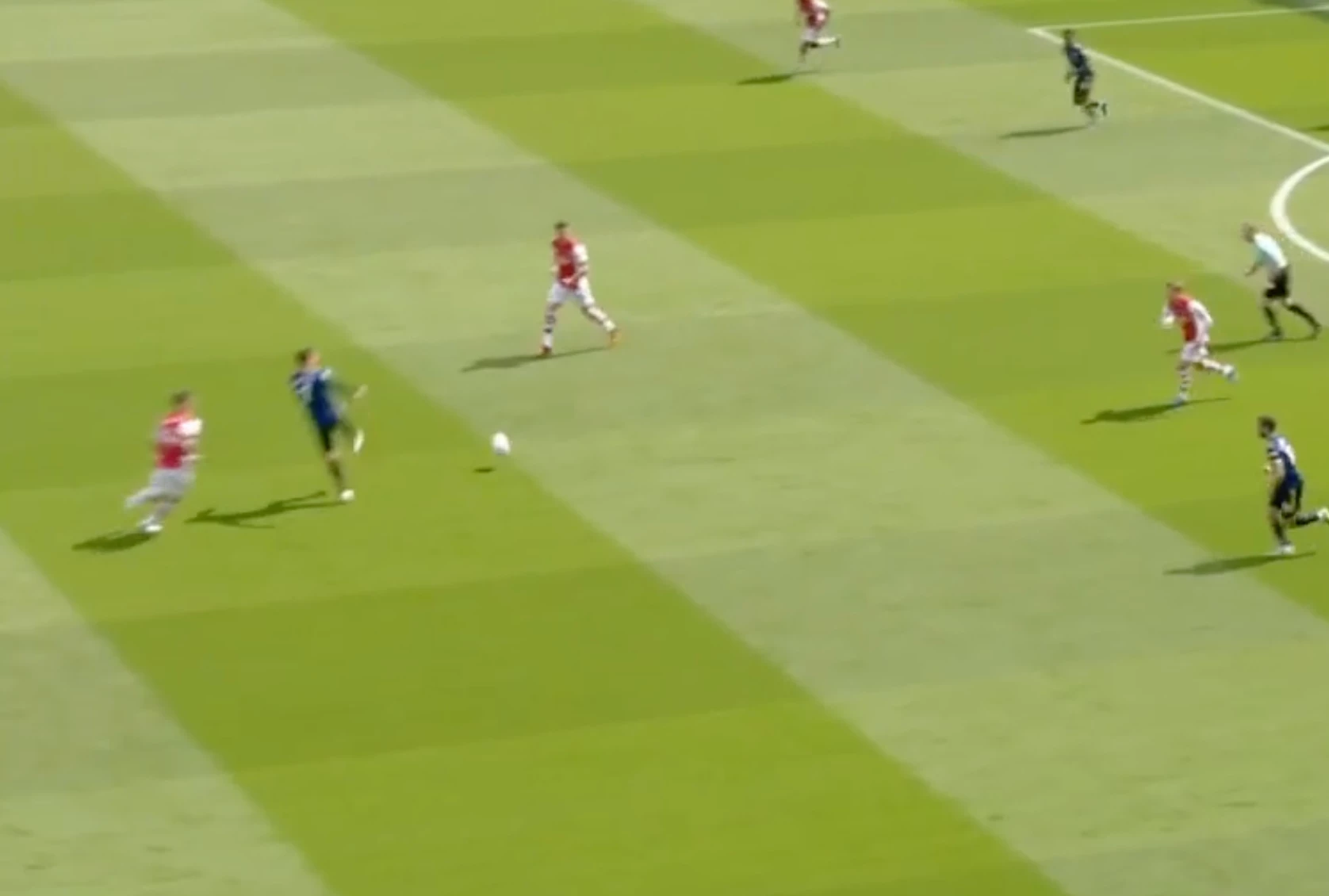

Hi this is what I am trying to Rotoscope.

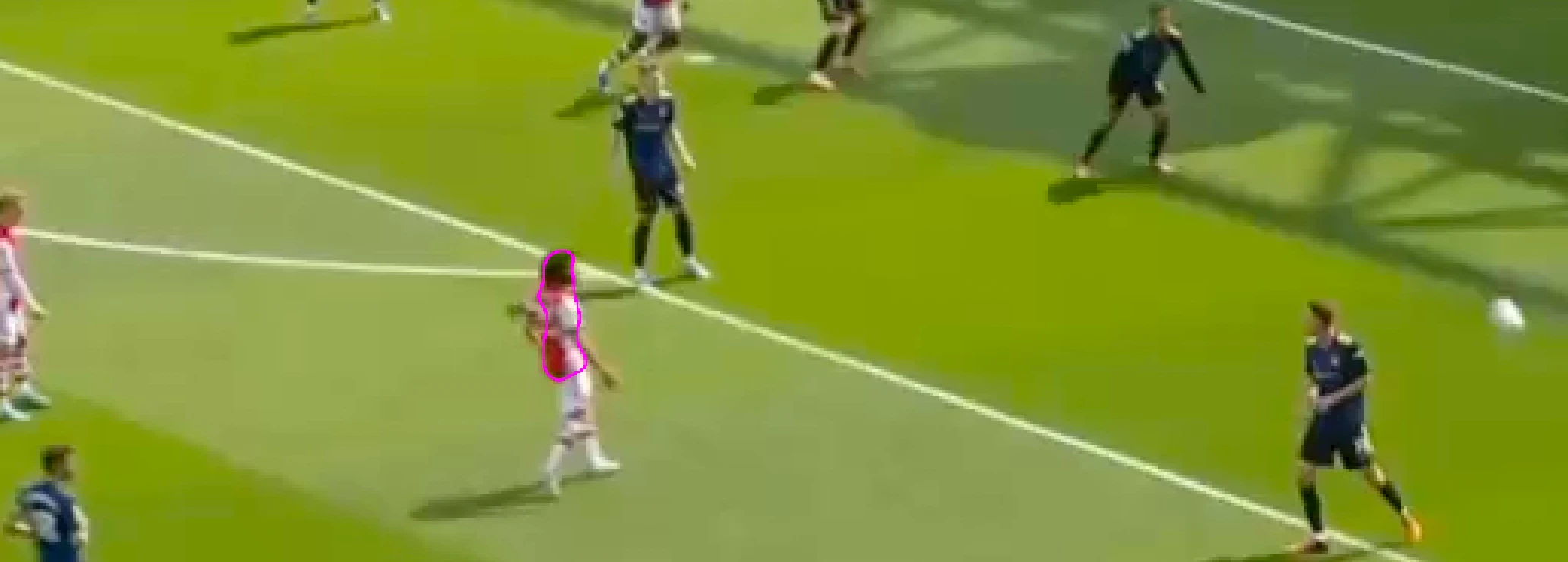

I am trying to rotoscope, but the quality of my footage is very low. I wonder whether I should just take it into Photoshop, edit the area I want to use, lower the opacity and make another layer and paint over it. Below you will see the attached images of the footage, the two different roto software and the image I wish to replicate. Doing it in Photoshop is achievable, even though it's a long process, I know it can be done, I just want to have only certain sections and would like to rotoscope it.
I used Runway ML as one attempt to rotoscope ( Green Screen) and it's an incredible software however I couldn't find a way to make my Roto mask finer and get the details of a cleaner rotoscope. And you cannot take that roto and put it into AE as it doesn't roto out on top of the edges you missed in Runway ML.
I also done an attempt in AE, which is better software for selecting but also has difficulties picking up the low-quality footage.
Is footage this low to difficult to Roto?

Pulling a clean matte from that footage will take a lot of work. You face extreme color compression artifacts, motion blur, low contrast, low saturation, color bleed on edges, and a few more problems. It will take multiple layers with multiple effects and some hand Roto (masking) to generate a usable matte.
Quality rotoscoping in Photoshop, even with great footage, is extremely difficult. If you only want to isolate one or two players, I suggest using Mocha AE to rotoscope the player. You can speed up the process with Translation (movement) tracking on the player, then use the Paper Doll method of animating multiple masks for each player. You'll get better results with less chatter than Photoshop's masking tools can produce on multiple frames. You might be able to pull a matte from one frame fairly quickly in Photoshop, but the edges on the consecutive frames will have almost no chance of matching, and you'll end up with a lot of edge chatter.
You will probably end up with many layers you will need to combine to create a usable matte. I do a fair amount of this type of Procedural Matte workflow, and it almost always takes combining four or five layers with different color, blur, and channel effects to create a clean matte. The goal is to create a clean black and white layer you can use as an Alpha source with Set Matte or a Luma Track Matte.

Ok this is another interesting option. I believe there was a series Boris created that covers this. I have Boris sapphire, I'm guessing the built in AE mocha is enough, let's say I do multiple layers and get to the point of black and white, would I do the painting and colourising in AE?
Mylenium
August 22, 2022
This is nothing I would use Rotobrush on at all nor is it necessary to employ convoluted manual masking. All the info you need is there and can be extracted using channel operations and adjustments. It may just take multiple passes to get a good combined matte. E.g. the dark blue parts of the clothing can simply be extracted based on luminance and so can the reds and whites. Effects like Channel Combiner, Shift Channels, Levels and Curves are your friends. You just need to employ them strategically and play around with their order and settings, pre-compose a bunch of duplicates and then combien everything. The only manual masking you're likely going to need is the edges of the field and of course slight corrections on individual segments. It's still going to be some work, but definitelky better than trying to fix a botched RB or manually creating cutouts in PS.

Ok understood, this sounds far more time effective. I'm guessing adding a blur and some sort of effect which creates the painted look will be necessary. That's the only part I'm not sure if adjustments will give it that animated brush stroke motion piece.
