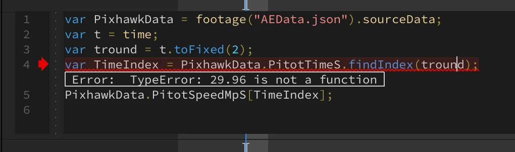

Hello, I am trying to write an expression to read in a data file from a flight controller (Pixhawk) with time stamps for different points of data. The format of the JSON is shown below with there being time data (PitotTimeS) and speed data (PitotSpeedMpS). The expression I have written will not work and gives me the error shown in the last image. The issue is I cannot simply frame through the data without refferencing the specific time it was recorded if I want everything to align properly. In addition, I have other sensors running at different rates and will need those aligned as well (if this indexed time method works that would be fine!). I am also open to formatting this in any other way that might work if there are reccomendations!
Thanks!
var PixhawkData = footage("AEData.json").sourceData;
var t = time;
var tround = t.toFixed(2);
var TimeIndex = PixhawkData.PitotTimeS.findIndex(tround);
PixhawkData.PitotSpeedMpS[TimeIndex];

Try it this way:
function getIndex(element){
  return element >= time;
var t = time;
var TimeIndex = PixhawkData.PitotTimeS.findIndex(getIndex);
if (PixhawkData.PitotTimeS > time && TimeIndex > 0) TimeIndex--;

Try it this way:
var t = time;

Indices need to be plain integers. You have to use Math.round(), not toFixed(). Probably doesn't realyl make a lot of sense in your case, though, since no doubt there will be fractional frames, so may be actually timeToFrames() is the answer. Impossible to tell, since you haven't provided any example of the actual data.
