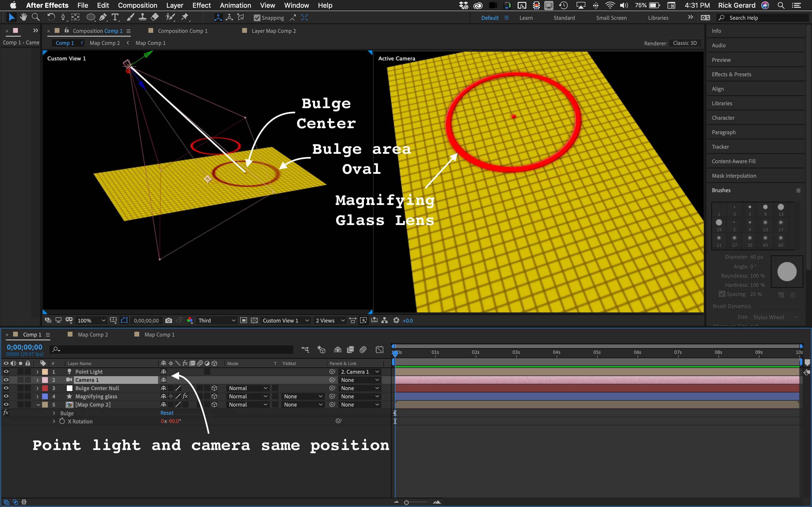

Here's an illustration of the problems involved when the Magnifying glass is above the Map and you need to animate the displacement.
I set up a Point light with zero shadow diffusion and Shift + parented it to the camera so the projection would line up. I set the Magnifying glass layer (red circle) to cast a shadow and have 100% light transmission so the shadow would fall accurately on the Map layer (the grid).
If this was my project I would set up Freeform Pro and use the same projection technique to distort under the magnifying glass. Here is a tutorial on how to do that. Too bad you can't do that with the Magnify Effect.
