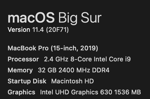

I've also encountered this same issue and have not been able to get it to work.
I've tried installing the VC plugin from the customer portal, when trying to use the plugin I still get the spinning beachball of death.
Have you been able to sort through this issue?
