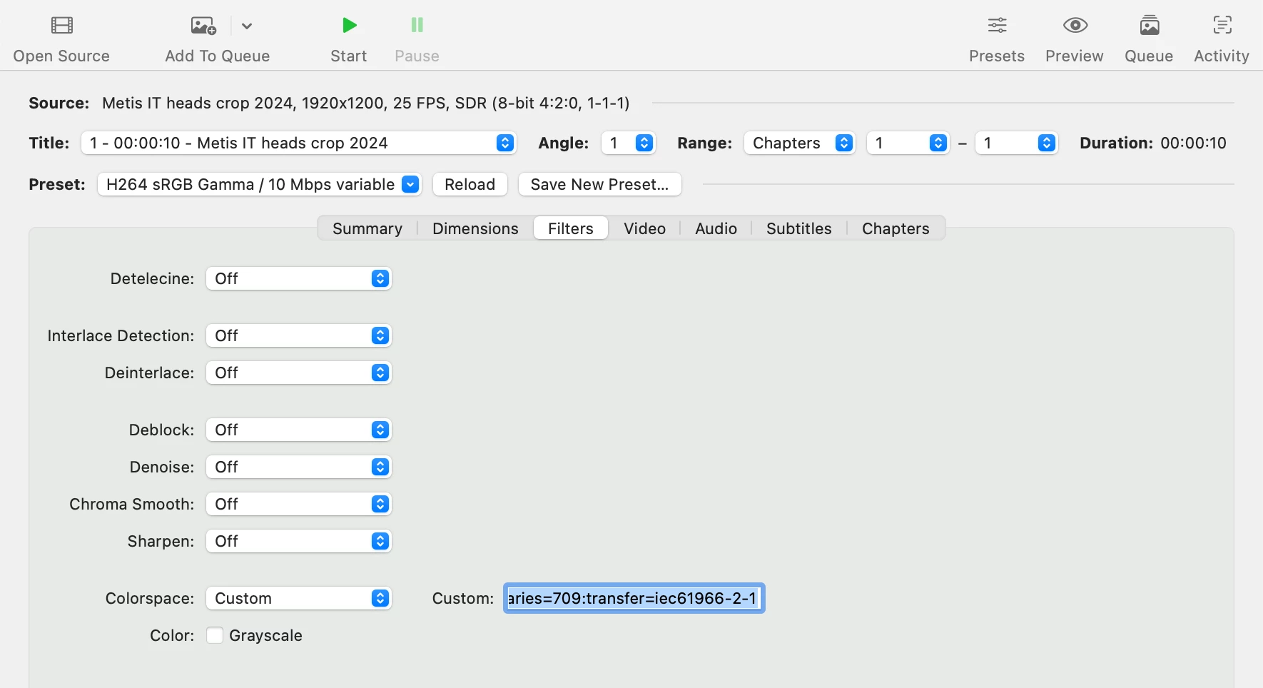

None of the solutions offered here work for me. Using the QT Gamma Compensation Cube  LUT makes the video look better in Quicktime, but seems to actually change the RGB values, and I personally prefer to render directly in After Effects.
What seems to be the most convenient and consistent solution across players, is to use HandBrake.
Export your sRGB H264 video directly from After Effects (project settings: sRGB) no Media Encoder
In Handbrake choose Filters › ColorSpace › Custom:primaries=709:transfer=iec61966-2-1
This makes sets the color profile bits to 65514-13-1 instead of 1-1-1 and my video renders with the right colors in Quicktime, Chrome and Safari (sadly it still looks washed out in Firefox).
There is a slight hue shift in VLC — anyone know where this comes from?

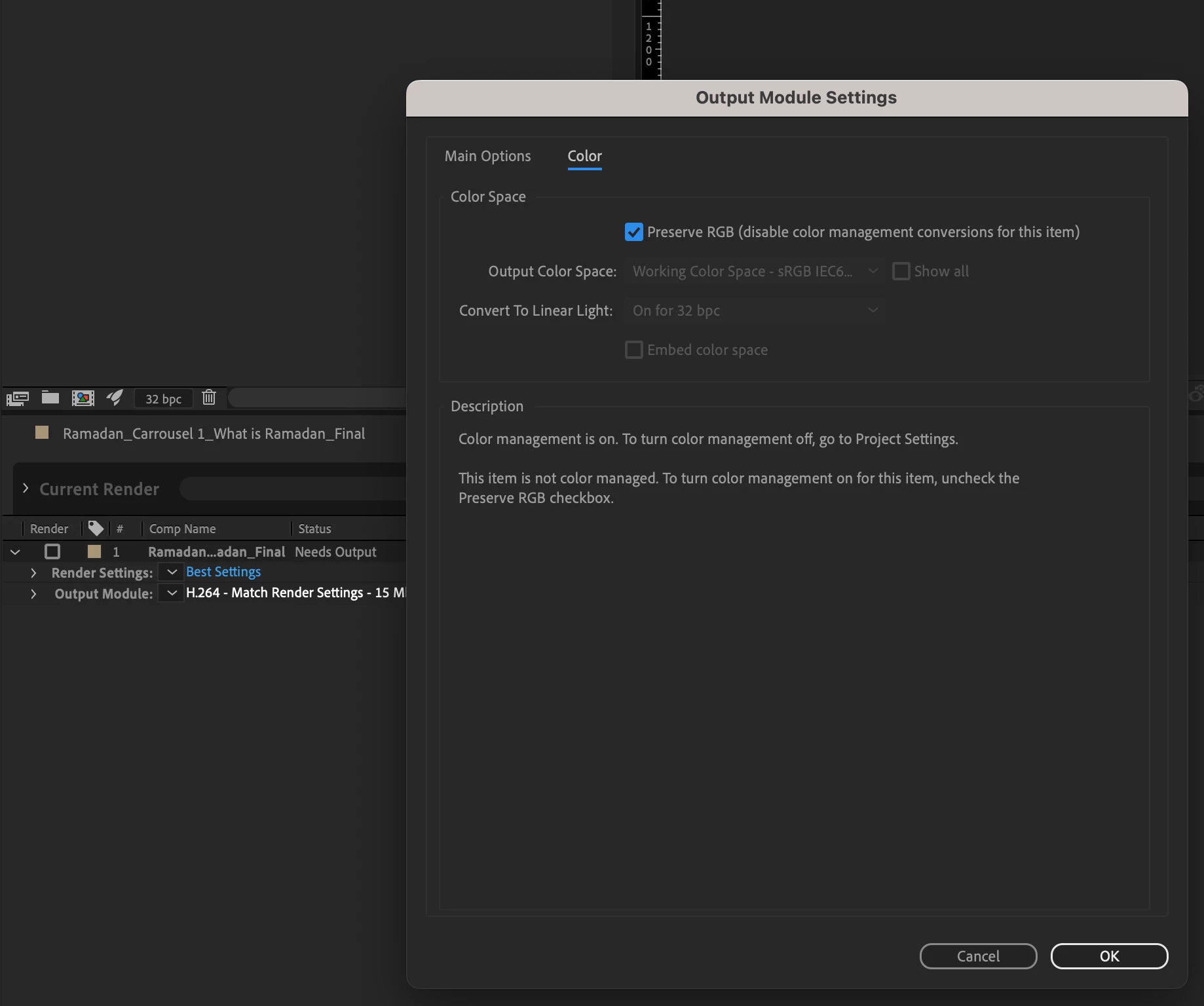

My coworker found this fix, and it worked for me! You have to select 'Preserve RGB' in the render queue before exporting via Media Encoder. Tried it out and no washout!
May 3, 2023 8:07 PM UTC
This is undoubtedly the right answer to this problem. Works perfectly for me and should be so much easier to apply (maybe already is) on Media Encoder.

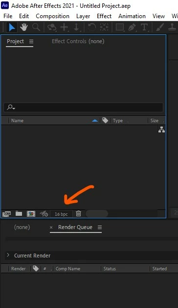

Hi everyone! If you still have this issue on mac, just try to switch "Working color space" in project settings to Apple RGB. This solved my "washed colors" render problem
Feb 4, 2024 4:31 AM UTC
I tried different solutions described here, It's the only one that works! Thanks!!

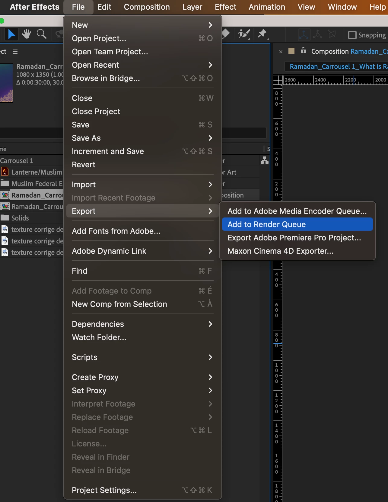

1. Export the after effect without media encoder, with the normal encoder that comes with AE, as a MOV file.
2. You can convert the mov file with media encoder into a MP4 format if you wish (both files will have the correct same colour correction) - just drag and drop the MOV file into media encoder

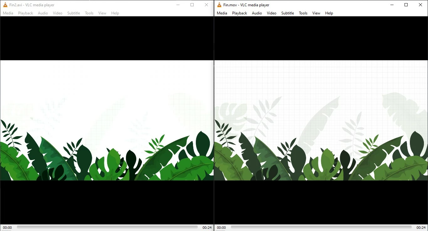

Wrote few words about how i solved different colors issue AI - AE - Shapes and after render with the help of Adobe Bridge (synchronized colors among all adobe application) and color profile "None" in After Effects: https://community.adobe.com/t5/after-effects-discussions/washed-out-colors-while-import-from-ai-using-overlord-and-after-render-in-after-effects/m-p/13404166#M218259
Dec 8, 2022 4:31 AM UTC
For me results are opposite: When render with sRGB color profile - colors are saturated in AE but washed out after render. When render with None color profile - colors are more saturated after render. So I use my own solution - work in AE with sRGB color profile but before render i set it to "None" and then render video.

Pretty simple, just change from the profile you find on AE(check images) and set it to 'None'. That should fix the washout.
georgem31572463
Nov 17, 2022 2:07 PM UTC
ignore the avi/mov difference
