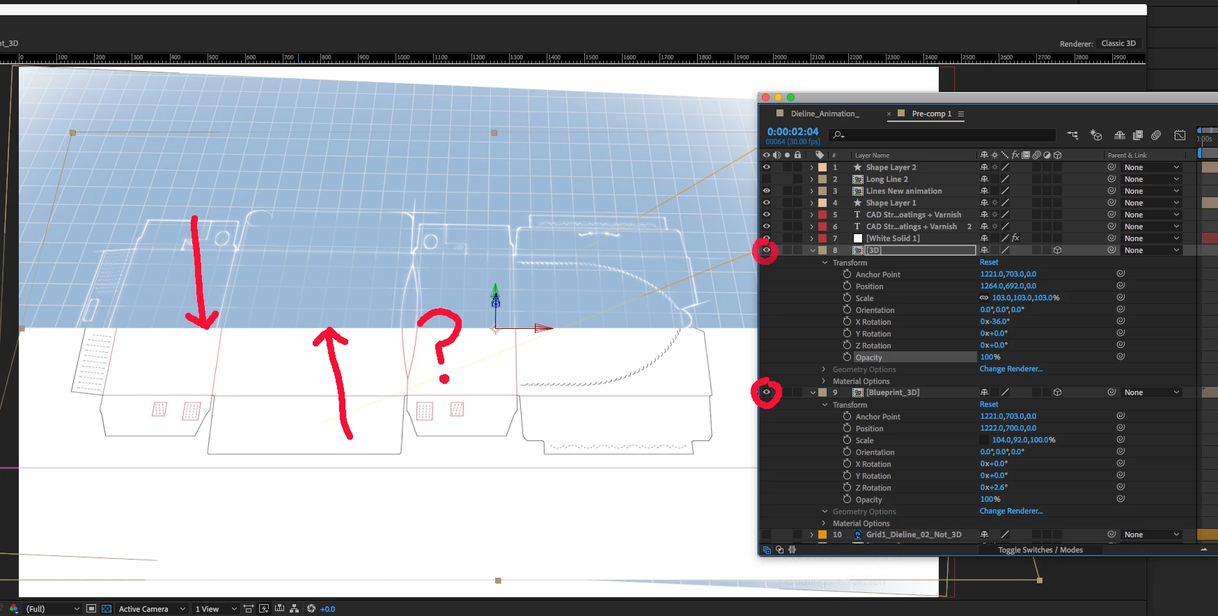

Working in 3D space - my image is split in two for some reason....
  • April 26, 2021
  • 1329 views
Screenshots:
Whiteprint Visible - White layer okay
Blueprint Visible - Blueprint layer okay
Both Visible - looks like it 'splits'
My guess is that it has something to do with the die line image being in 3D space...

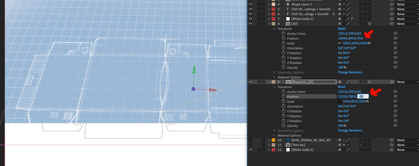

When you stack up 3D layers is a really good idea to offset the layers by 1 pixel in Z before you move them. You can do this with the anchor point or the position property. You should also parent all stacked layers if you intend to move them together. Parenting also makes the Z offset easier to figure out.
April 26, 2021
This is called "Z-Fighting" and it's very easy to fix. The problem is occuring because both layers are occupying the exact same spot in 3D space and they're intersecting. Just push the zPosition of your whiteprint layer 1 pixel forward and you'll see it properly sit on top of the blueprint layer. If it disappears completely, then adjust the zPosition in the opposite direction (+1 instead of -1).

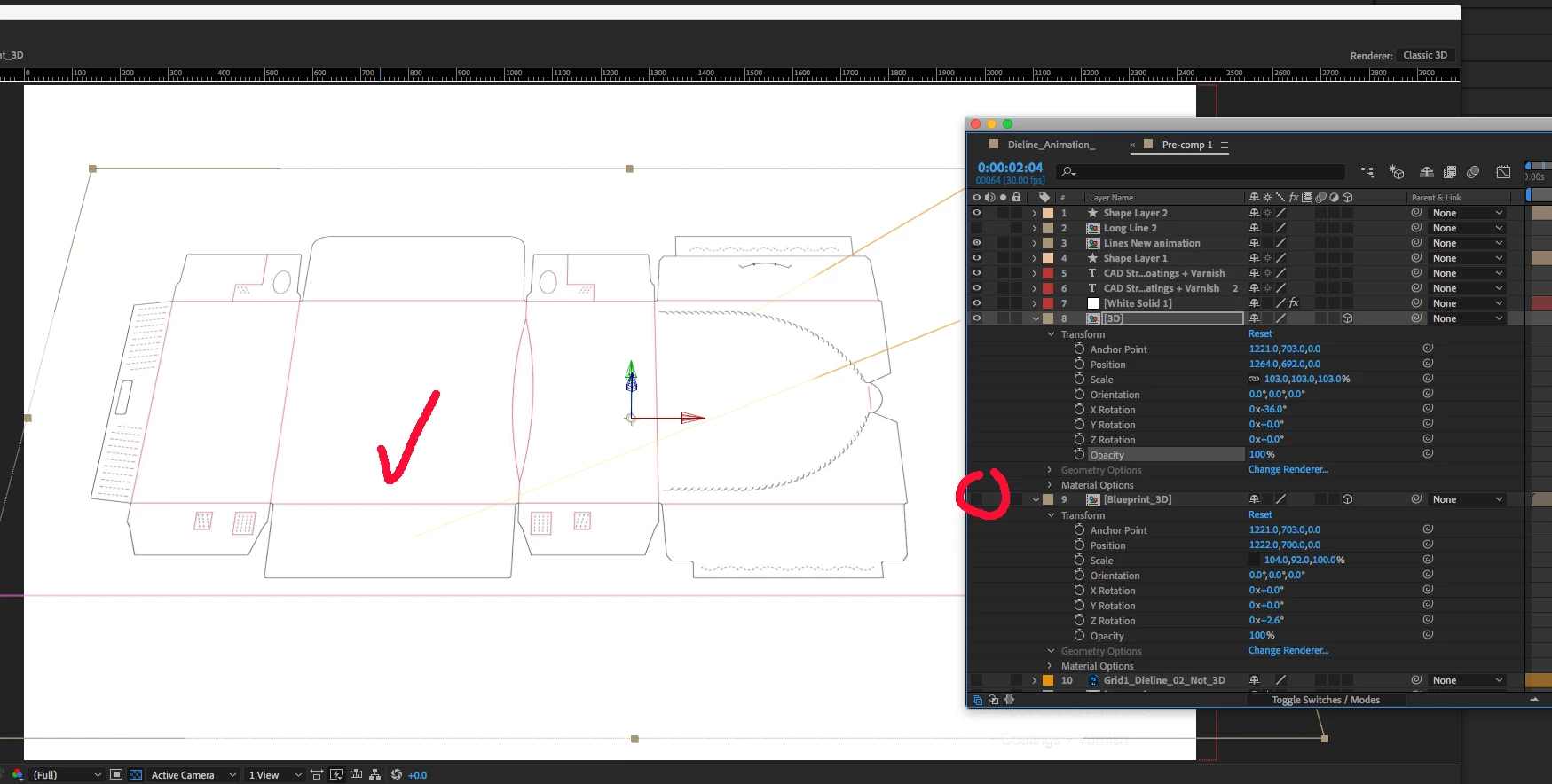

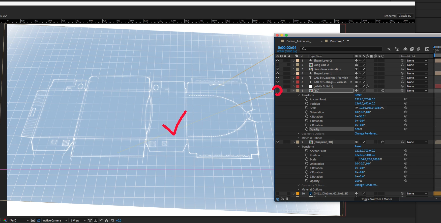

No problem. Instead of adjusting your Z Orientation or Z Rotation like you have in the screenshot, adjust the third value of your Position parameter. That's a x,y,z array, so you just need to change the value of "0" to "1" or "-1".
I changed the values, and it seemed to change the problem, but not solve it...
