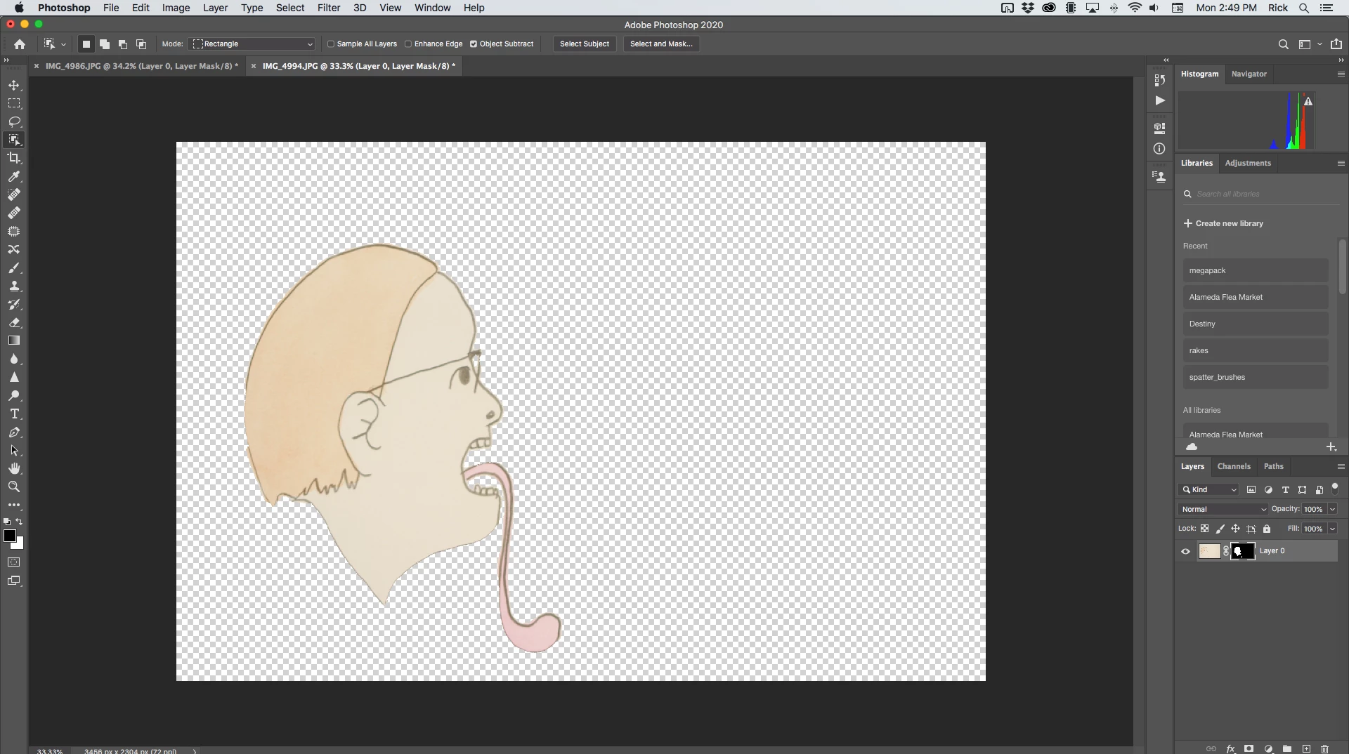

Your drawings need better-defined edges and no gaps in the important lines. From your two images, I was able to get these two masks in Photoshop in under a minute an image by using the Select and Mask tool. They are pretty close. You can easily create a Photoshop action that loads the next image and opens the tool. A couple of clicks and then a save and close action and you are on to the next image. That's the best I can recommend with this artwork.
You might also have some better luck if you use Lightroom to increase the contrast of the outlines and maybe increase saturation so that the Select and mask took has more information to work with.
A few more minutes with each image would improve the result. Both screenshots are the first pass at creating the mask.
