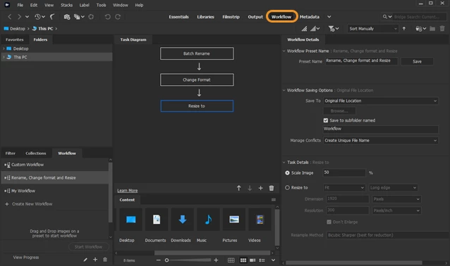

2. In searching for this, I found Workflow. I figured out how to set up a workflow and it worked fine. But I wanted to change one parameter but I couldn't edit it! There is no optoin to do that. Not even the menu's little pencil worked.
3. So, I created a new one, but it would not let me add ANY parameters! A tiny gray "menu" popped up but I couldn't click on it!

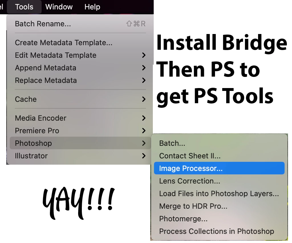

Correct answer jdawgdesign
The SOLUTION:
Uninstall Bridge and PS
Reinstall Bridge FIRST
Reinstall PS SECOND
When it asked to keep Preferences I decided not to.
Hopefully this will help someone else having this issue.

jdawgdesignAuthorCorrect answer
February 13, 2022
The SOLUTION:
Reinstall PS SECOND

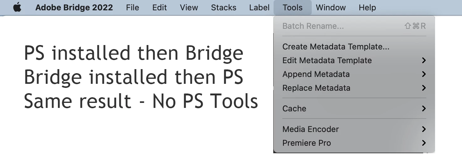

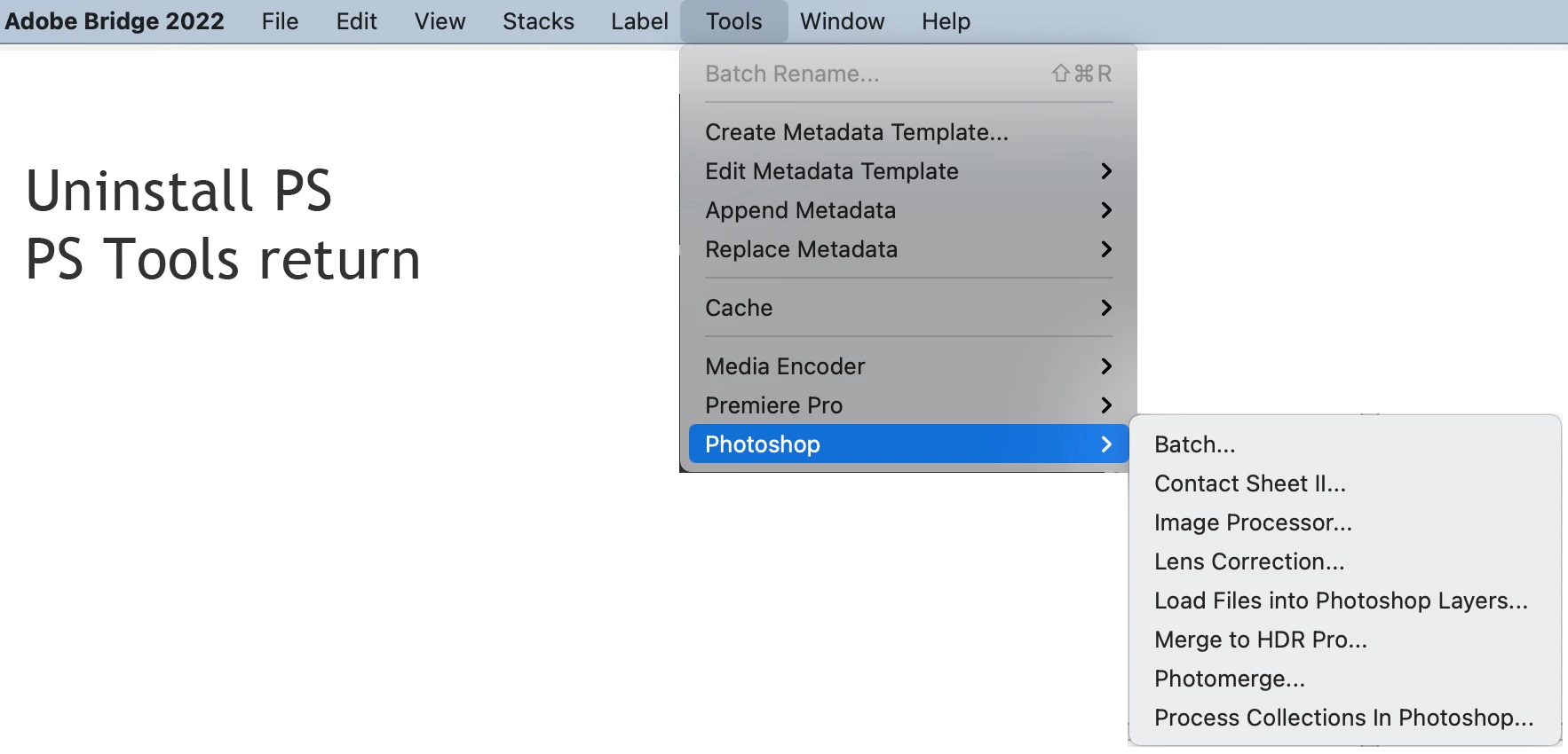

I still do not have access to PS>Image processor under Tools in Bridge.
I have uninstalled PS and Bridge. Reinstalled in order as suggested PS then Bridge. It did not work
Interesting thing though, I uninstalled PS and opened Bridge and the Tools were there!! See image PS uninstalled.
So I reinsatlled PS and guess what? The Tools disappeared again!! See image no Tools with PS.
Thanks in advance for any suggestions.

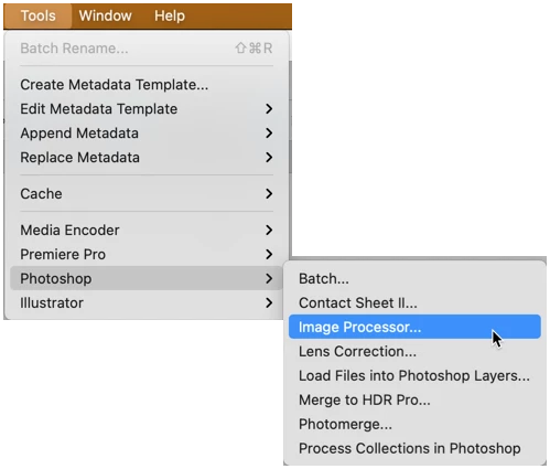

Are you talking about this?
If so, if a Bridge update was installed AFTER the PS update, it might not appear because when PS is installed, it places the script to show up in Bridge, Bridge does not automatically provide that script.
If this is the case, uninstall PS and Bridge, then install Bridge, THEN PS.
          [Note: this was fixed from what I originally wrote where I had the reinstall instructions backwards.]
See if that works the problem out.

Hi @jdawgdesign
Thanks for your feedback.
For point 1, please try the approach suggested by @Erik Bloodaxe
For point 2, please try switching to the Workflow workspace from the application bar on the top. You can also switch to the Workflow workspace by navigating to Windows Workspace Workflow
More information on the Workflow Builder can be found at Workflow Builder (adobe.com)

February 6, 2022
For point 1, have you looked in Tools>Photoshop>Batch... or Tools>Photoshop>Image Processor...?
