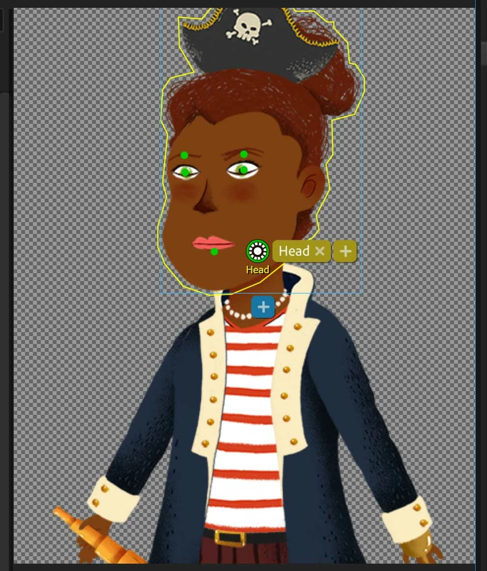

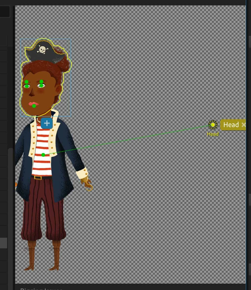

Below is an example. I took this puppet and cropped out the empty space. As you can see, the program has misplaced the center point of the head. But in the second image, I've dragged that point back to where it's supposed to be on top of the neck. That's usually all that's necessary to put things to rights. Of course, you will need to readjust every part of the puppet, so changing the overall proportions is something you don't want to do too often.
