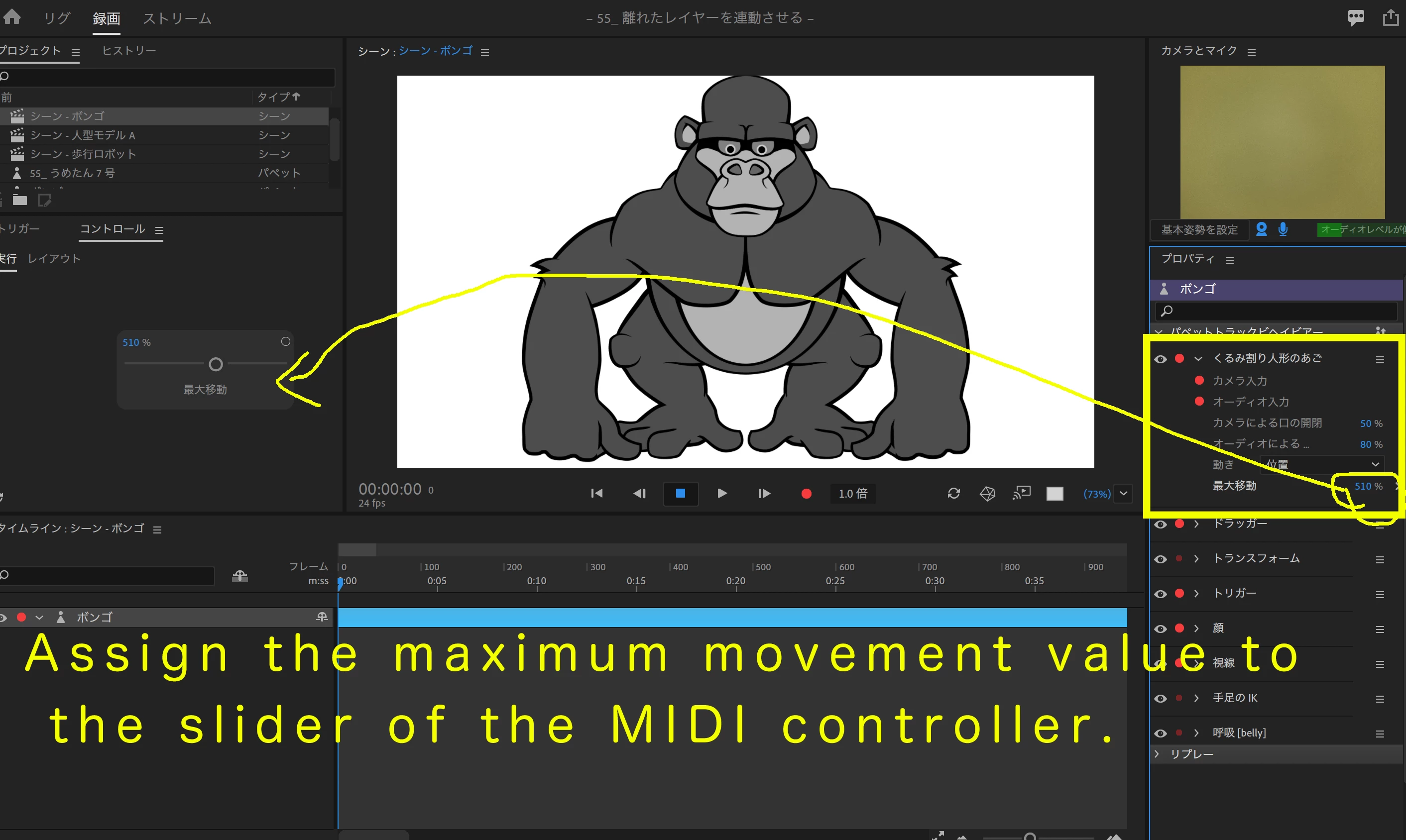

Unfortunately, the current Adobe Character Animator does not support MIDI velocity.
The solution is
1 Assign the maximum movement value of "Nutcracker Jaw" to the controller.
2 Assign it to the slider of the MIDI controller(Example: Pitch bend wheel
Modulation wheel).
3 You can adjust the opening degree of the mouth with the value of the slider.
Thank you.

Thank you so much, @k_oshiro !  I did not realize that velocity was not supported.  That's unfortunate, but I'll put in a feature request.  That's a good trick using the slider to control maximum movement of the nutcracker jaw.  I'm borrowing a MIDI device today, so I'll see if this could work for now.
