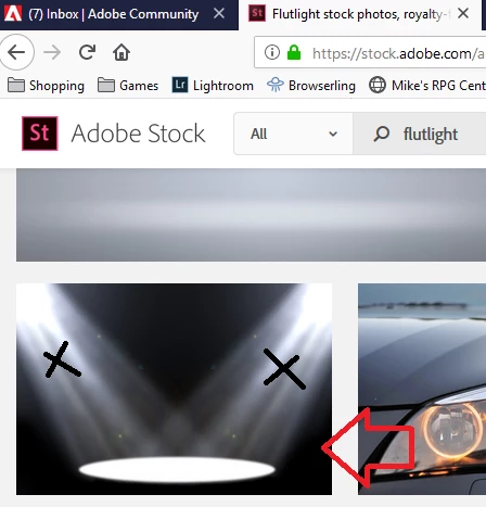

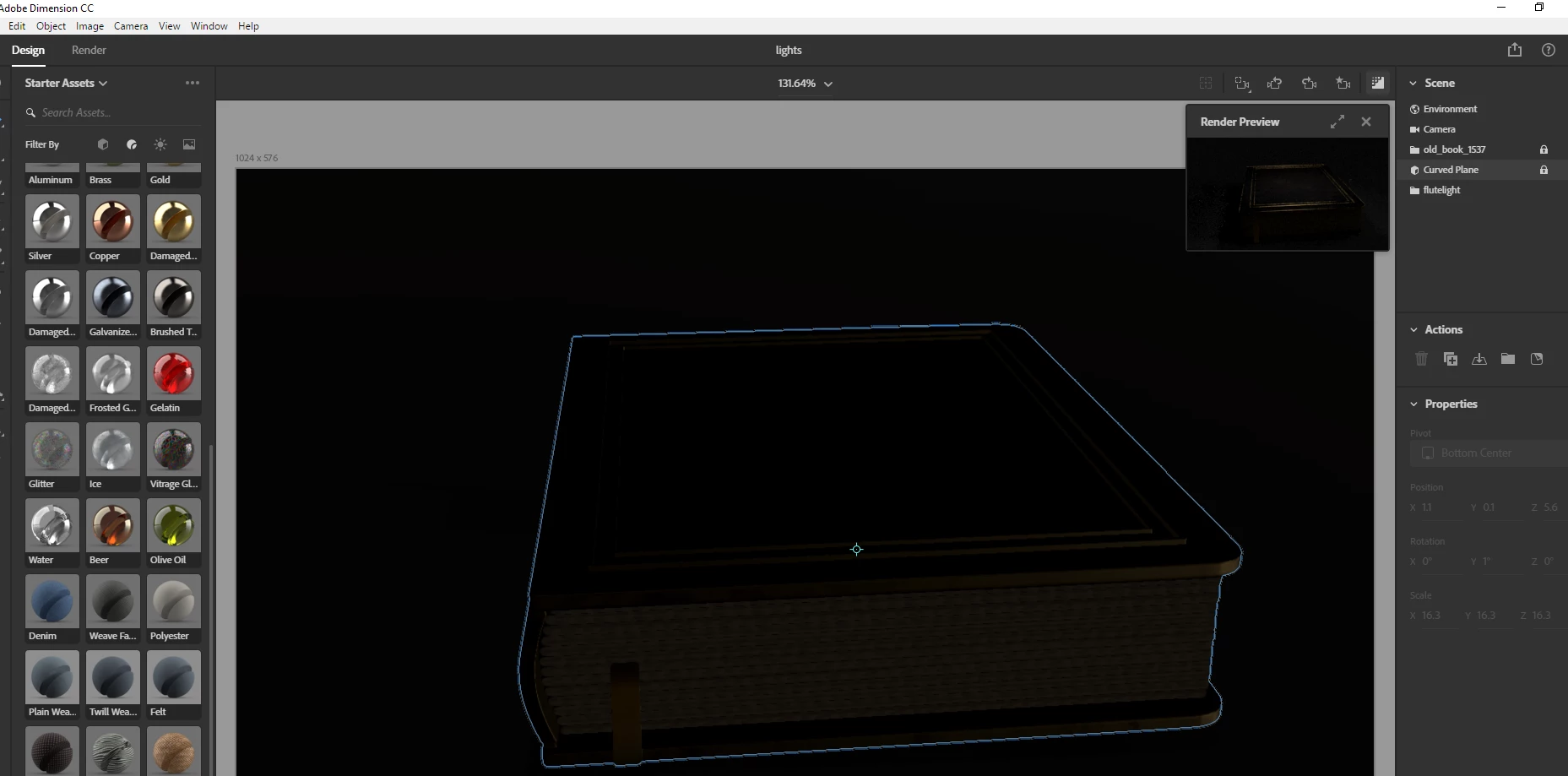

    ok you want a dark room with one light?
    spotlight = soft edge
    flutelight = hard edge
    what i would do first is open Adobe stock and search for spotlight, flutelight or perhaps dark room + spotlight... the point is to see how much variety you get
    then I would look at the model, is it small or large, does it have texture or is it smooth and what mood am I hoping to make i.e, dramatic, relax or mystery?
    sunlight 100%, spotlight 200% and 500%
    8 replies

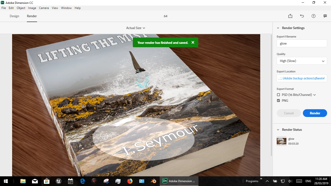

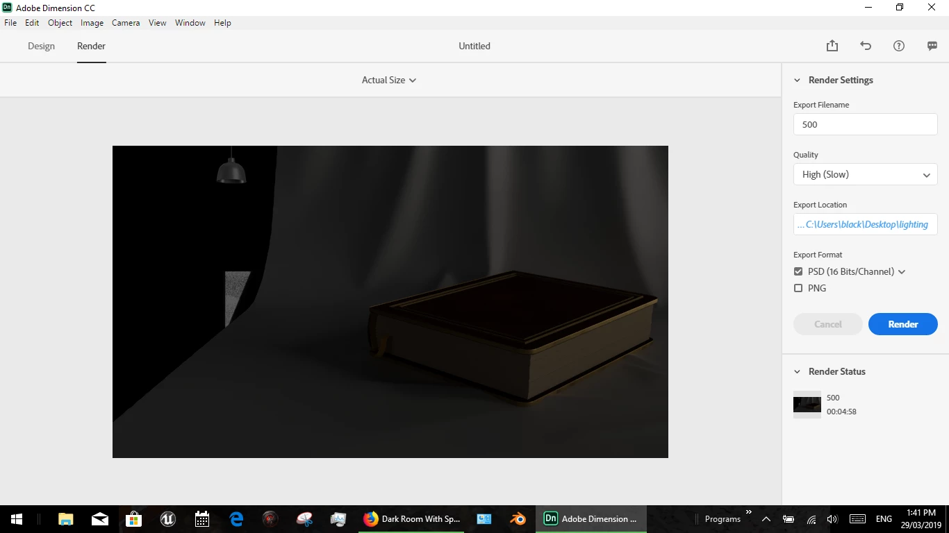

    Ussnorway7605025
    Mar 29, 2019 7:41 AM UTC

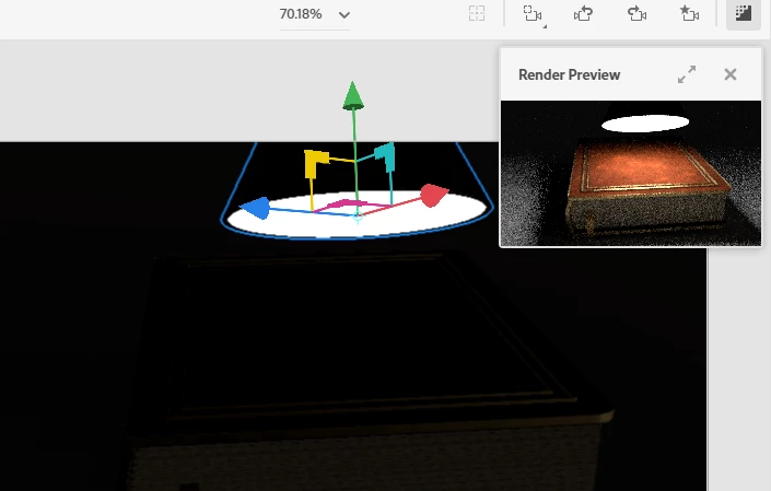

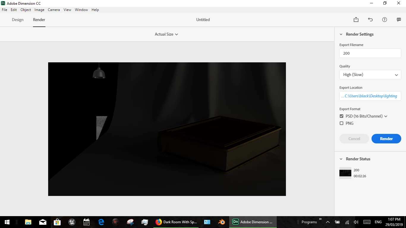

    for bright glow light add some barn doors, I used a pipe
    p.s, I switched to my Ryzen for this one... notice how much better the rendor preview window does at showing a true example of the light then my intel powered laptop did in the basic glow light

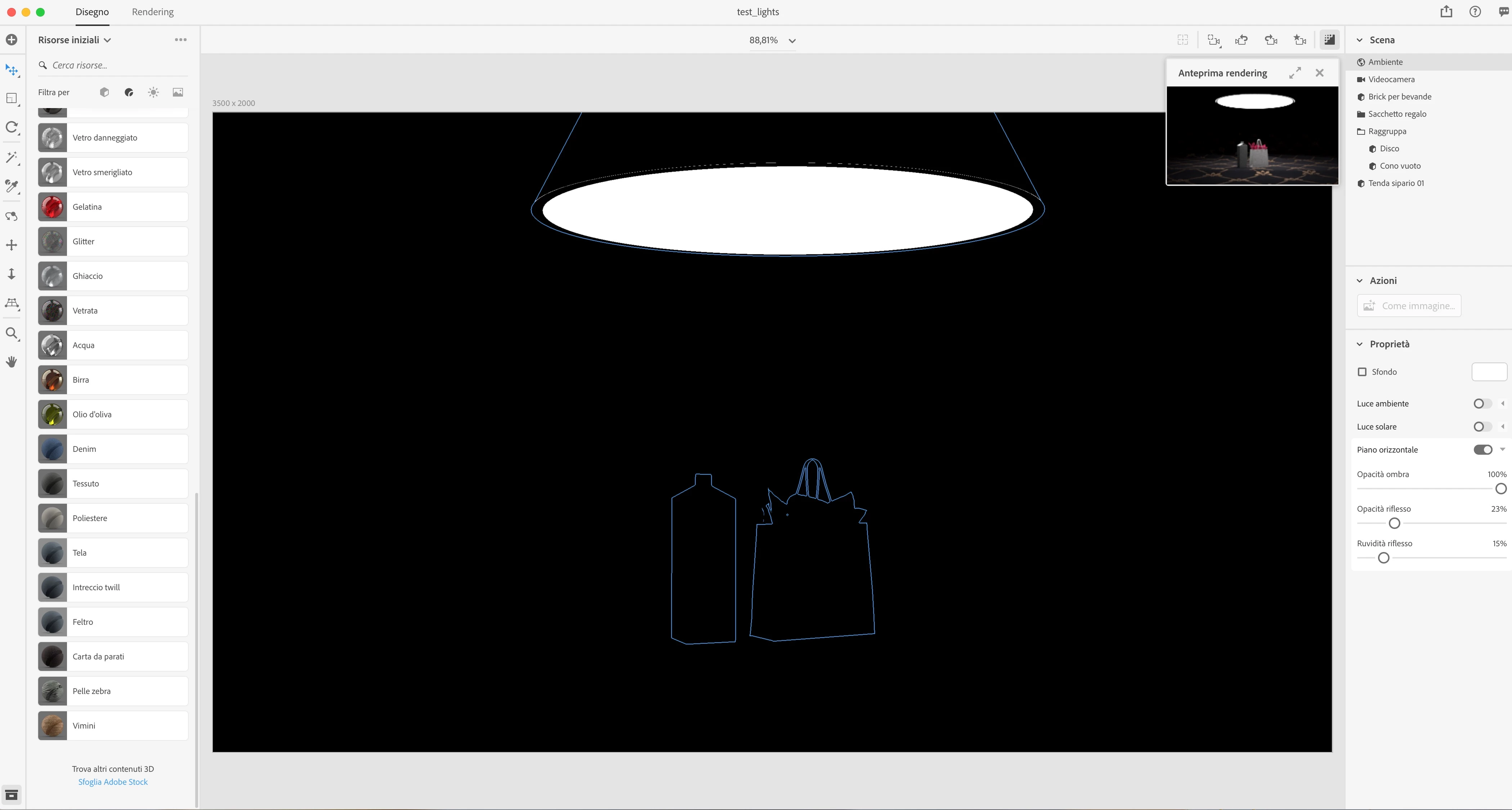

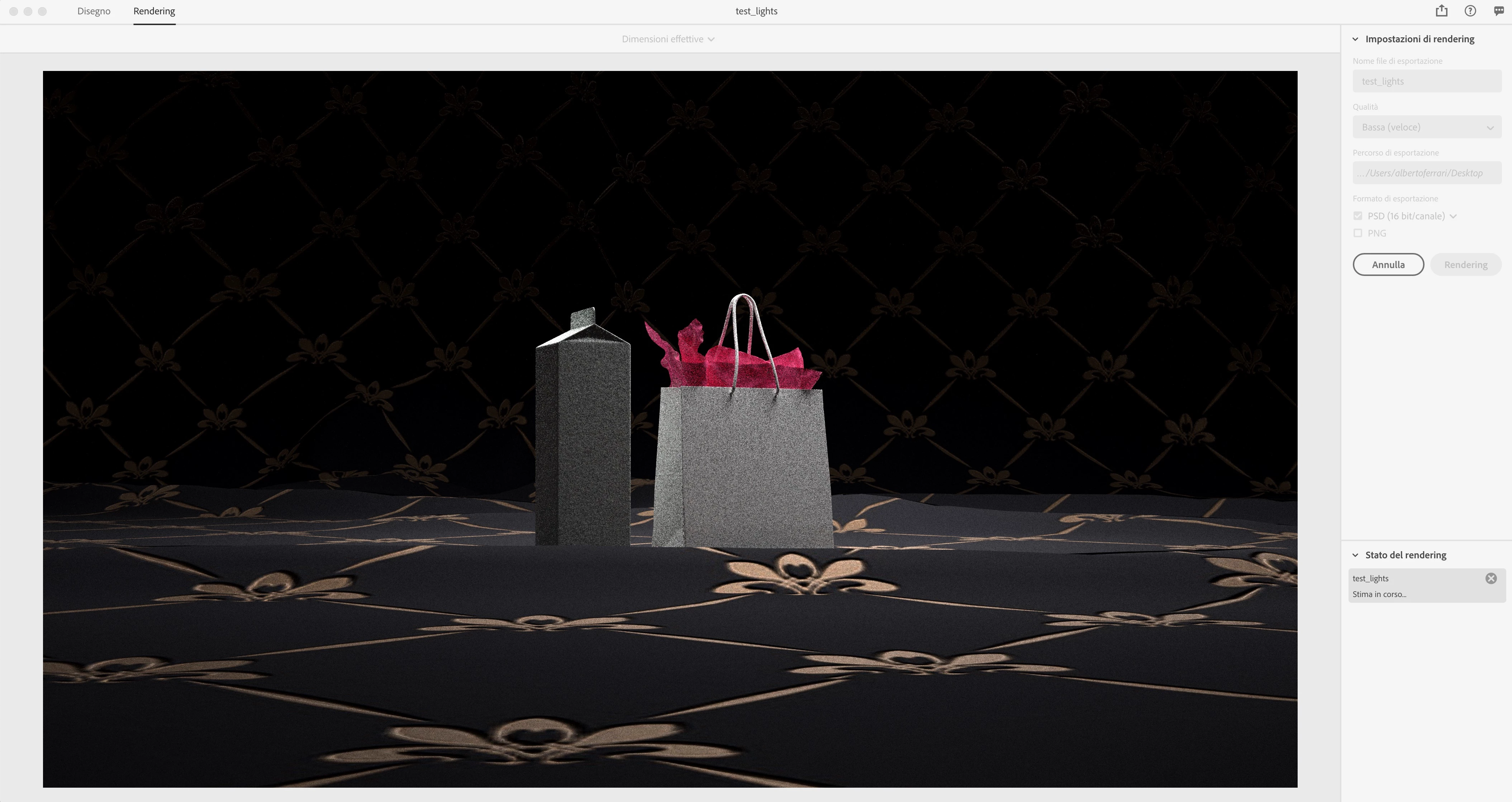

    Mar 29, 2019 8:57 AM UTC

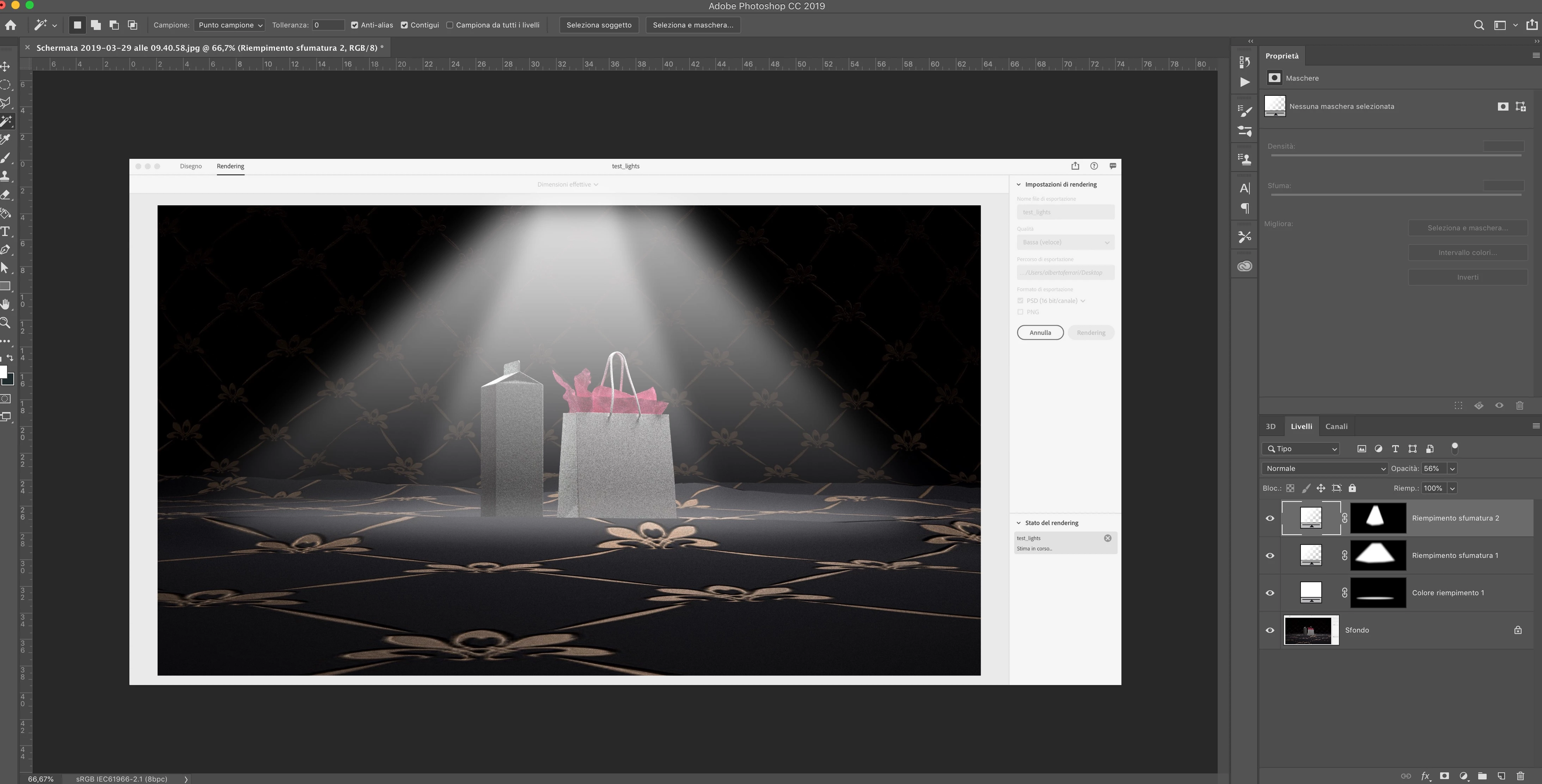

    Ok, first of all, thank you for your time.
    Let's say that is an "escamotage" to reach the goal...
    it's a fake light background, not physical 3d light and then, I must place the object where there is the light - bmp- in the background image).
    Basically to reach the goal you must have a background (not only the standard "horizontal plane") below the object that covers the background (I could build a "limbo" in 3d that covers the infinite background area).
    Maybe the best way (in my opinion), is to render the object with the light (cone and disc with glow) and after add some cone gradients in Photoshop..
    Thank you again
    Regards
    Alberto

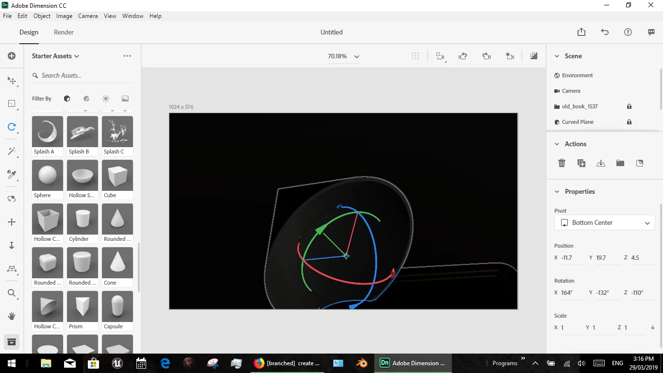

    Ussnorway7605025

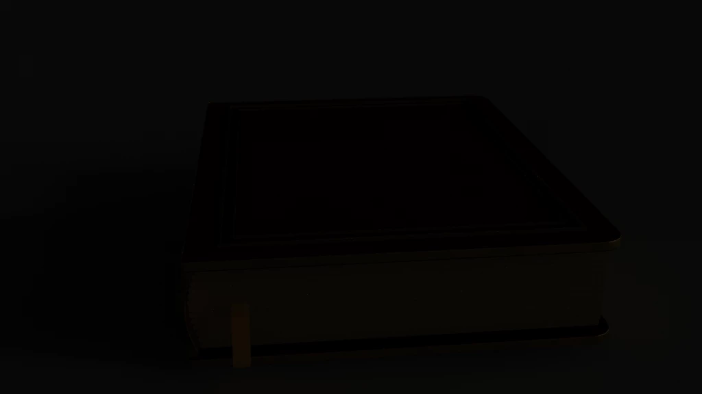

    Mar 29, 2019 7:31 AM UTC

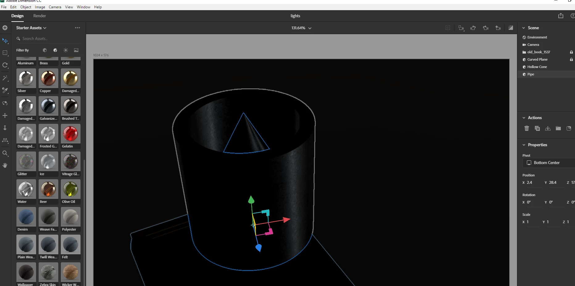

    Glow lights
    building it from basic parts
    imo only good for mood shots with suttle lighting

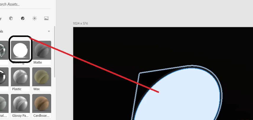

    Mar 28, 2019 12:41 AM UTC
    five_horizons  wrote
    My purpose is to create a dark scene and place a spotlight on an object.
    Supposing to do this turning-off the environment light, place a random object (cube, cone, plane, etc..) and assign to it some brightness.
    this is a job for enviroment light
    • you build your background image as having the light you want,
    • rendor the lighting then edit the light out of the background image
    eg, 3d link
    not brightness but glow
    you can use it to give a 'flute light' effect or to add pop to an object, these two (disc and splash) have 5% glow & the problem is the human brain looks at this effect and crys fake!
    glow = "light comes from inside" and thats why it looks fake to anyone that takes photos
    you must rendor glow to see the effect, cpu rendor is not going to show it
    you must have at least some transparenty in the object to see glow... think of it like putting a light inside a box, if the box is made of glass you see it and if its made of steel you will not

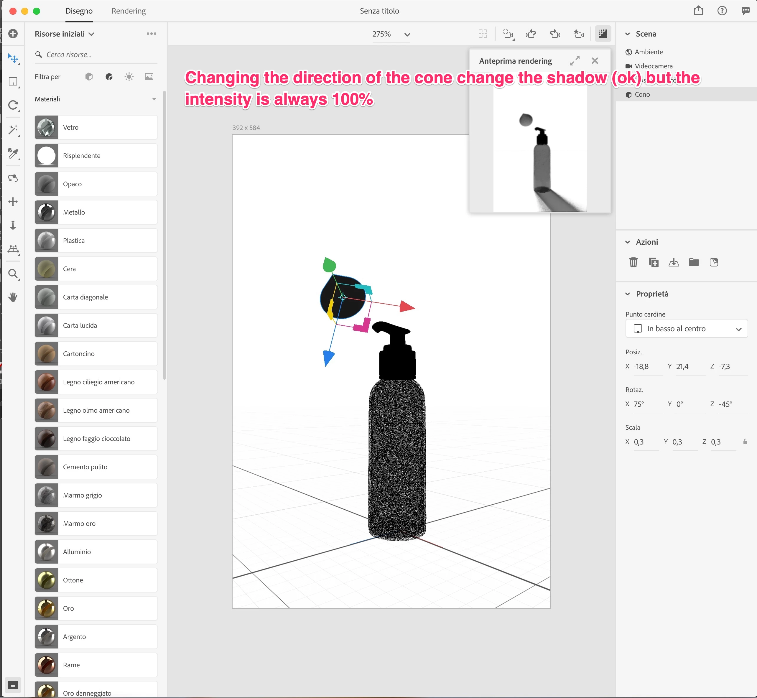

    Can you share image?

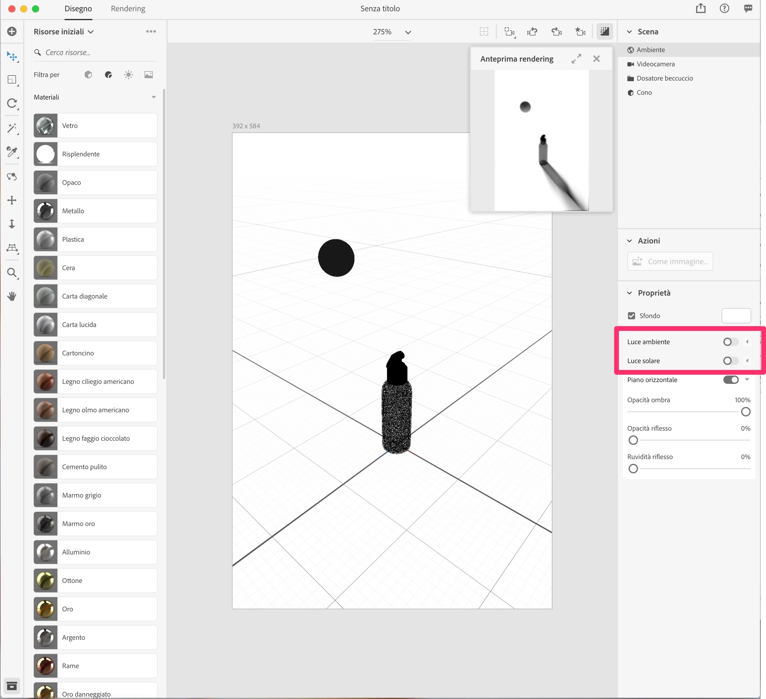

    Mar 27, 2019 2:58 PM UTC
    Ok, this is random fake example.
    1) 3d object placed above the subject and assignd "Brightness" = 1%
    2) moving the cone, the shadows of the subject change (OK)
    3) turned-off the environment light (no sun light too), but no spotlight from the cone, always full scene
