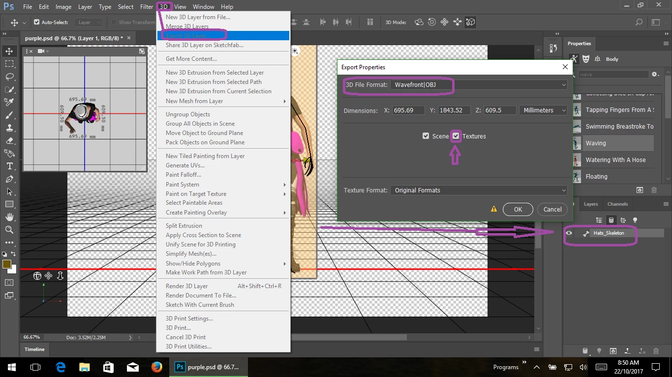

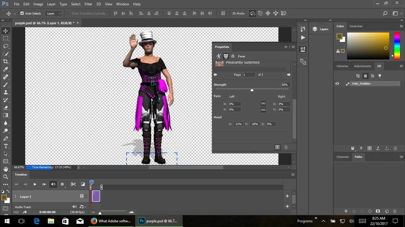

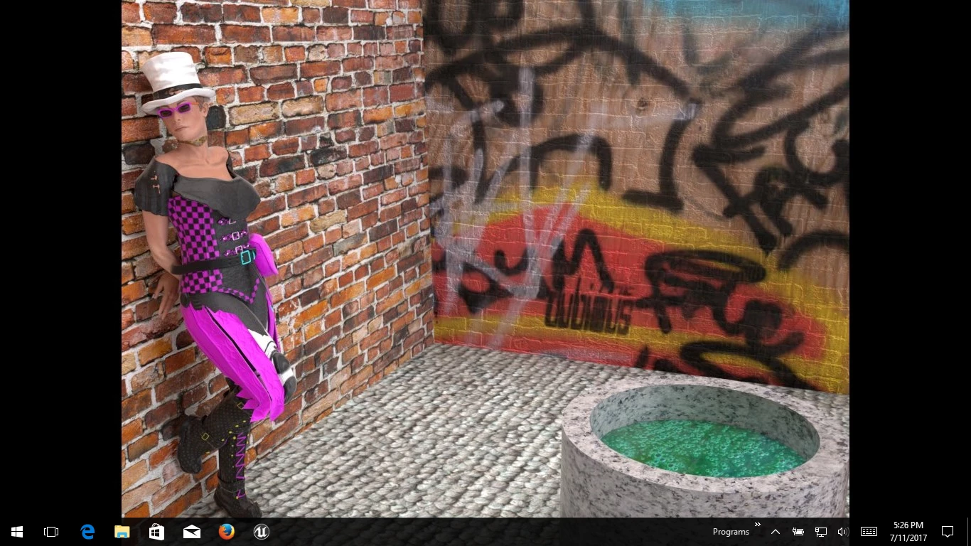

you can open Fuse made characters from your library into Photoshop only

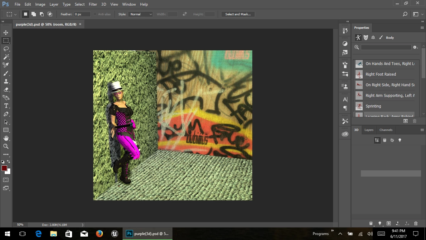

  • once in Photoshop you can set the pose you want
  • you can also add extra 3d parts to make a scene or just have the character
  • once you have the basic 3d model made in Photoshop you can then export the 3d layer as a WaveFront | OBJ... be sure to tick the box for textures and perhaps the scene option

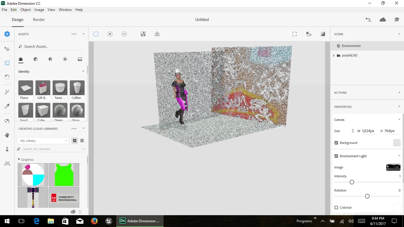

  • you now have a obj file that Dimension can open and perhaps edit

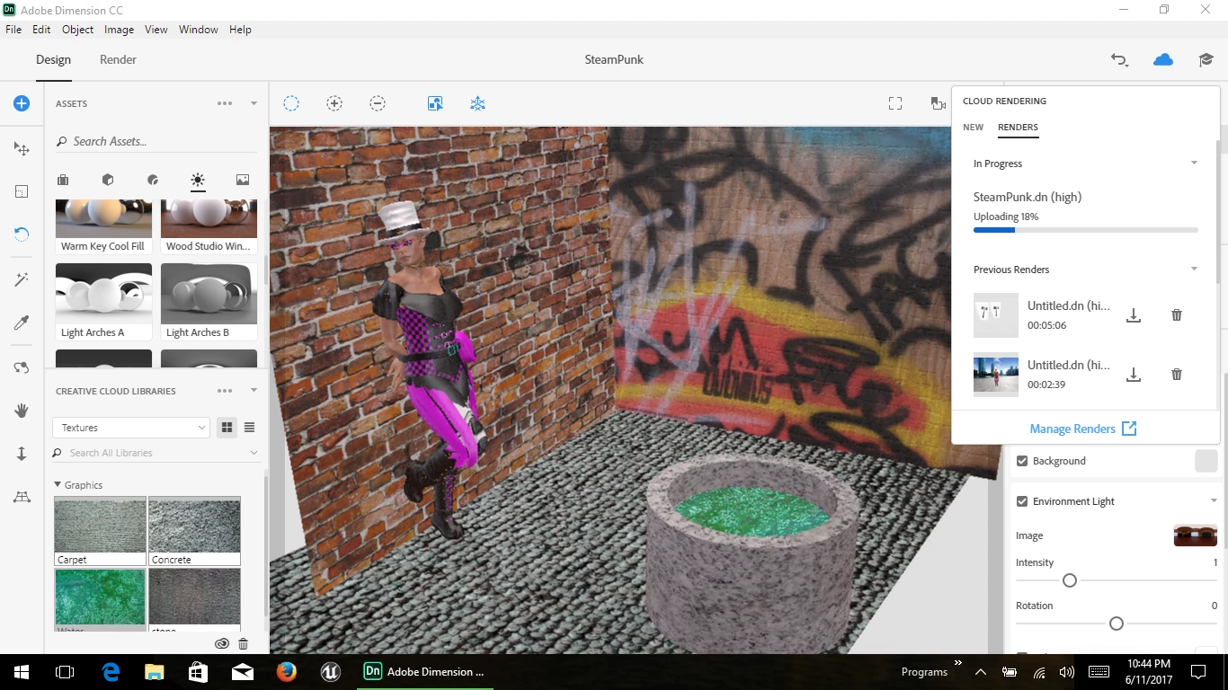

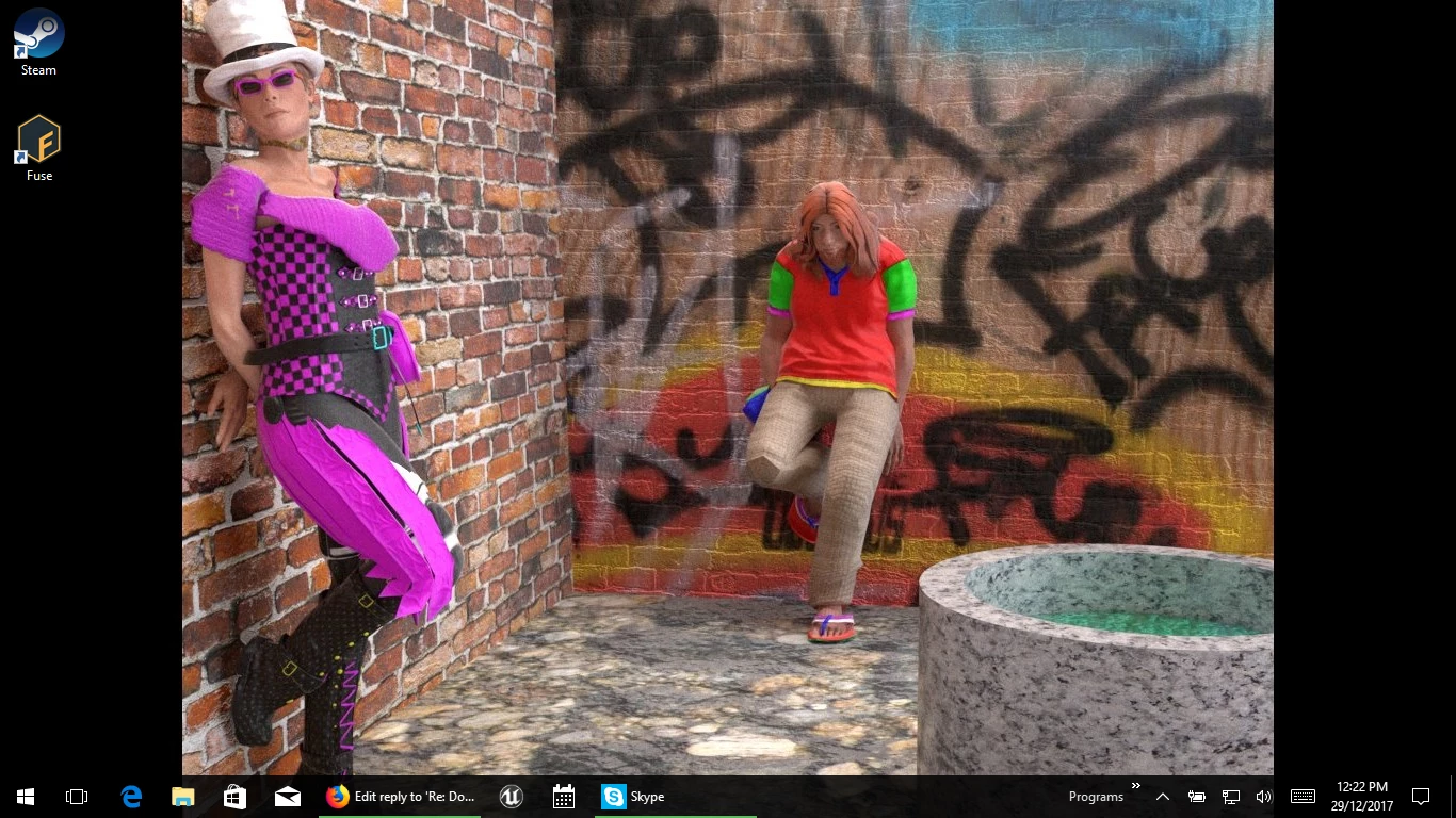

  • add extra textures or objects then rendor the scene
I change her outfit every few days but this is my desktop "steampunk"... have some fun with it
