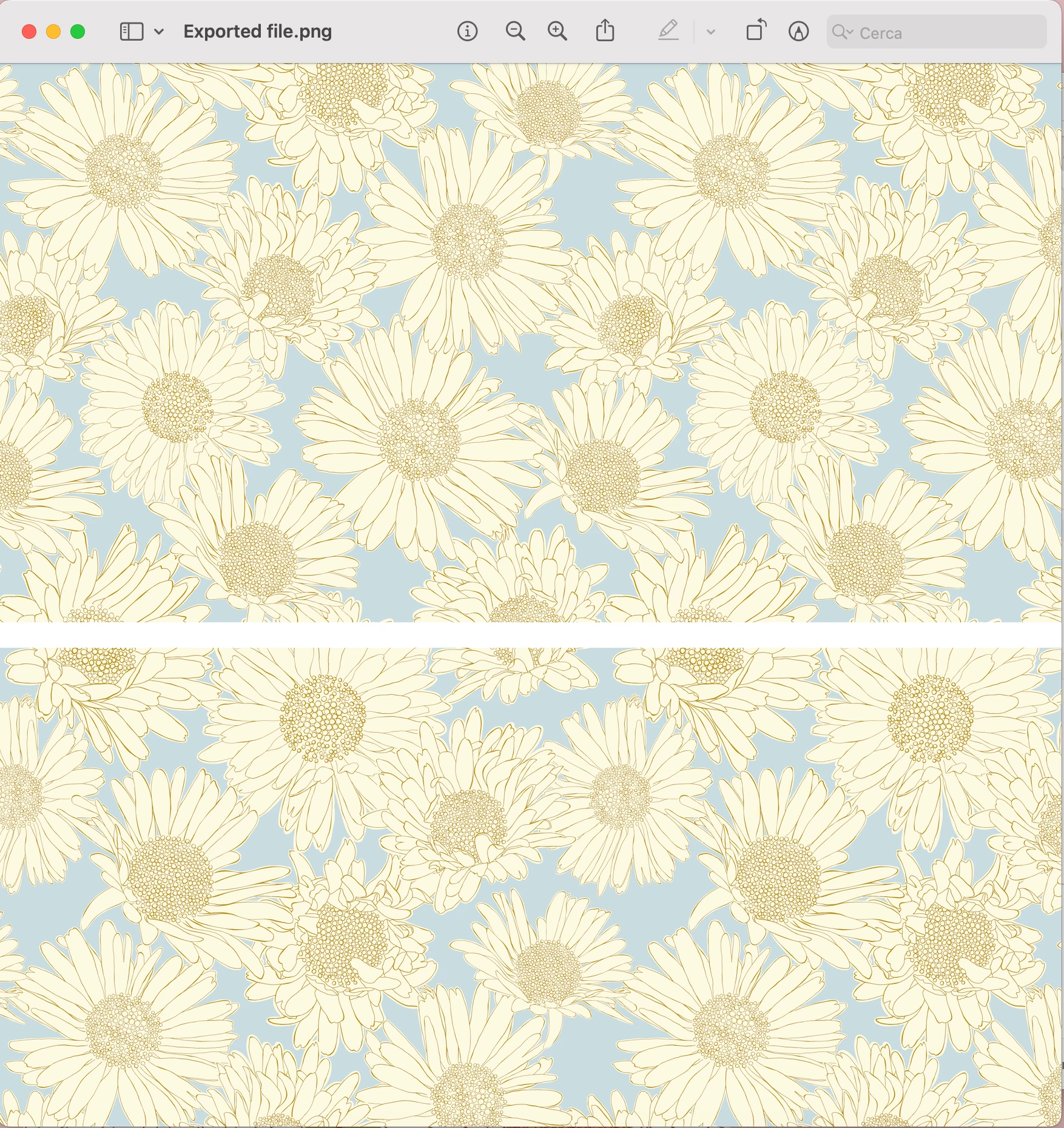

I hope you can help me out. I've never had any problems with Illustrator until now. I created a pattern, and now I need to export it to upload it to a print-on-demand website. Until now, I always exported a 5000x5000px PNG image, and everything went fine. But not today. When I tried to export the file, unfortunately, I ended up with an annoying rectangle in the middle of my image that, as you can see from the screenshot, is not present in the Illustrator file. I haven't changed anything in my export process or my export template. What can I do to solve this problem? I've already updated Illustrator to the latest version, restarted my Mac, created a new file with the necessary dimensions, and tried to bring the pattern back in. I've also checked the pattern file, but everything seems correct. Has this happened to anyone else? What can I do to solve this issue?

The exported file screenshot.

Are you trying to export a single pattern tile? And at what resolution or just a fixed 5000 px?
Edit: I saw the 300 dpi, that would result in a 1,21 gigabyte file.
Esse.Effe
Esse.Effe작성자
June 10, 2023
What I want to export is a rectangle with my pattern inside (I created the pattern tile in a separate file with all my color variations choices). Hope you better understand. The PNG file I exported (the correct one) is about 30MB. According to your calculations, it seems too light. Do you think there might be a problem?
Ton Frederiks
June 10, 2023
So what I understand your export is more meant to be a preview of your pattern than meant to be used in print production. Export at 72 ppi (or 1x) would be enough. But if you should not see the white stripe. Is is still there if you open the file in Photoshop instead of Preview?

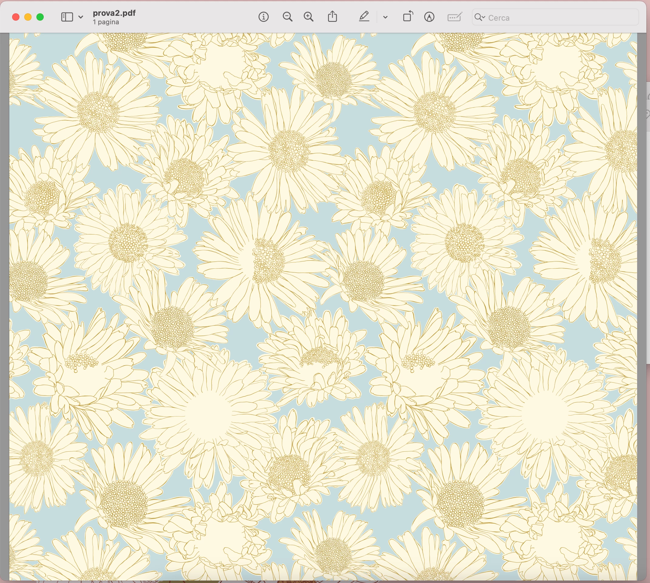

I also tried exporting the file in PDF format and here is the screenshot.
There seem to be some glitches/missing parts (the center of some flowers) when opening the file, but they disappear when zooming in. I also uploaded the PDF file to zazzle, and everything seems okay on the website.
