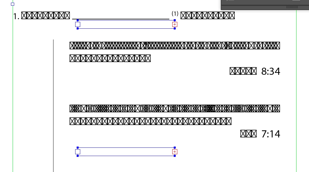

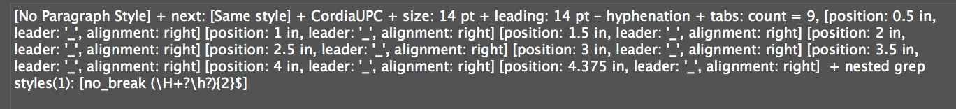

    The style is an override. The only thing there is a keep with next: 2
    But the problem is that it's based on body_text_01. Clearing the overrides goes to that style and the problem appears. I suspect the no_break grep style on the very long word when you change the size.
    Also, you have two frames with overrides, each with a single word.
    EDIT: the frames do not have overrides. They are overset.

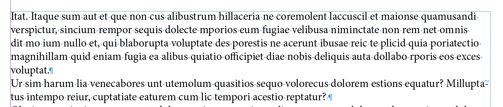

    The expression reads (\H+?\h?){2}$ and it is applying the no_break character style to keep the last two words of the paragraph together. When I add the same GREP style to a document with romance-language text, it works as expected.
    Before adding the GREP style:

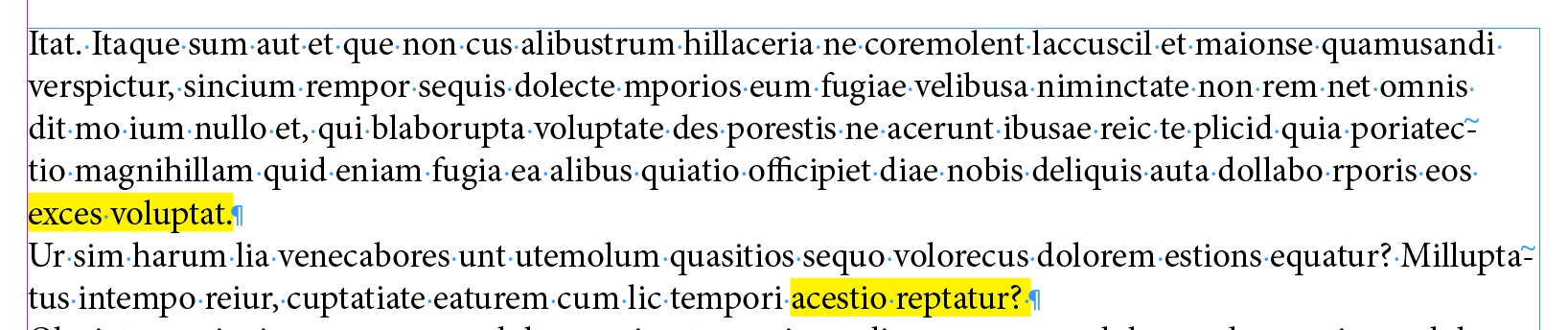

    After (I added a yellow highlight along with the no break attribute to the character style so that you can see it is assigned to the last two words of a paragraph.):
    Can you live without it? If not, we may need a GREP expert with ME experience to come up with another solution.

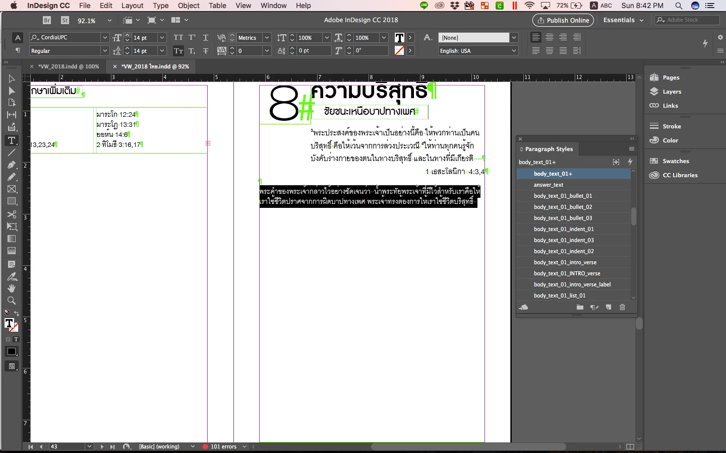

    Bill Silbert
    November 21, 2018
    Could you post a screen shot showing what is happening both before and after you change the text size? Also what version of InDesign and what operating system are you using?
    November 25, 2018

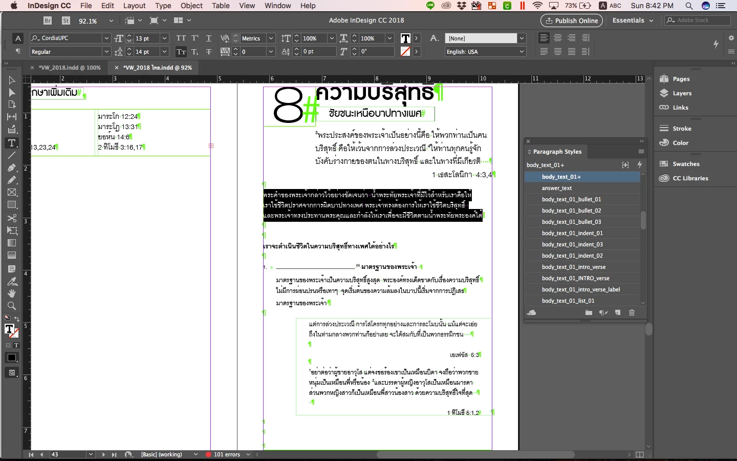

    This before
    This was after I changed the fonts size

    First, I'd still check out the two steps I outlined before. In your screen caps, neither show the text frame has been selected with the Arrow/Selection tool.
    I'm going to make the assumption that you've changed the size of a charcter/line in your copy block, either intentionally or inadvertently, or that you've made a change in the settings for the Keeps section, as I described.
    Please check those settings again and share what you find with us so we can help you.
