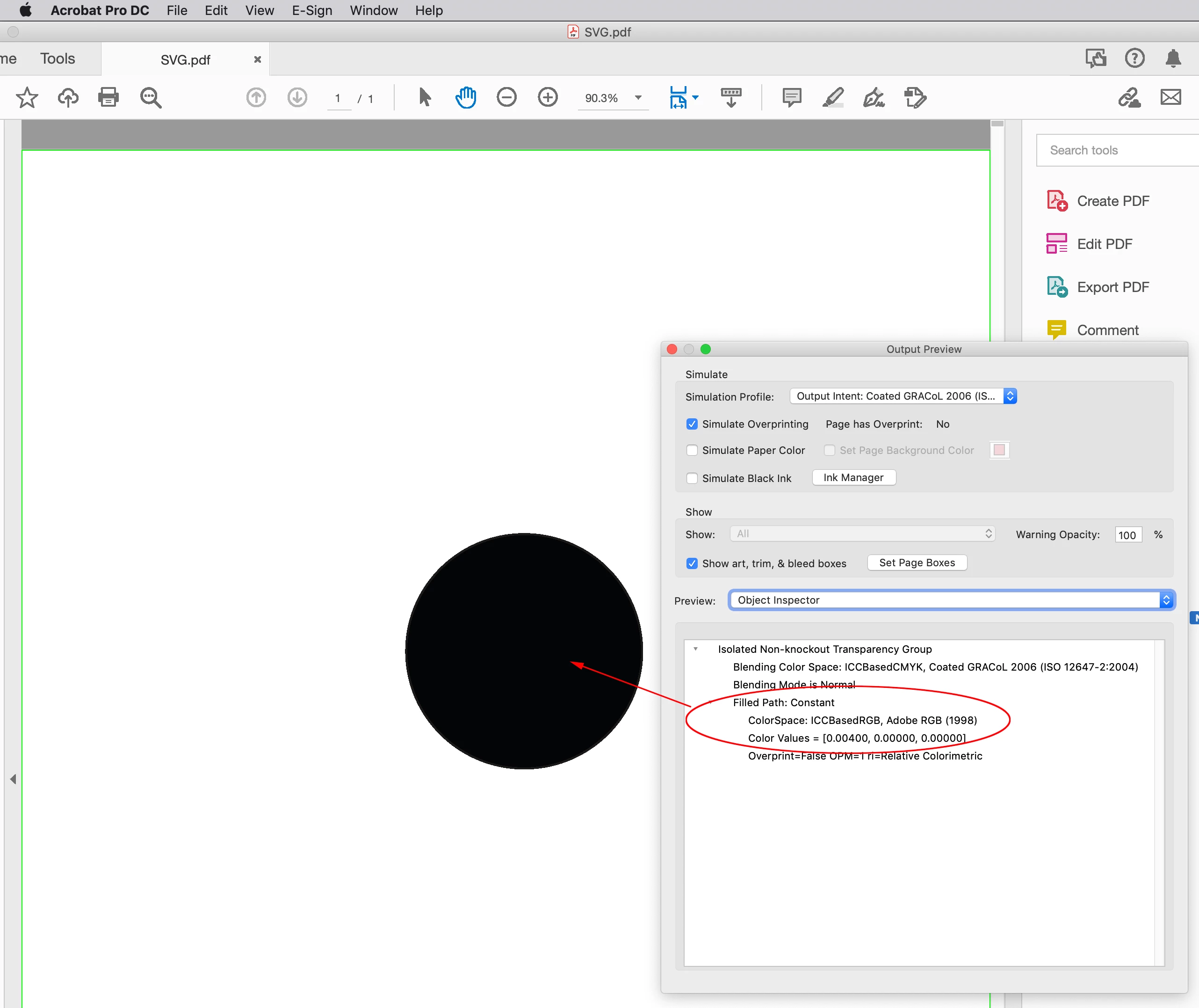

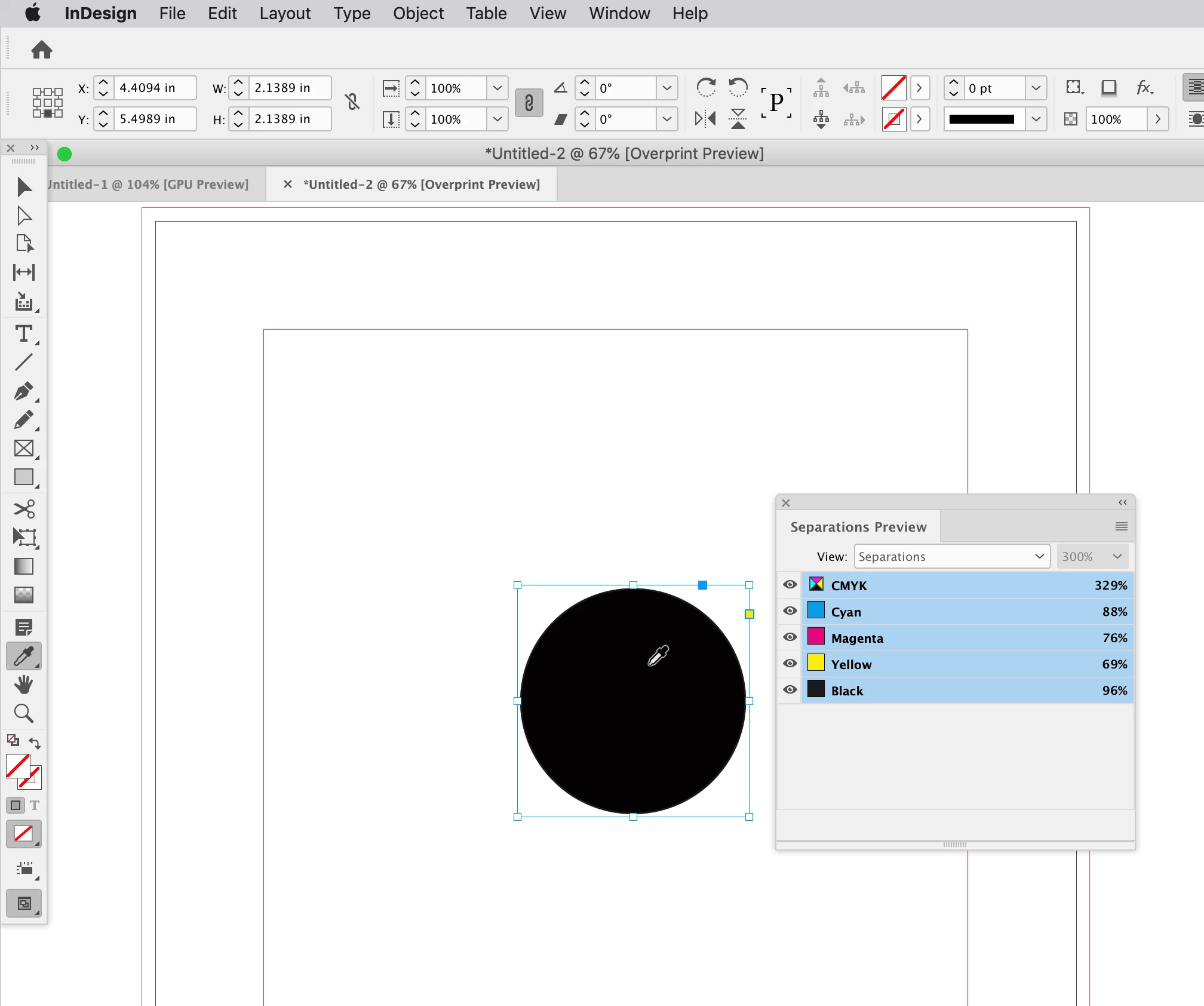

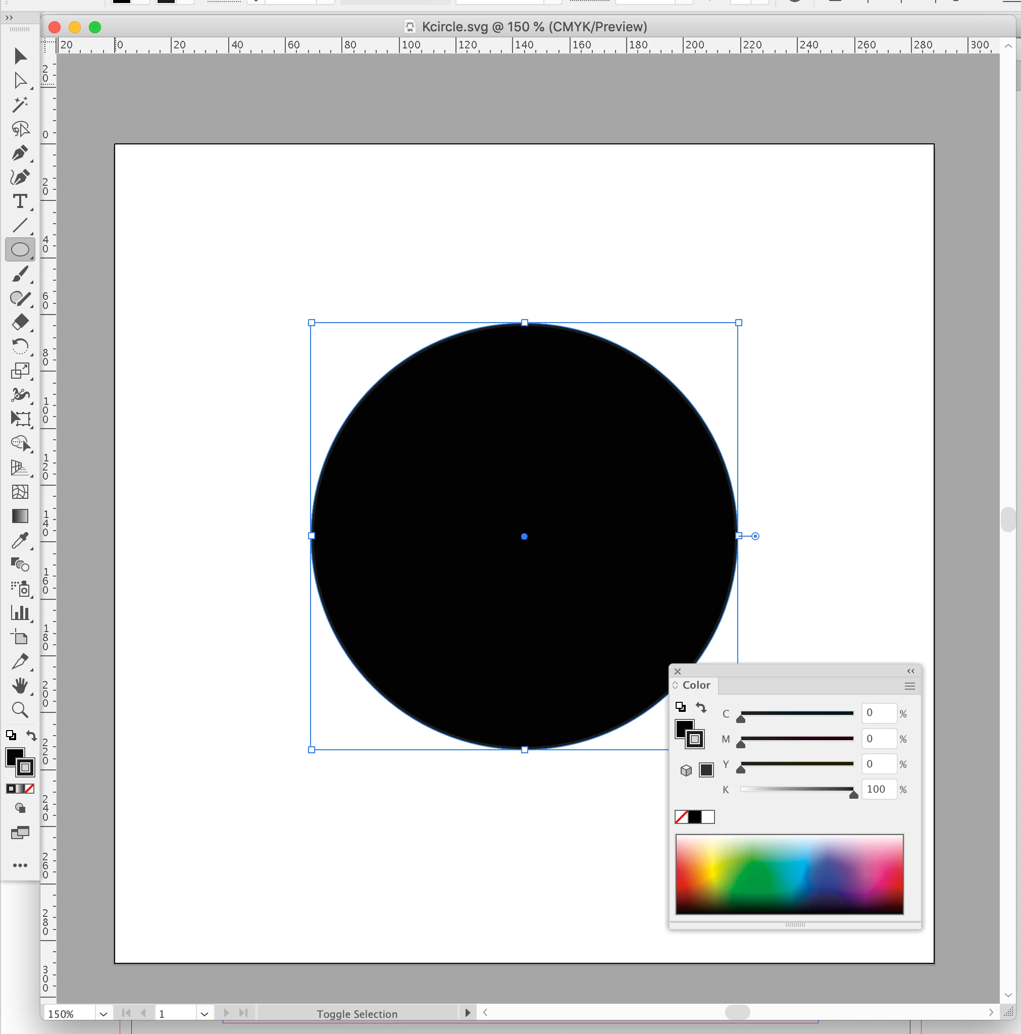

Hi Laura, As Uwe suggests you can save a CMYK mode Illustrator document as SVG but the color fills get converted to RGB on the save. SVGs also do not include color profiles, which could create additional color problems when they do have to be converted to CMYK. It might be worth placing your SVGs on an InDesign page, Export the page to PDF/X-4, and use Acrobat’s Output Preview>Object Inspector to inspect the SVG object.
Here’s what happens to a CMYK 0|0|0|100 fill:
Saved SVG placed—InDesign’s Separation Preview shows the black fill will convert into 4-color when the export or print is to Document CMYK:
The page exported to default PDF/X-4—No Color Conversion. Object Inspector shows the fill as RGB with the InDesign RGB profile embedded:
