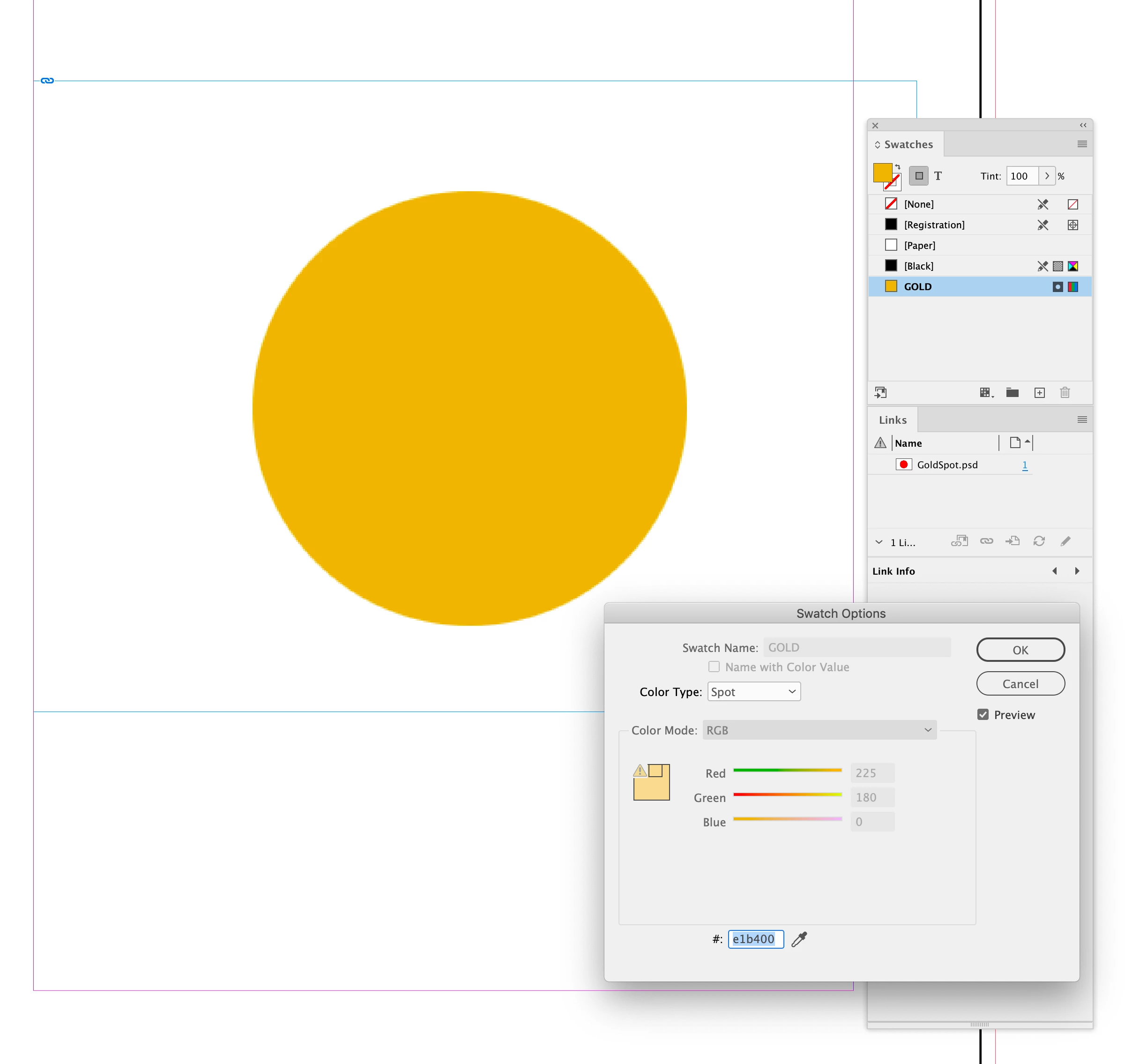

So I have something quite weird going on. I received an old in design file from the client. In the file, there is a link to file that contains a special spot, channel. Somehow, the previous designer managed to assign a specific swatch colour to that channel. And what happens now is that I cannot find, for the life of me, how to change the colour. I have searched dozens of articles, and I can't even find a single one that explains how you can even do that (assign a particular colour in InDesign to a colour channel). So I am stumped. Does anyone have any idea?
If I double-click on the swatch in the swatches panels, I see the following thing. As you can see, most options are just greyed out and there's nothing I can do to change it.

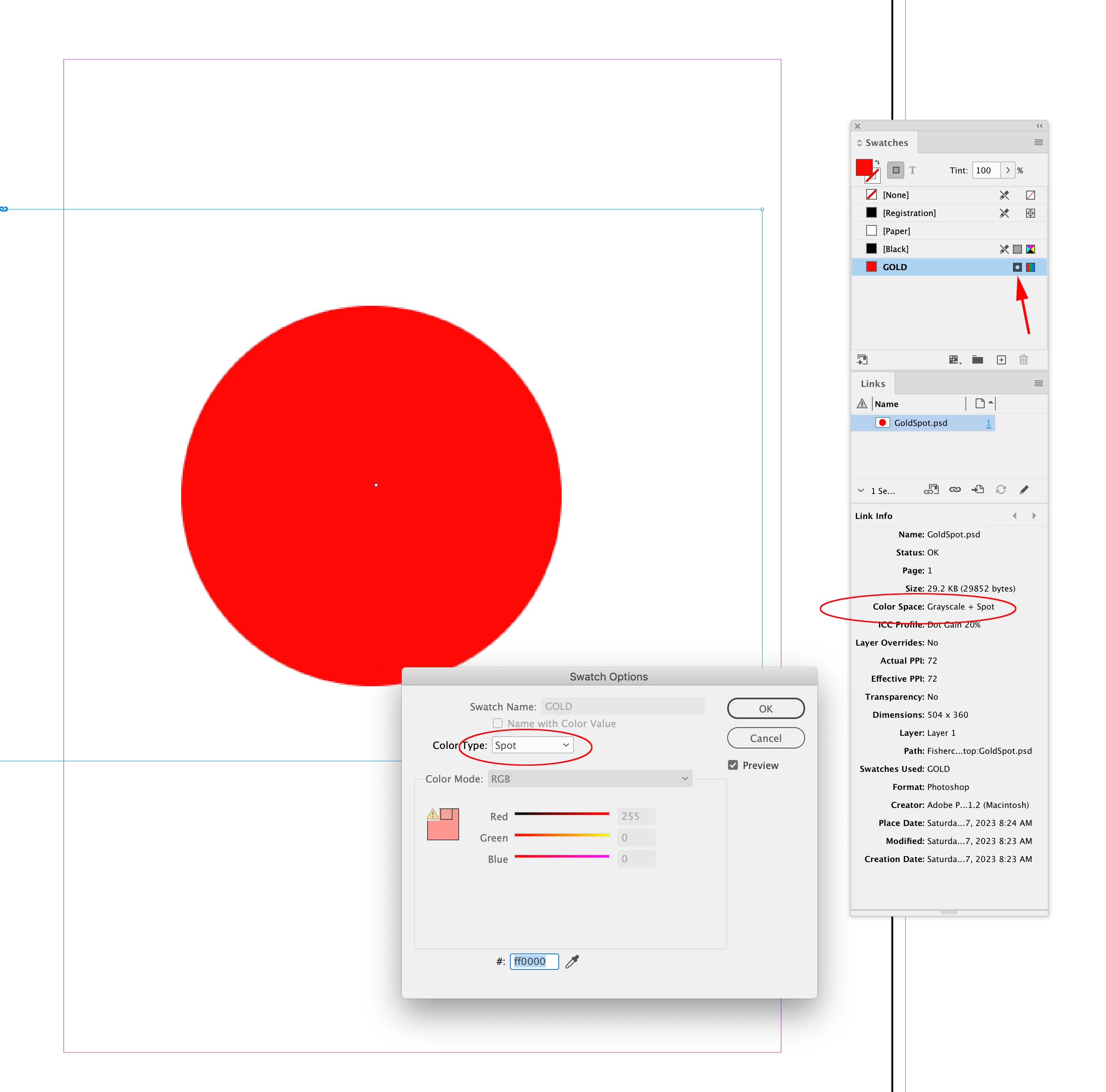

Hi @rafaëlt10669357 , When you place an object or image containing a Spot Color, the color is automatically added to your Swatches panel and the swatch is not editable as long as the placed file or files are in the document.
To change the Spot color definition you can either temporarily delete all instances of placed files containing the Spot color, which will allow you to edit the color. Once the color is edited you can Place the files again and the color appearance will use the new definition. Here I have Placed a Grayscale .PSD with a Spot Channel—note the Color Space in Link Info:

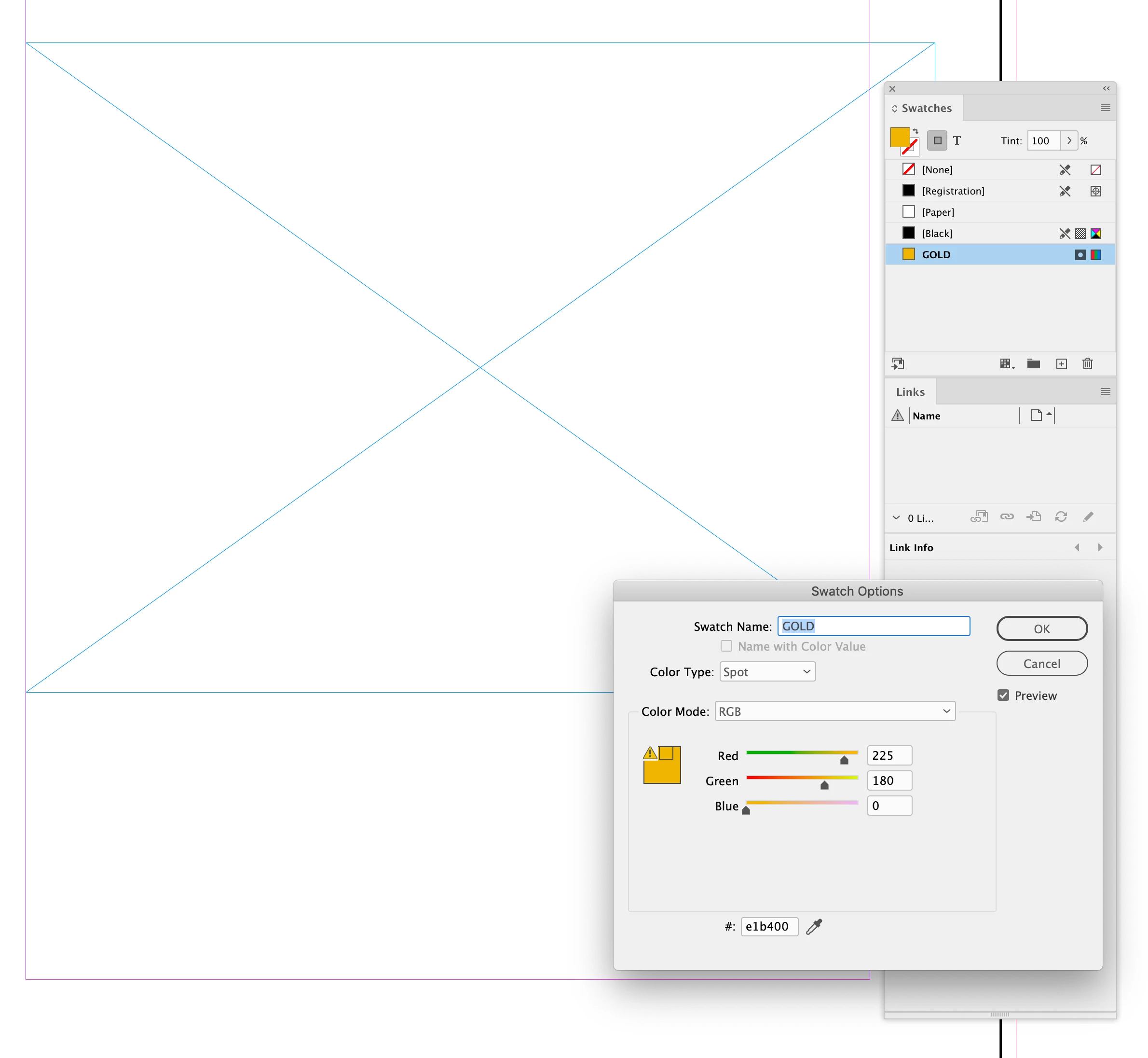

If I remove the placed .PSD the color is editable:

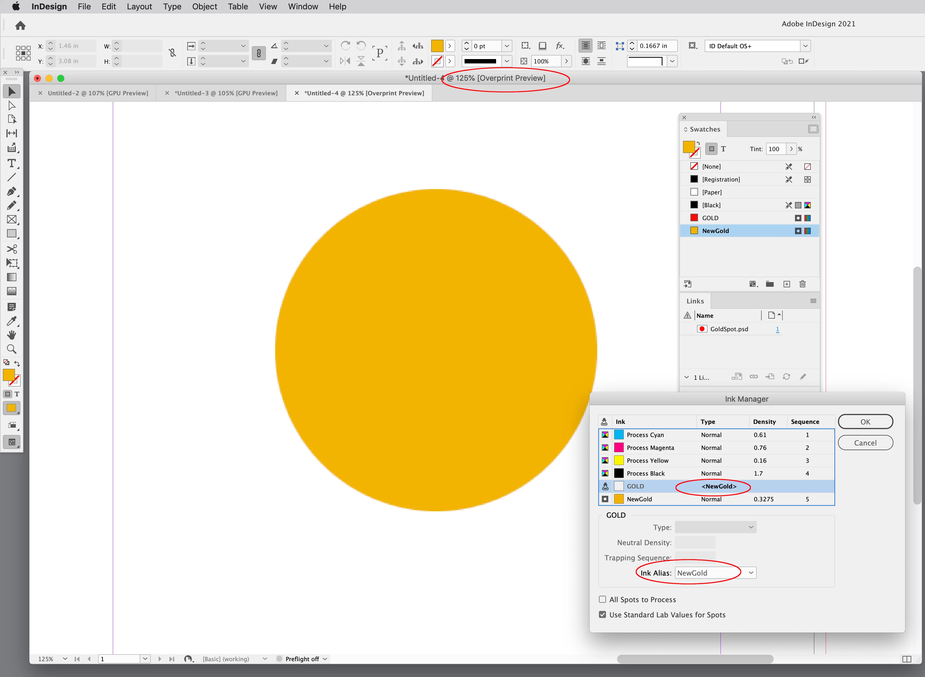

An alternative option is to setup a new Spot Color with the color definition you want and use Ink Manager to use the new color as an Alias. Note that you have to have Overprint Preview turned on to get the Alias color preview:

If you must change the colour you can create a new spot colour in InDesign (eg MyGold) and define it as you want it to appear, then use the Ink Manager to map your existing spot colour to alias, and then select the colour you have defined (MyGold)
