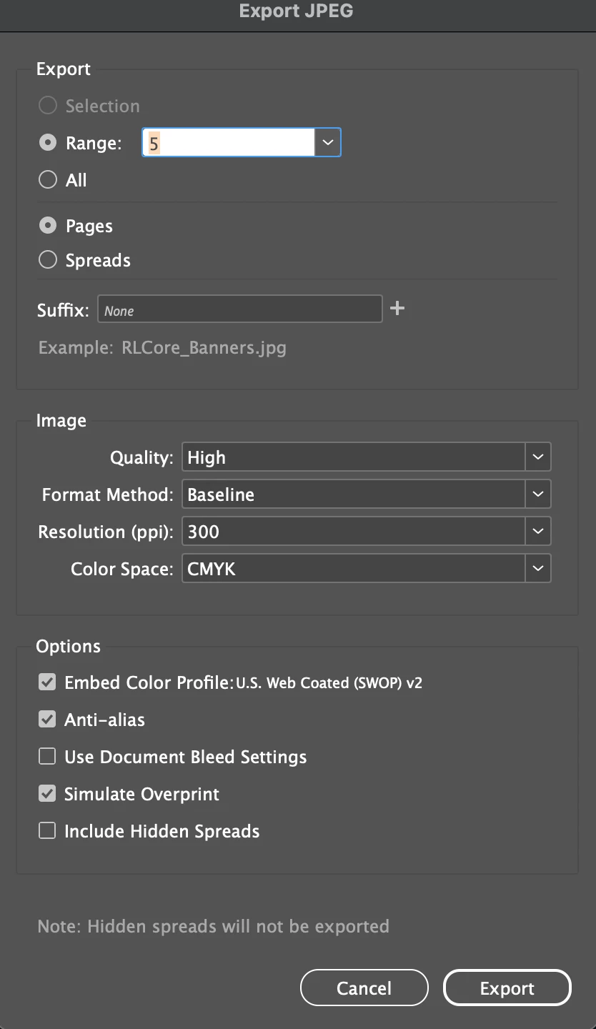

Hi @dekaaa , Is the final output going to be to a 4-color offset press running to the SWOP profile-- the profile showing in your JPEG export settings? If the output is not to an offset press why not stay in a profiled RGB space and let the conversion to the print space happen at output?

dekaaaAuthor
Nov 9, 2025 11:38 PM UTC
Here are my export jpeg settings (InDesign) - attached below.
I also did a test print and it didn't appear washed out which was good, but as expected there were also slight changes to the colour and how it looks on screen (which I am not too exactly worried about -- but if there is an answer to make it as close as it is, then I can try it on my end)
