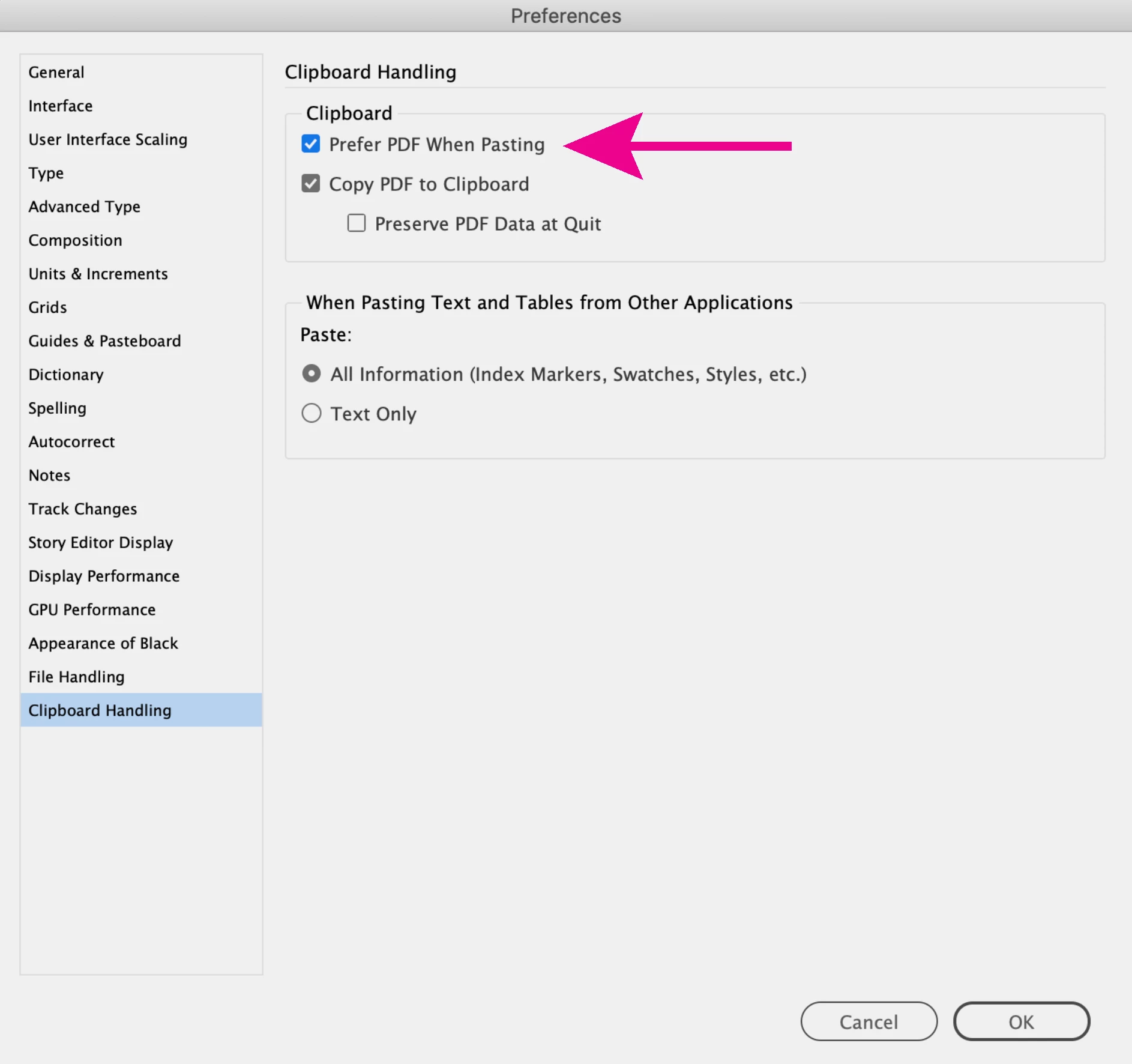

If you must copy n paste from AI to INDD (and you shouldn't):
Illustrator > Preferences > Clipboard Handling > Clipboard: AICB (Preserve Paths)
InDesign > Preferences > Clipboard Handling > Clipboard: Prefer PDF When Pasting is OFF
Make sure your Illustrator art is very simple. If complex or using fancy blends, save it as a .AI file and place it in InDesign.

You ABSOLUTELY can paste vector graphics from Illustrator into inDesign. It just gets strange here and there when trying to interpret merged VS non-merged elements, and will sometimes have a hiccup when it comes to pasting strokes (at least with CS6). And yes, after pasting into inDesign, they are still vector objects/strokes that have selectable/editable anchor points. They don't become rasterized/flattened graphics in inDesign after you paste them from Illustrator. If people are still running into the bounding box issue after pasting, try doing what Luke Jennings3 suggested, and check the box next to "Prefer .PDF When Pasting" within the Clip Board Handling options in the Preferences menu. I believe I had to do that a few years ago and it took care of the flat graphic problem for me.

Through trial and error, ticking the "Prefer .PDF When Pasting" box in the clipboard handling menu worked. It took several tries and I had to reboot my computer, but I am now able to copy-paste (basic) graphics without a hitch.

Thank you! It started working after I ticked that option - but only after rebooting my computer as well.

It's generally better to place your Illustrator art (.ai) into your InDesign page (File> Place), however there are occasions where you might need to edit a vector element within InDesign, where copy/paste would be the best option. Go to your InDesign preferences> Clipboard handling> Prefer PDF when Pasting, and turn this on, that might fix your issue.
May 2, 2022 11:52 AM UTC
Fantastic suggestion, this prefer pdf while pasting.  Worked for me. Thnks
