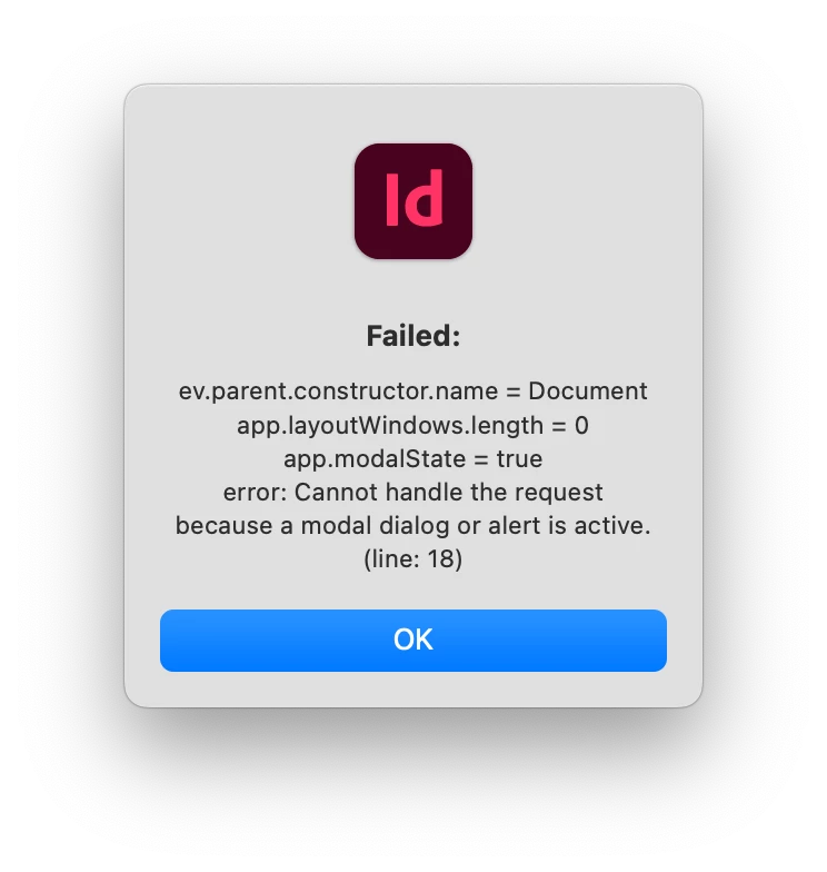

Hi all, I'm trying to run some ExtendScript code when the user creates a new document but I'm not getting it to work. I've probably made a basic mistake, which someone can point out, but otherwise, could anyone test my script on their system?
I expect it to name the first Layer "TEST" but for me it throws an error (which the script handles and displays in an alert).
I'm using Indesign 19.0.1 and MacOS 14.1.2.

This is what I see every time I create a new document:

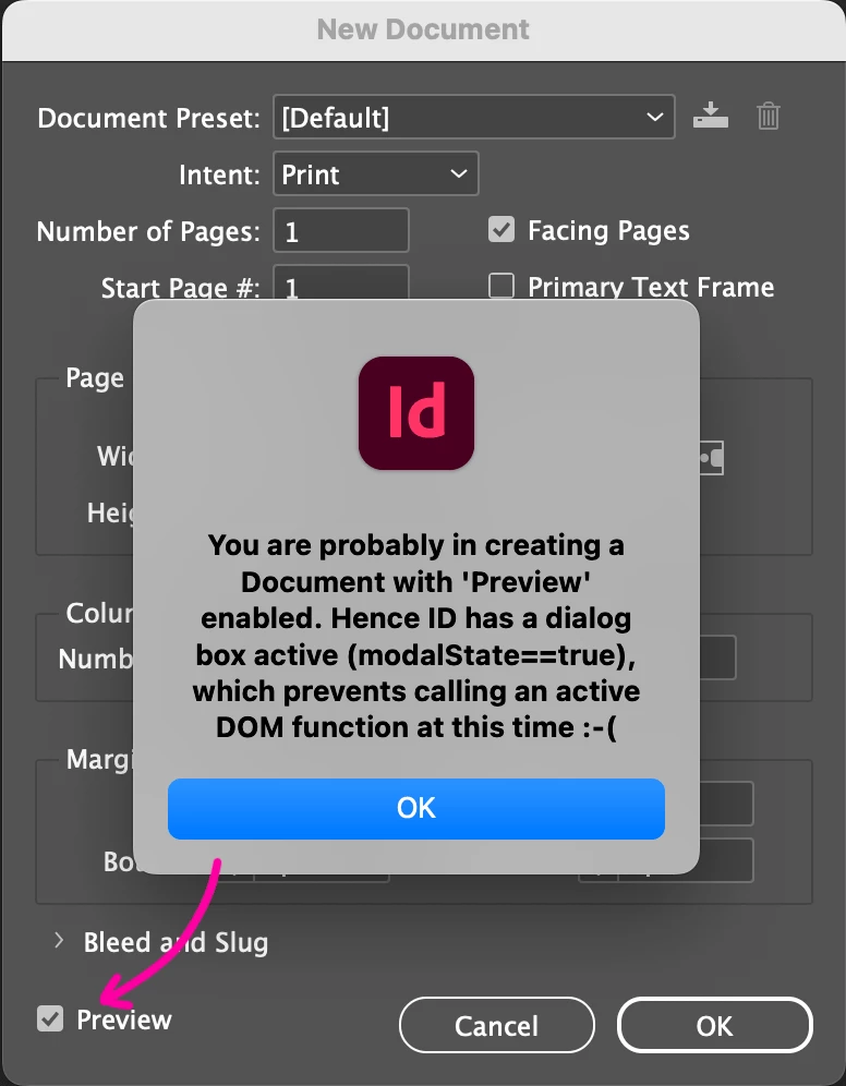

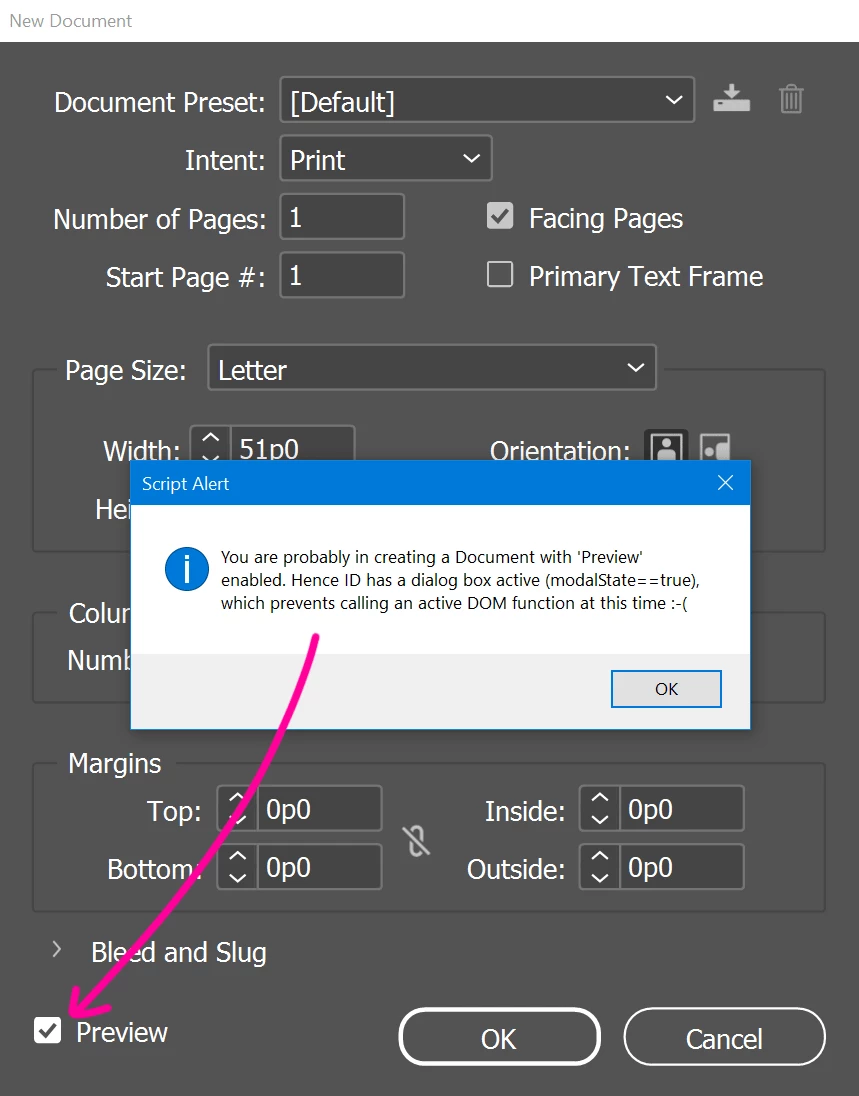

Hi Mark,
Since afterNew is triggered whenever a document is created, it can occur in various circumstances including when a modal dialog is active, due e.g. to the Preview checkbox of the New document dialog. (Maybe this also occurs under other conditions…)
The script below helps clarify this.

The crucial parameter is app.modalState. As expressed in the original error message you've encountered, you can't send an active DOM command when a modal window is active. That's is a golden rule of the scripting system. Depending on how the New document box is used, the app might be in “modal state” at the exact moment the document is generated. In particular, this happens when the Preview checkbox is turned on, making a document being created in the background (afterNew is fired then).
Apart from these situations, the script seems to work as expected in both macOS and Windows. The behavior of InDesign is consistent. I also observed that the document may be created (and the event notified) even before the "New document" dialog is opened, in which case it does not yet have an associated LayoutWindow. (But this is not an obstacle to renaming a layer)
Anyway, that background document remains an annoying problem when you want to achieve an afterNew handler that sends DOM commands. I haven't studied the issue further but I guess we may have to target another event…

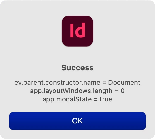

One strange thing: both myself and @sttk3 shows app.modalState == true even when the script succeeds without the modal dialog error. Edit: to report further, I had to remove the app.modalState == true conditional and code in your demo script or the test never succeeded (except in a single case of invoking the legacy New Document Dialog for which Preview checkbox was already checked—this is what you referred to: that the document is created before the modal dialog)

It always succeeds when in the legacy new document  dialog. New format new document dialog causes errors. Even when it succeeds, the modalState is true, and it seems to be executed before it finishes creating the document.

Yes @sttk3, this is the salient feature for me! I was using the "new" New Document Dialog. When I switch to the "legacy" New Document Dialog (which I now notice that @rob day is using) I get success like you did. Well that sheds some light on the problem. Thanks very much.

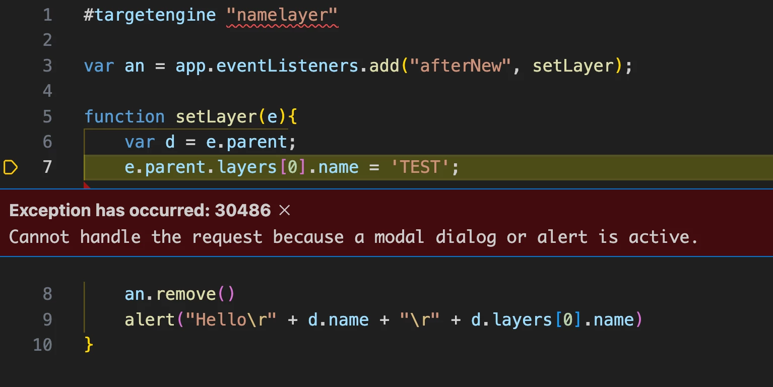

Hi Mark, I haven‘t had a chance to test your code, but this works for me with CC2021 on Mojave directly from VSC:
#targetengine "namelayer"
var an = app.eventListeners.add("afterNew", setLayer);
function setLayer(e){
    var d = e.parent;
    e.parent.layers[0].name = 'TEST';
    an.remove()
    alert("Hello\r" + d.name + "\r" + d.layers[0].name)
Others have suggested that you don’t need a #targetengine line, but I always include one when using event listeners—not sure if that might be your problem?

Thanks for the test @rob day. Here's what I get, from VSCode:
Oh well. I'm hoping someone will be able to test using Indesign 19.0.1 and MacOS 14.1.2.
I still don't know if it's a new bug/incompatibility or something particular to my setup. Thanks for helping.
